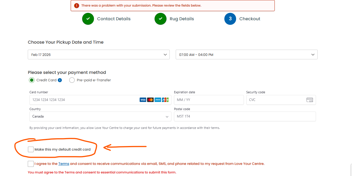

Form ID 56 contains a required checkbox field Field ID 258 on the final step.
When the checkbox is left unchecked and the form is submitted:
- With WPML String Translation plugin is ON - no validation error message is displayed.
- With WPML String Translation plugin is OFF - the required validation message appears correctly.
FYI, Form ID 56 is not translated at all

I duplicated the site and followed the troubleshooting steps suggested by the support team. During testing, I identified a specific conflict affecting the validation message display in Gravity Forms.
Issue Summary
In Form ID 56, a required checkbox field (Field ID 258 – “Make this my default credit card”) is located on the final step of a multi-step form.
When the Schedule Pickup button is clicked without selecting this checkbox, the validation behavior differs depending on plugin combinations:
Scenario 1
- Gravity Forms Partial Entries add-on - Active
- WPML String Translation - Active
Validation error message does NOT appear below Field 258.
Scenario 2
- Gravity Forms Partial Entries add-on - Inactive
Validation error message "Please Enter the credit card number and click this checbox" appears correctly below Field 258.
Scenario 3
- WPML String Translation - Inactive
Additional Observation
In Form ID 73, the validation error message displays correctly even when both the Partial Entries add-on and WPML String Translation are active.
This appears to be because Partial Entries is not enabled for Form 73, whereas Form 56 has Partial Entries enabled in its settings.
