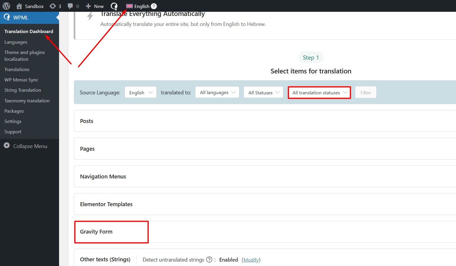

Problem: If you're trying to translate a Gravity Forms form and have installed the Gravity Forms Multilingual but cannot see the 'Gravity Forms' tab under WPML → Translation Dashboard.
Solution: We recommend you follow these steps:
1. Navigate to WPML >> Translation Dashboard.
2. Click on the “Clear Filters” link.
This action should make the Gravity Forms tab visible on your WPML Translation Dashboard. Please check and confirm if this resolves your issue.

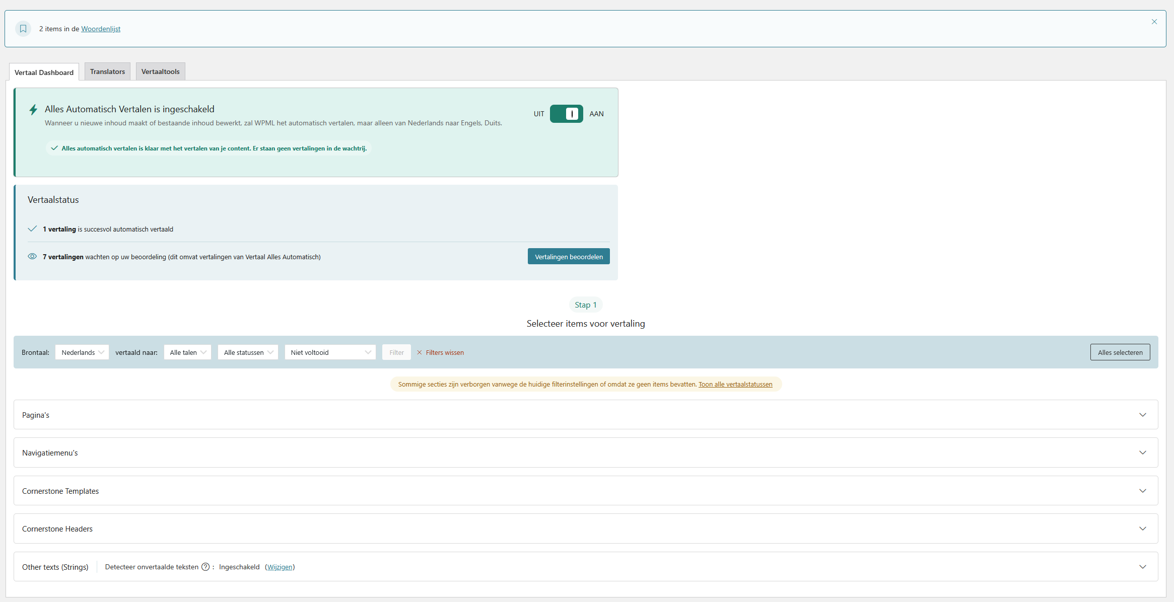

December 8, 2025 at 11:11 am #17643507
dennisH-9
this is my dashboard RN. Still no GF.
There's another support-ticket active where the support engineer is having access to my testing server. I think it's wise to not overwrite that one right now.

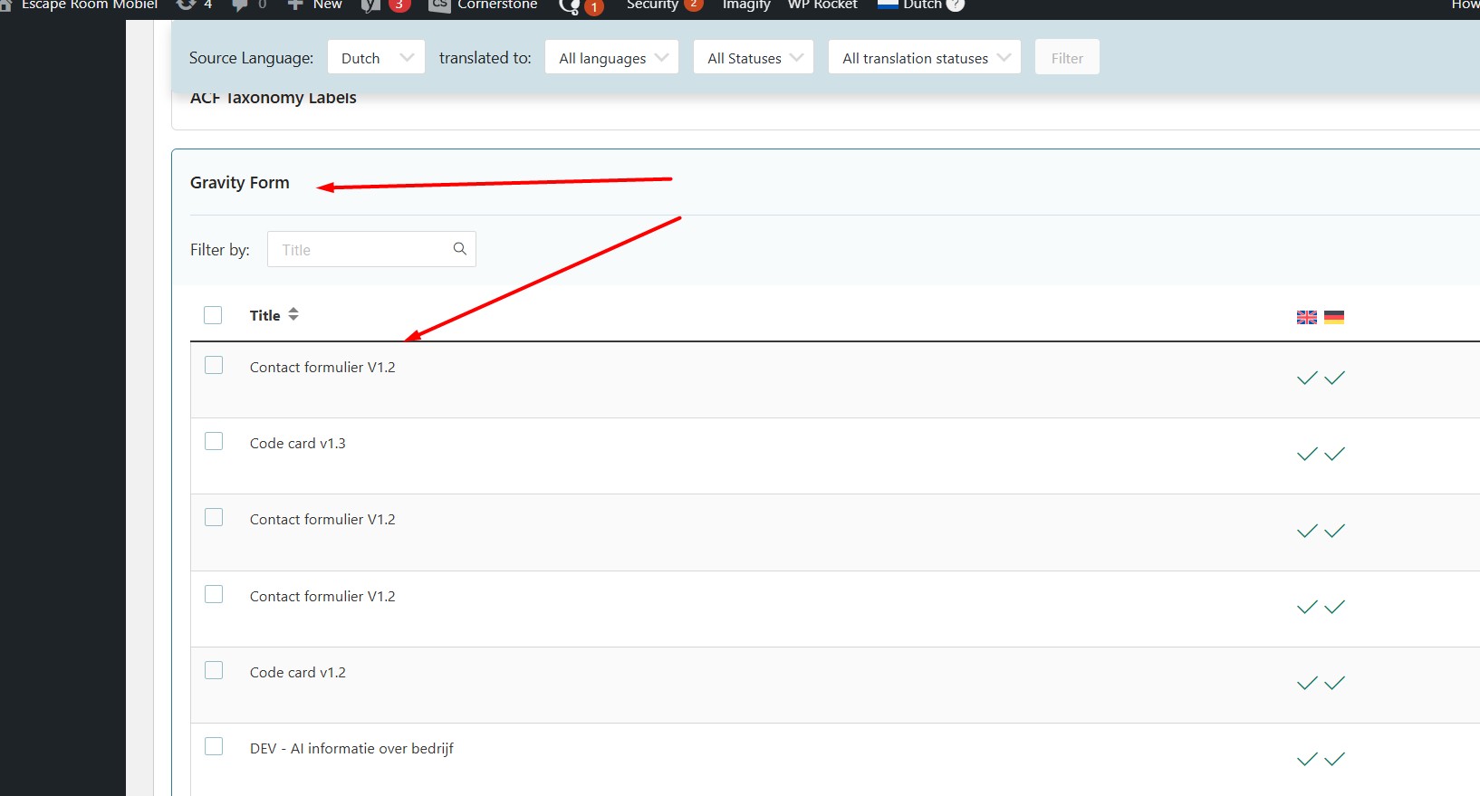

December 17, 2025 at 10:48 am #17670529
Noman
Thanks for providing the login details. I followed the below steps:
1. Went to WPML >> Translation Dashboard.
2. Click on the “Clear Filters” link as you can see in the attached screenshot.
And now Gravity forms are visible on WPML >> Translation dashboard. Could you please check and confirm?
December 18, 2025 at 8:02 pm #17676178
dennisH-9
Really that simple 😀 Thanks for looking into it!
