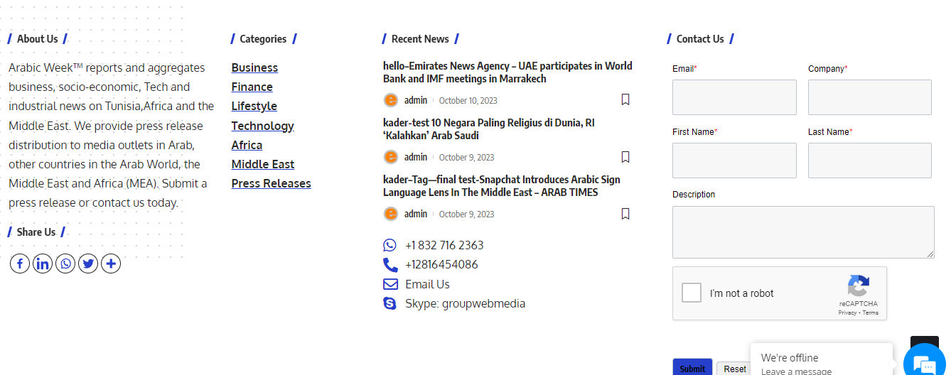

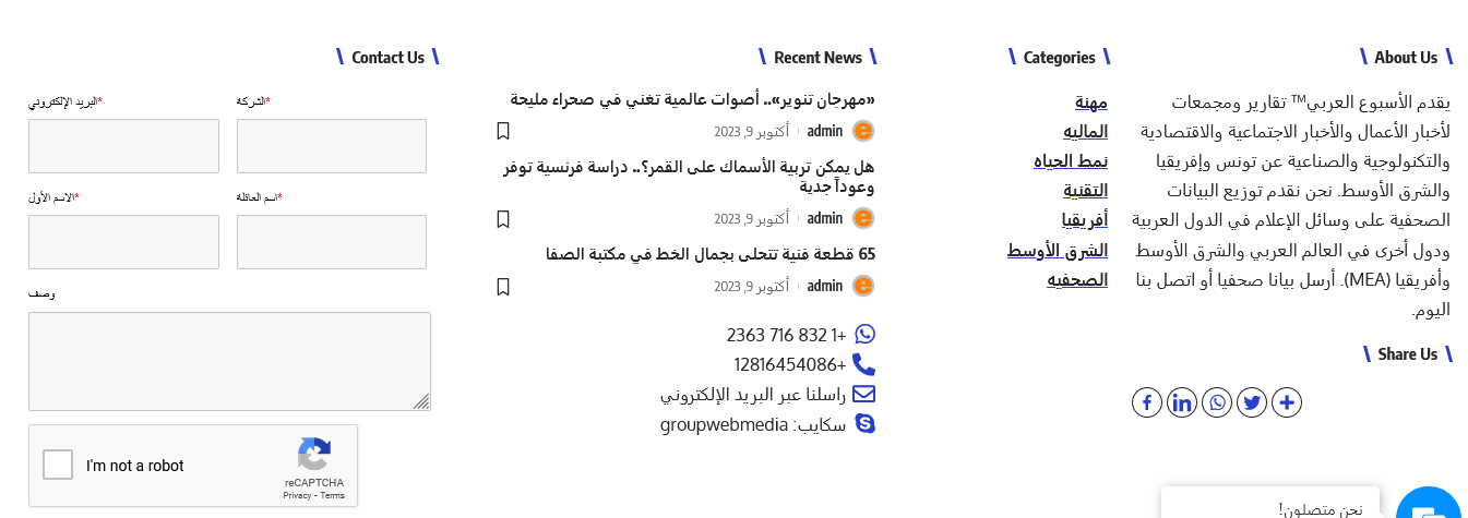

October 11, 2023 at 8:50 am #14556979
josephN-9

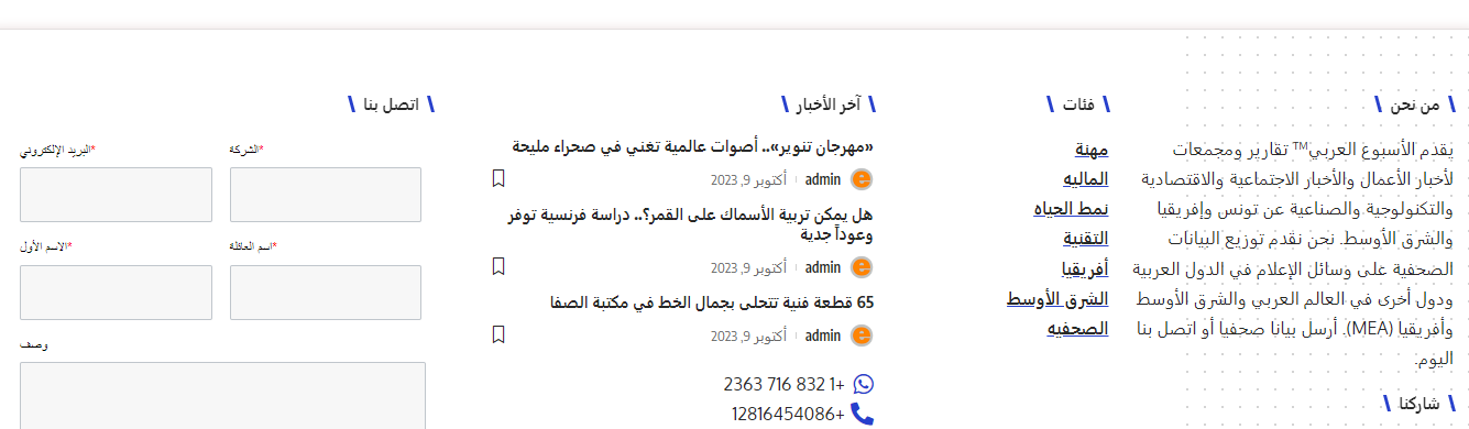

hi I am confused...
I have translated Global footer from wpml > translation
Then If I click on view from "Translation" page. it shows the text translated to arabic .
But in frontend when I switch to arabic then it shows the english text not arabic ...
Why it is ?
see screenshot(50).. it is not tranlated in frontend.
see screenshot(51).. it is tranlated to arabic when see from translation > view
why it is not translated to frontend ???

October 12, 2023 at 9:09 am #14564101
josephN-9
Is it fixed? you didn't update me yet...
October 12, 2023 at 10:43 am #14565217
Noman
WPML Supporter since 06/2016

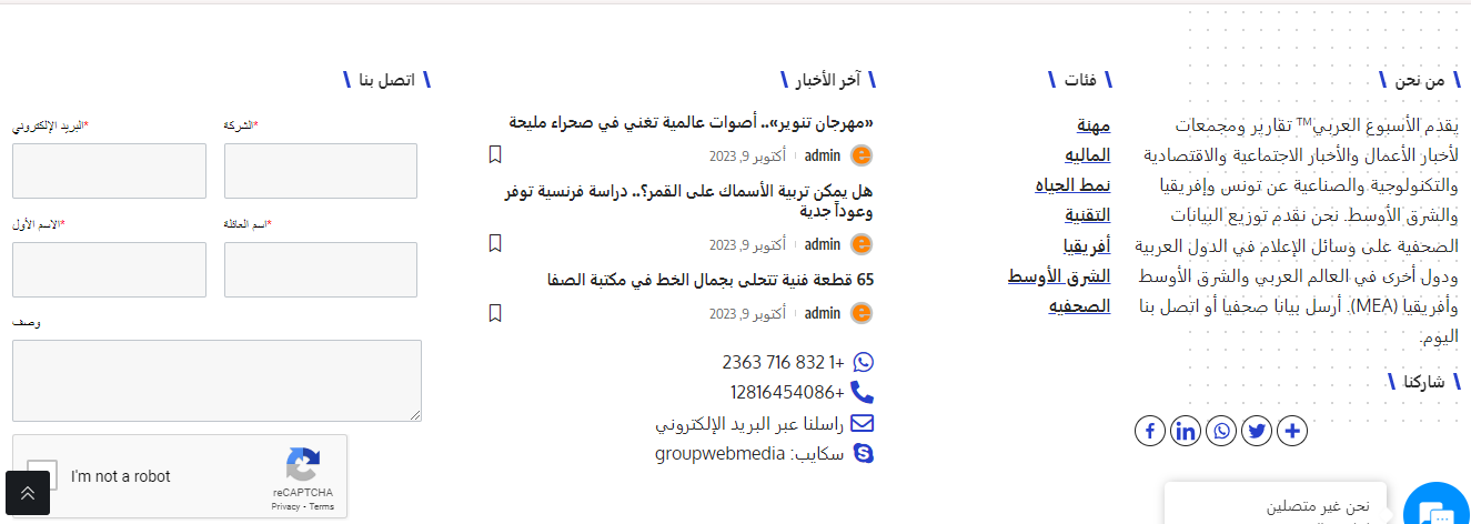

I was able to translate the Footer by following the below doc: https://wpml.org/documentation/getting-started-guide/string-translation/how-to-translate-theme-options/
But I have noticed that the custom Elementor heading element was not loading in WPML Translation Editor so I have added the below XML in WPML >> Settings > Custom XML Configuration section:
<wpml-config>
    <elementor-widgets>
        <widget name="foxes-heading">
            <fields>
                <field type="Heading" editor_type="LINE">title</field>
            </fields>
        </widget>
    </elementor-widgets>
</wpml-config>
And now it shows the correct translation, could you please check and confirm?

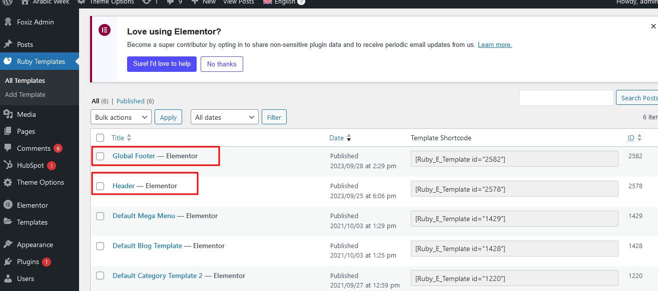

October 12, 2023 at 3:54 pm #14567519
josephN-9
Hi there, Whats wrong with it..
Same issue with header....
I have header from ruby template and I have translated but it doen't work in frontend..
Even I tried tried to search with template ID from wpml> string translation.
But I didn't find the ID belongs template.
why ?
October 12, 2023 at 4:02 pm #14567525
Noman
Can you please try to follow the below steps and see if this resolves your issue:
1. Go to WPML >> String Translation page and click on the Translate texts in admin screens » link at the bottom of the page.
2. Search for your default language header template ID in the search box and enable the translation.
3. Then go to WPML >> String Translation page and add the translate header template ID as translation.
Here is a doc for more details:
https://wpml.org/documentation/getting-started-guide/string-translation/finding-strings-that-dont-appear-on-the-string-translation-page/#translate-admin-and-settings-strings
Thank you

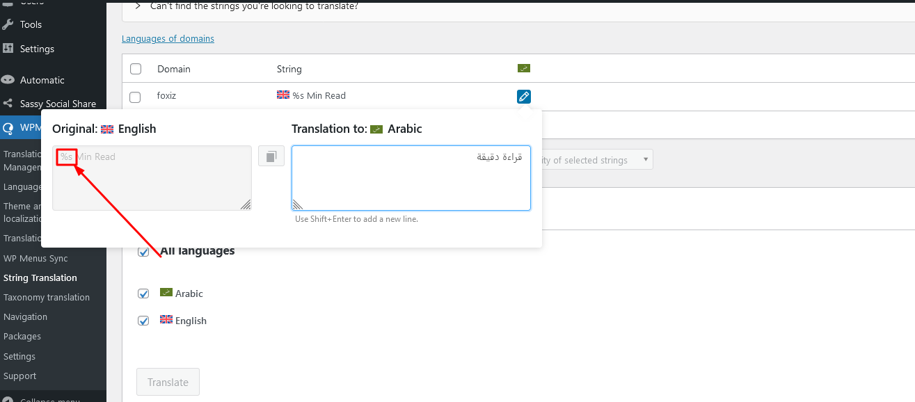

Can you help me with that(see attachment).
%s min read
%s it pass a dynamic value, if I translate "%s min read" = "translated text" then it doesn't show the dynamic value of %s
it shows only "translated text"
How to show %s value ?

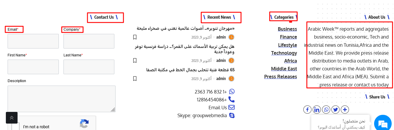

October 13, 2023 at 6:42 am #14569935
josephN-9
Hi... Still I have issue with "Global footer"..
Please navigate: Ruby template > Global footer
I have duplicate the footer for ENGLISH and ARABIC.
but when I switch to English it shows arabic text, why ?
it should show arabic when I will switch to arabic and English for English.
but it works properly when I view from Ruby Template page...
Please help above message issue and current one...

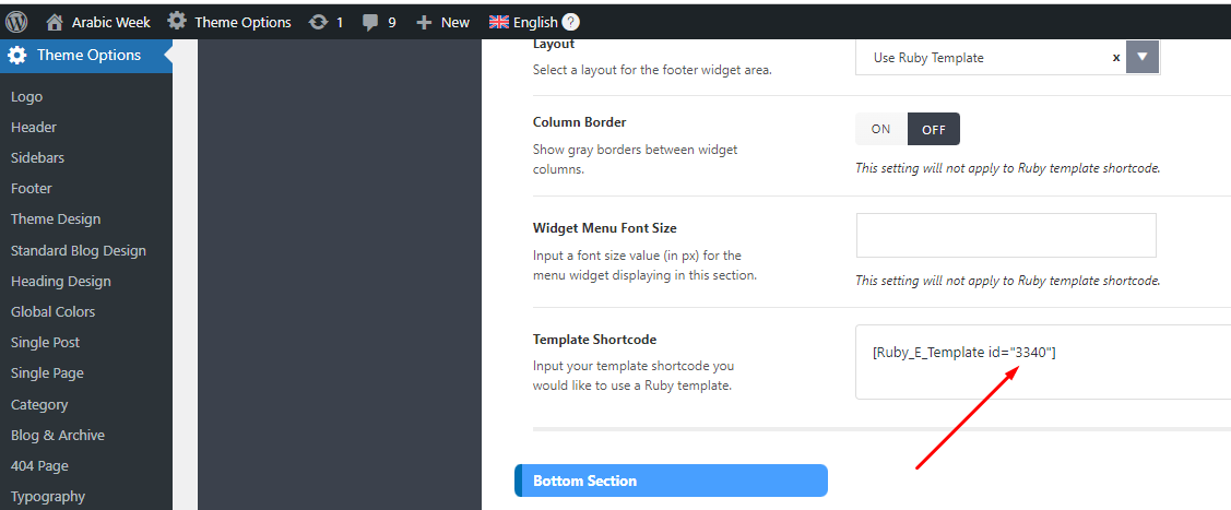

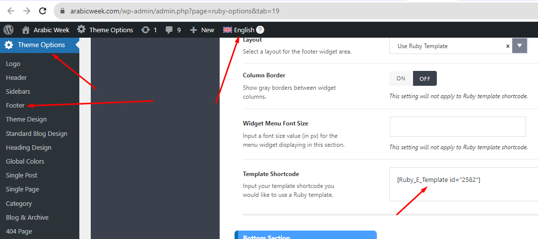

October 15, 2023 at 8:40 am #14578805
Noman

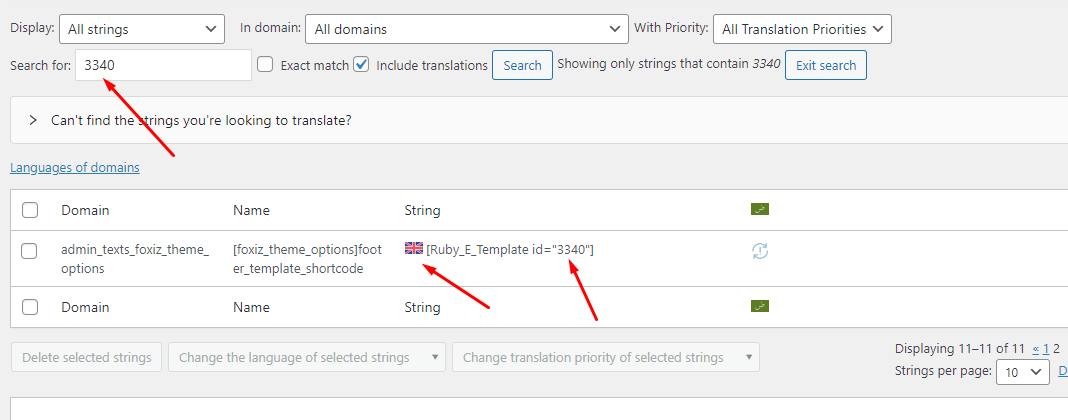

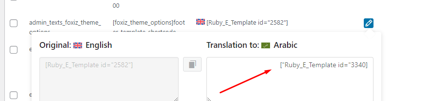

1. Regarding the footer translation problem:
- The ID for the English footer template is 2582, and for the Arabic footer, it's 3340.
- I checked the WPML >> String Translation page and found that the Arabic Footer ID had English assigned to it, as shown in the attached screenshot.
- This issue usually occurs when the Arabic footer shortcode is added from theme options, but the admin language switcher selects the English language, causing it to assign the English language to the Arabic footer shortcode. To prevent this in the future, please ensure that the admin language switcher has the English language selected and that the English language footer shortcode is added from theme options when you save the theme options, as shown in the attached screenshot. I have fixed it in a same way and it works correctly now.

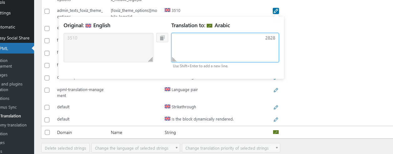

October 15, 2023 at 5:02 pm #14580209
josephN-9
Thanks it works...
I need to change mobile logo when it will be switch to ARabic...
The "mobile header" is totally coming from theme option.
as your doc:
My default logo id= 3510 (English)
Translated logo id = 2828 (ar)
I have translated it from String translation but it not works yet...
See attachment..
Can you check it out please ?
