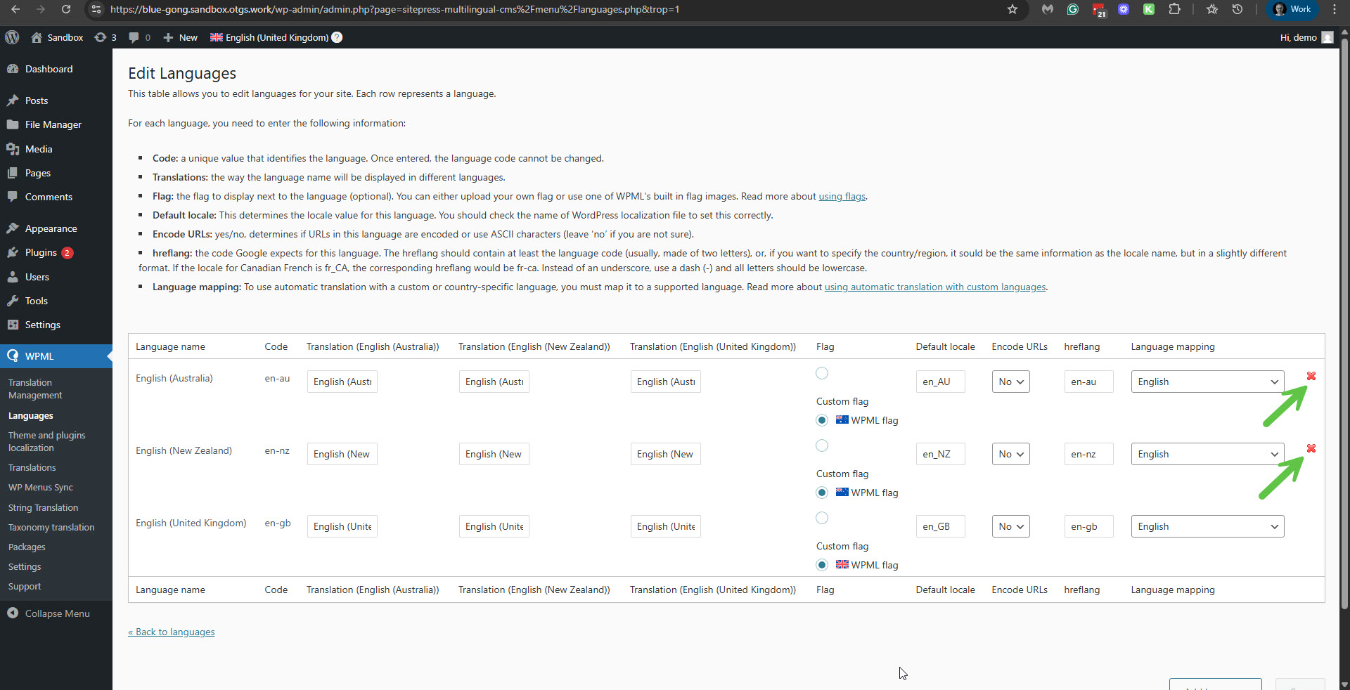

I can see this problem on your site map. We might be looking here at a compatibility issue with the Rank Math plugin. But I'm unsure of that yet. The option to have the HREFLANG in the site's map is relatively new. However, before proceeding with checking the compatibility issue with Rank Math, I was trying to replicate this problem on a fresh WordPress test site. I created a custom English language during the setup wizard. However, I get different results from you. I get the language codes as follows:
English (United Kingdom) = en-gb
English (New Zealand) = en-nz
English (Australia) = en-au
Please see the attached screenshot.
By default, WordPress and WPML use the en_US English language.
If you need other custom English languages, you can follow the method described here.
https://wpml.org/errata/how-to-add-english-united-states-as-a-custom-language-to-use-as-default-or-translation-language/
You can also create custom languages in WPML -> Languages -> Edit languages. Please read about it here.
https://wpml.org/documentation/getting-started-guide/language-setup/editing-wpmls-languages-table/#add-custom-languages
Can you please tell me how you created your custom English languages?
When I look at your hidden link, I notice another thing that is out of the ordinary. It is not possible to remove the custom languages. Please see the red X icons on my screenshot. This makes my question about how you created the languages even more valid. It will help me proceed with this case.

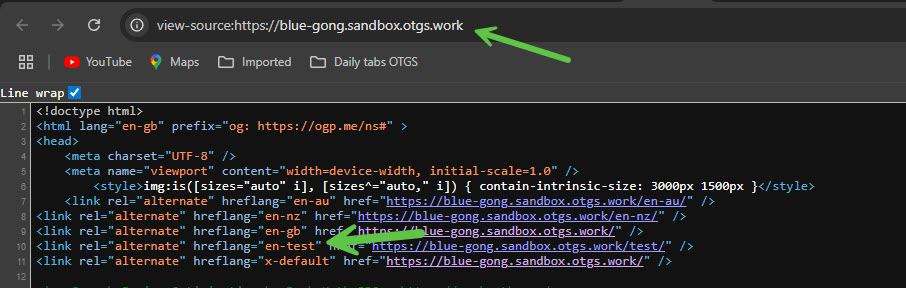

I was unable to replicate this problem on a fresh WordPress installation with WPML and its add-ons, and Rank Math + Pro. You can check my test site here.
With this link, you'll be logged in directly.
On the Rank Math sitemap, the hreflang shows correctly. For example, see here:
view-source:hidden link
Please check the settings on my test site and compare to your site. Hopefully you will be able to find where the fault is and correct it on your site. It is also worth trying to save the Rank Math and permalinks settings again and checking if it helps.

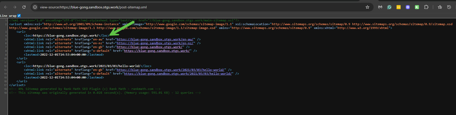

Thanks! It appears you helped us spot a compatibility problem.
The regular pages and posts get the hreflang from the 'hreflang' field in the languages' table. Please see the attached screenshot. It is your test language 'en-test' that is showing the expected 'hreflang' value from the 'hreflang' field. However, Rank Math sitemaps get it from the language code. I'll escalate this issue to our compatibility team and keep you updated here on any news regarding this issue.
Itamar.
