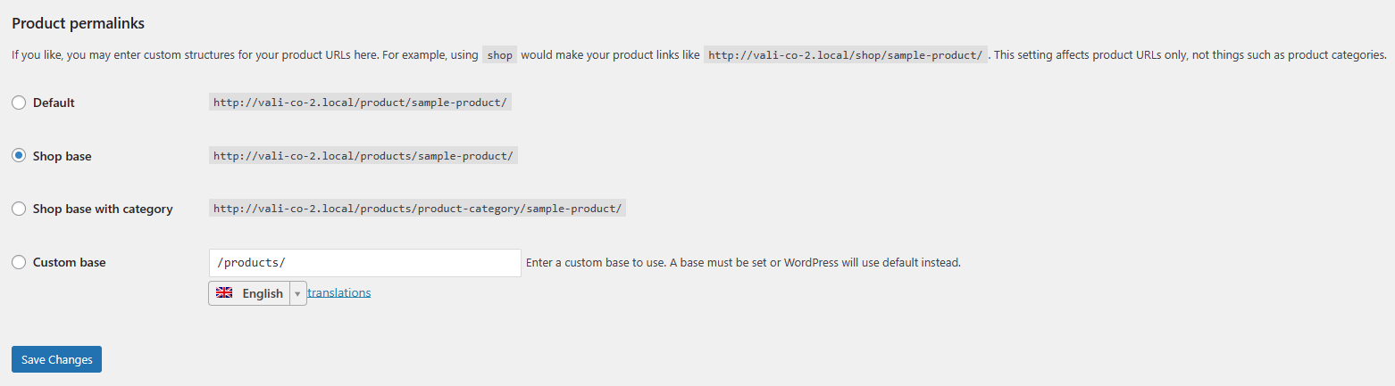

March 10, 2023 at 8:18 am #13214347
majdA-6
Hi, that doesn't make any sense. I already know if I did that it will work.
But in my WooCommerce permalink settings I have set the default product permalink base to be SHOP base (view uploaded image). This works fine in default language. I dont have it setup as you wrote with "product" as product base and "products" as shop base, I have "products" for both.
This displays correct breadcrumb hierarchy when visiting a product page and is better for UX and probably SEO.
I only start having issues when I start translating. I don't understand why I can't have same product permalink base hierarchy structure for translated languages aswell. I think you need to send this to higher tier support for clarification on this issue and why this is not working.
Because, this is possible per WooCommerce default settings without issues.

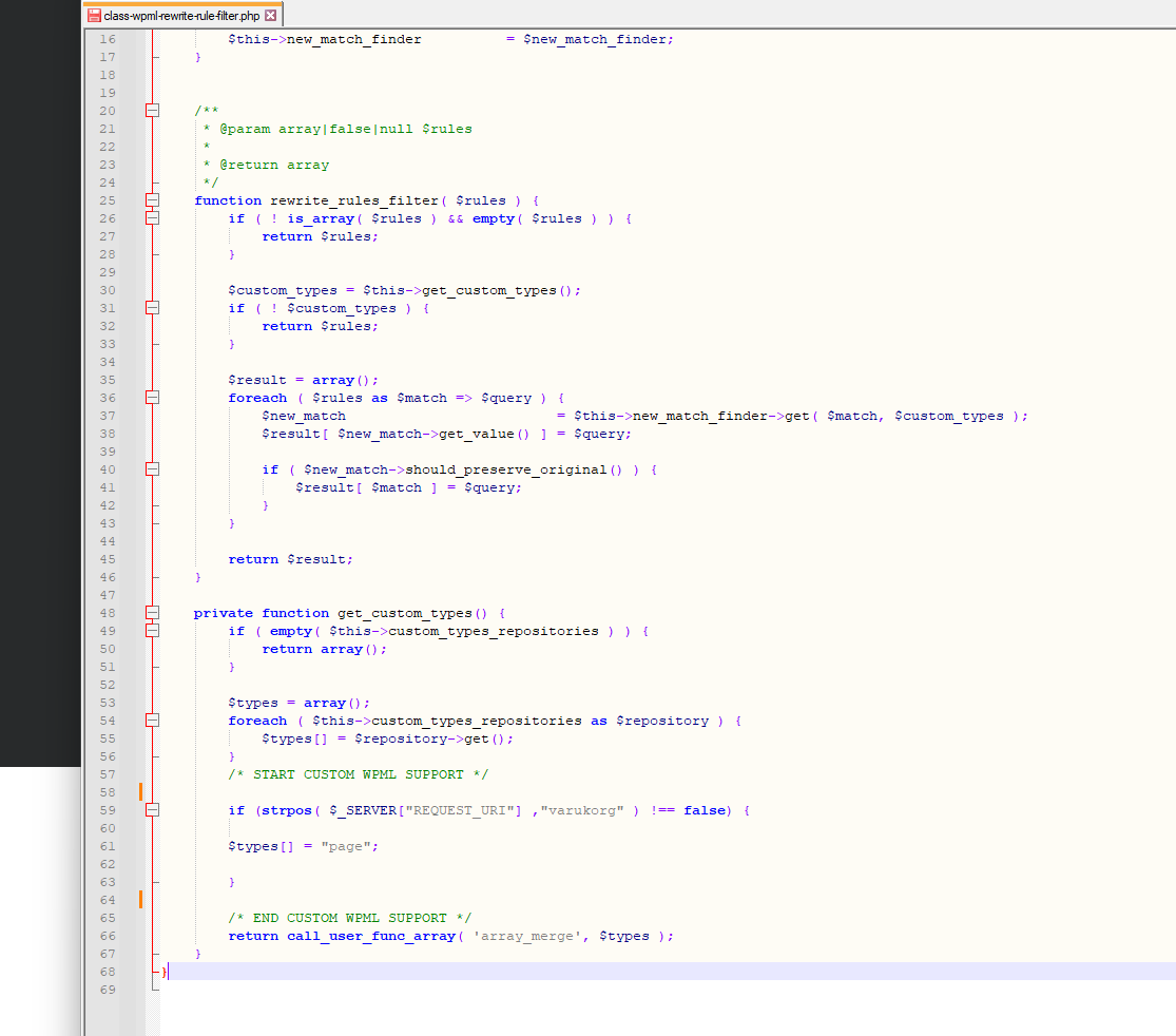

March 22, 2023 at 8:28 am #13301471
majdA-6
Thank you but it didn't work. It threw a fatal error actually when visiting the cart page:
Fatal error: Uncaught TypeError: array_merge(): Argument #3 must be of type array, string given in C:\Users\Majd\Local Sites\vali-co-2\app\public\wp-content\plugins\wpml-string-translation\classes\slug-translation\class-wpml-rewrite-rule-filter.php:64 Stack trace: #0 C:\Users\Majd\Local Sites\vali-co-2\app\public\wp-content\plugins\wpml-string-translation\classes\slug-translation\class-wpml-rewrite-rule-filter.php(64): array_merge(Array, Array, 'page') #1 C:\Users\Majd\Local Sites\vali-co-2\app\public\wp-content\plugins\wpml-string-translation\classes\slug-translation\class-wpml-rewrite-rule-filter.php(30): WPML_Rewrite_Rule_Filter->get_custom_types() #2 C:\Users\Majd\Local Sites\vali-co-2\app\public\wp-content\plugins\wpml-string-translation\classes\slug-translation\RewriteRules\Hooks.php(52): WPML_Rewrite_Rule_Filter->rewrite_rules_filter(Array) #3 C:\Users\Majd\Local Sites\vali-co-2\app\public\wp-includes\class-wp-hook.php(310): WPML\ST\SlugTranslation\Hooks\Hooks->filter(Array) #4 C:\Users\Majd\Local Sites\vali-co-2\app\public\wp-includes\plugin.php(205): WP_Hook->apply_filters(Array, Array) #5 C:\Users\Majd\Local Sites\vali-co-2\app\public\wp-includes\option.php(253): apply_filters('option_rewrite_...', Array, 'rewrite_rules') #6 C:\Users\Majd\Local Sites\vali-co-2\app\public\wp-includes\class-wp-rewrite.php(1486): get_option('rewrite_rules') #7 C:\Users\Majd\Local Sites\vali-co-2\app\public\wp-includes\class-wp.php(163): WP_Rewrite->wp_rewrite_rules() #8 C:\Users\Majd\Local Sites\vali-co-2\app\public\wp-includes\class-wp.php(780): WP->parse_request('') #9 C:\Users\Majd\Local Sites\vali-co-2\app\public\wp-includes\functions.php(1332): WP->main('') #10 C:\Users\Majd\Local Sites\vali-co-2\app\public\wp-blog-header.php(16): wp() #11 C:\Users\Majd\Local Sites\vali-co-2\app\public\index.php(17): require('C:\\Users\\Majd\\L...') #12 {main} thrown in C:\Users\Majd\Local Sites\vali-co-2\app\public\wp-content\plugins\wpml-string-translation\classes\slug-translation\class-wpml-rewrite-rule-filter.php on line 64
Please continue investigate the issue. I don't think it is a "edge" case and I am surprised not more people have reported this since it is normal to set shop base to same in product permalinks. I initially thought it was specific to my site. It's also supported on default woocommerce settings.

It looks like you are testing the code in the local host, can you please share a screenshot of the custom code added to the file wp-content/plugins/wpml-string-translation/classes/slug-translation/class-wpml-rewrite-rule-filter.php?
I've tested to apply the code on your sandbox site and it works correctly. Please check this screenshot hidden link
Look forward to your reply.
March 22, 2023 at 9:20 am #13302269
majdA-6
Sure, view attached.
March 22, 2023 at 10:58 am #13303719
Long Nguyen
WPML Supporter since 02/2022
Languages: English (English ) Vietnamese (Vietnamese )
