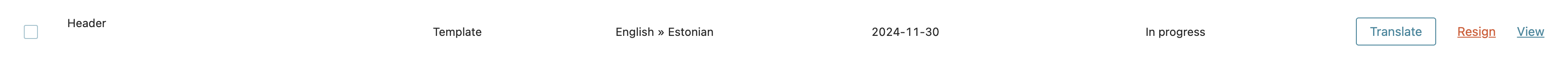

reioR
I don't need to change original language. I'm trying to complete translation. Another example. When translating Header template. ATE shows that translation is 100% complete. When i click "Complete Translation" on ATE, redirected back to WPML translation queue and status does not change from "in progress" and header template remains to translation queue.
Is this expected behaviour?

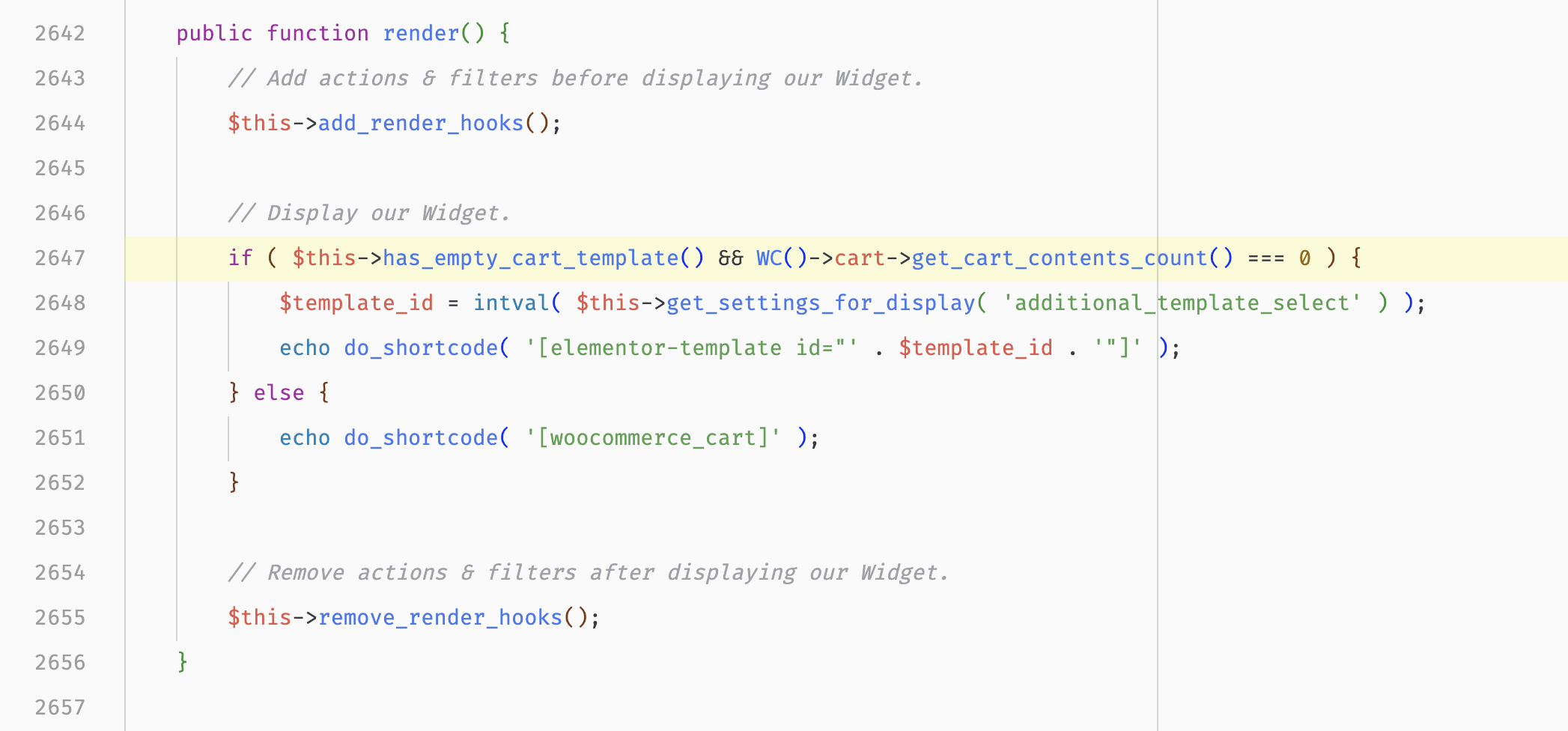

With new demo page, translations are working.
From ATE errors log there is:
Call to a member function get_cart_contents_count() on null /var/www/htdocs/wp-content/plugins/elementor-pro/modules/woocommerce/widgets/cart.php:2647
Error appears when i'm trying to translate elementor-pro header, shop, cart etc. pages.
ATE Job ID for one of the errors is: 121491784
I also included section from cart.php as a screenshot.
Do you have suggestions or i should temporarily modify elemento-pro widget to check that WooCommerce is loaded and Wc()->cart exists?
