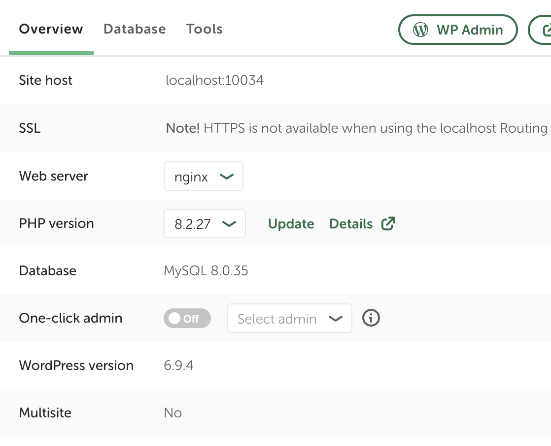

Paola Mendiburu
WPML Supporter since 11/2020
Here you can find my local details of the wordpress with a copy of your site. Please see attached image
Please see this video where I can add a custom language without problems:

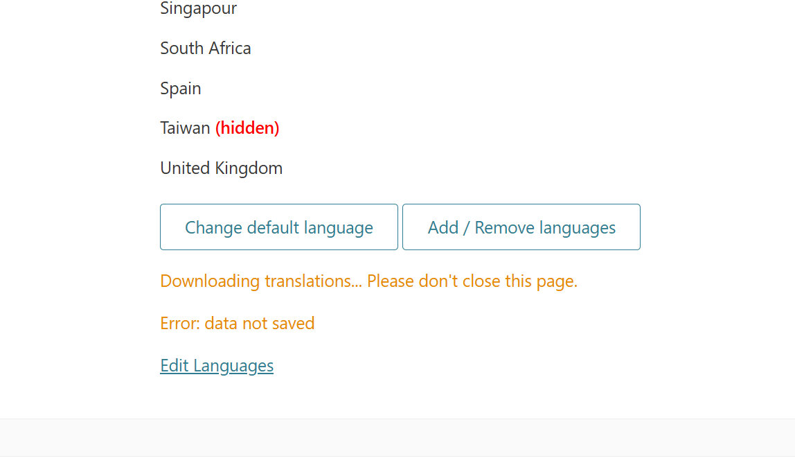

So I tried the same from our staging env, which is also behind Cloudfront and notices, right before the page reloaded, the following message:
Right after, the page reloaded with the new language.
What this message "Error: data not saved" means?
Now an other issue: if I edit the page, and set other language namies for the new language... the request will fail, with a server error. Now if I reload the page, the modification will be visible, but still: the request obviously didn't end as expected.

April 30, 2026 at 9:49 am #18005095
Paola Mendiburu
I was able to add it without problems as you can see in this video: hidden link
What you can do is to disable WooCommerce then add the language.
