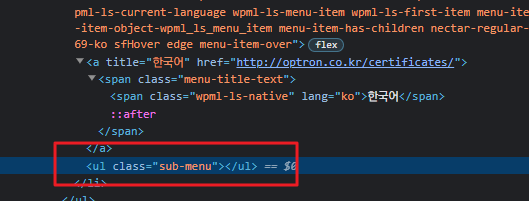

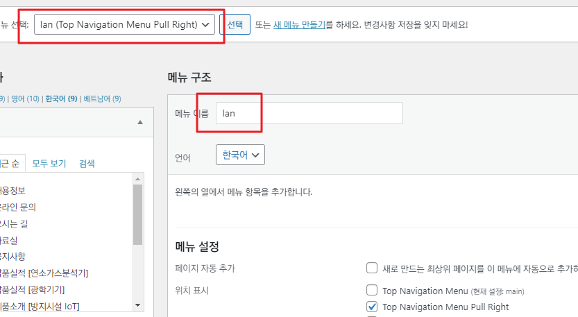

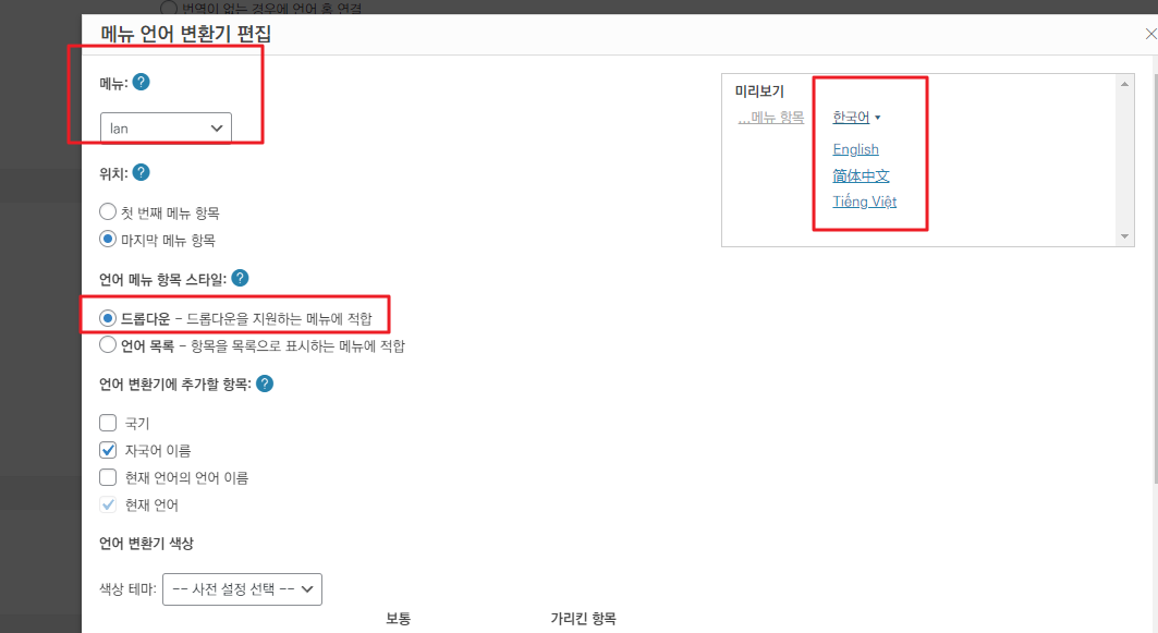

I'm sure I set it up well, but I can't see the submenu. What's going on? Please check it out and let me know the solution.

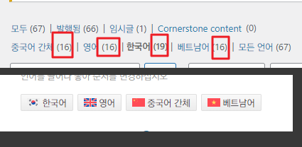

It seems that the languages are missing from the code which means that there is a chance there's no existing translation for that page.
Can you please confirm that the page that you are referring to has been fully translated and the translation has been published? If it is not published yet, or in "review"/draft mode, then we won't have any languages at the top.

The pages are all published. I don't know why there is no language-related code on the menu.

There might be a compatibility issue here between WPML and (at least) one of the active plugins.
I tested with one post that I created (hidden link) > and translated here into EN (hidden link) but the same thing is happening where the languages don't show up in the language switcher.
If I change the language switcher from drop-down to "languages list", it shows up fine as you can see in the screenshot I attached.
The dropdown functionality is broken because of an incompatibility more than likely.
