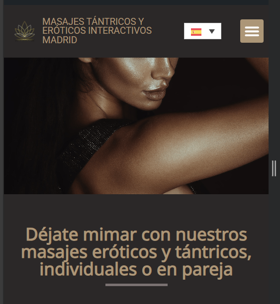

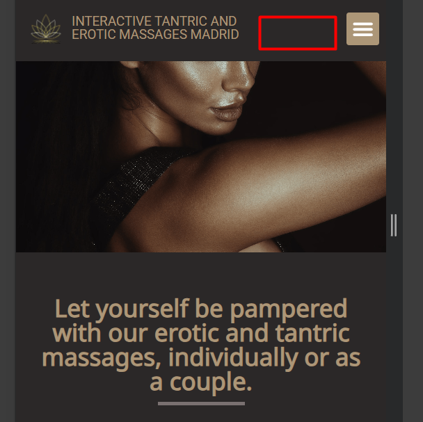

I have added a custom language switcher in my header elementor template. When I switch language using that, translating is working perfectly.
My language switcher is hidden after changing the language. It's showing only on my default language.
Can you please check and see what's the problem. My language switcher is hidden after language change. Please help. Thanks.

March 2, 2025 at 11:23 pm #16766384
andreC-37
I have tried the first method and it's still not working. Can you please explain second method in detail? I don't understand it. It's only showing on my default language. Please help. Thanks
