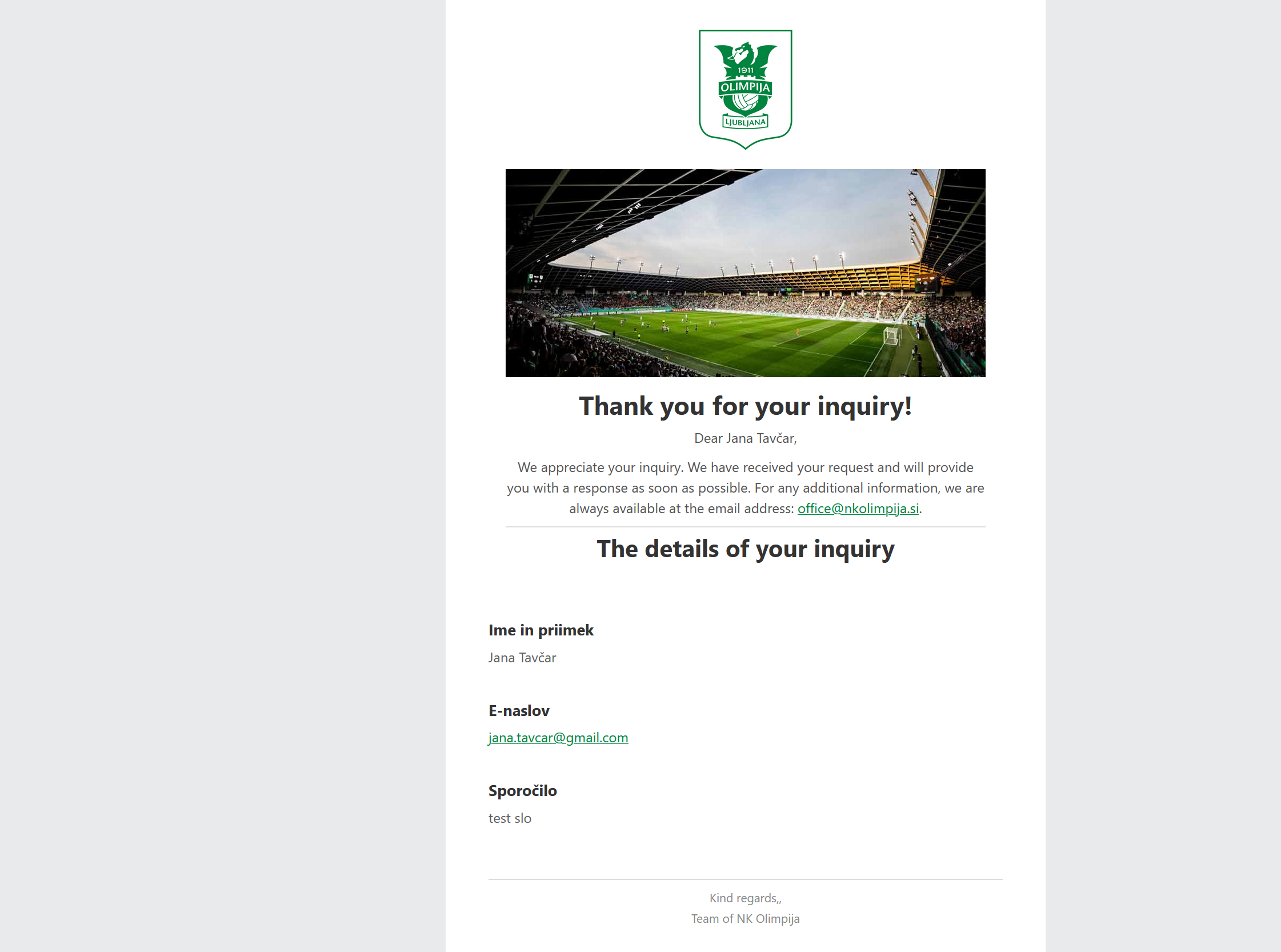

February 10, 2025 at 3:20 pm #16688375
gregorB-9
Look I have done the same thing and i get all email in english when i use slovenian contact. What should i do?

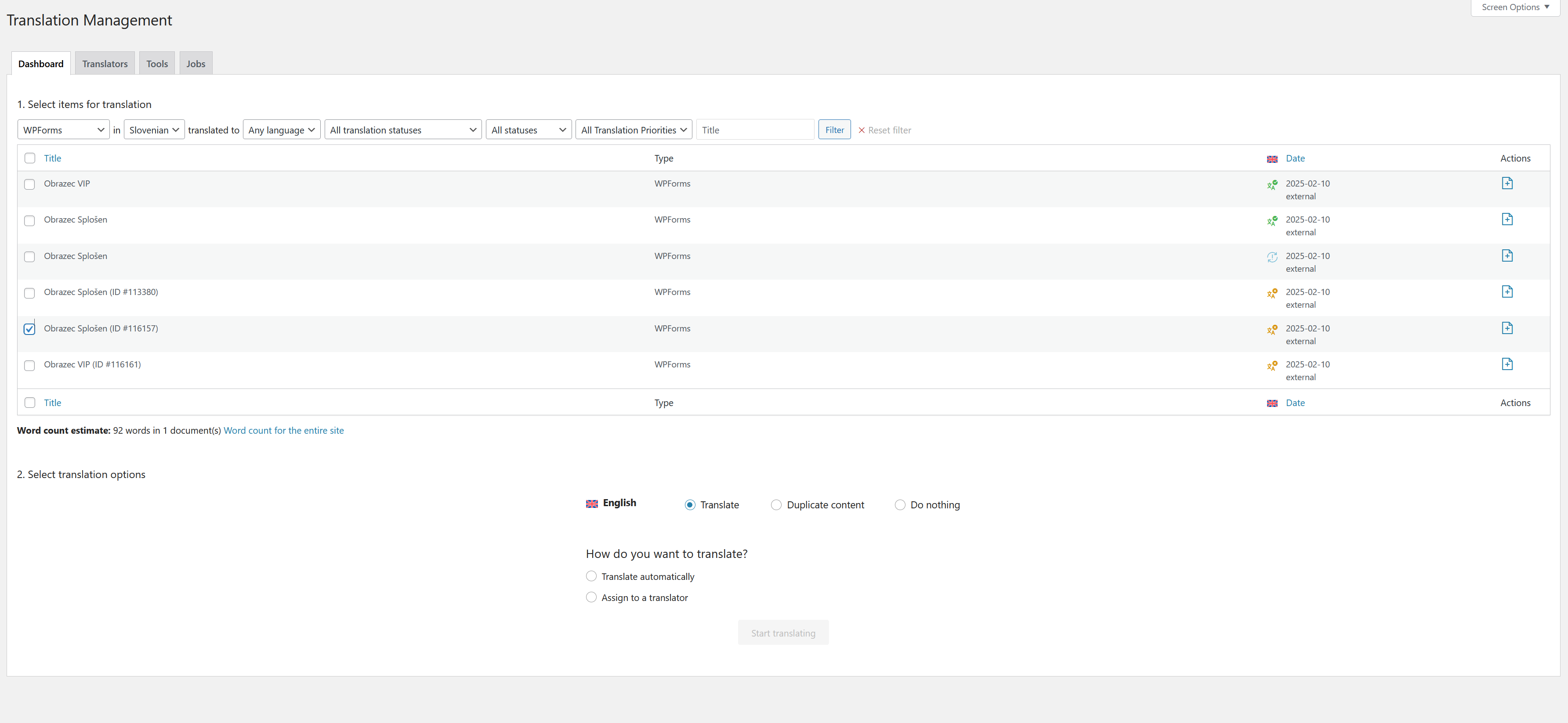

February 10, 2025 at 3:48 pm #16688584
gregorB-9
ok so now i have duplicated it and i get notofication on mail in slovene. now aht i have done yestrerday is this:
I have put marker on the form like on the picture, translate-translate automaticaly-start translating and then everything was in english. Was i doing something wrong?

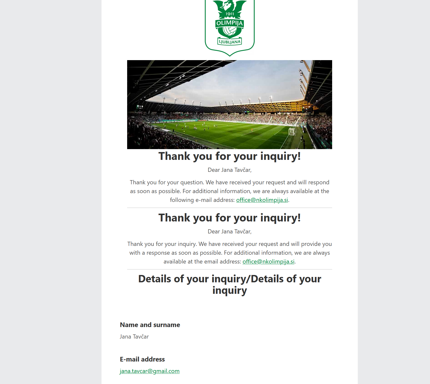

February 10, 2025 at 4:34 pm #16688832
gregorB-9
Now i have duplicated 2 forms and done nothing on translation management an everything works great but I have dubble text in english version.
Where can i change that?
this is the code on notification:

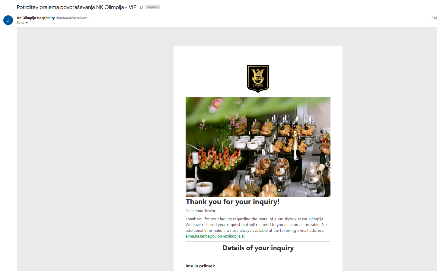

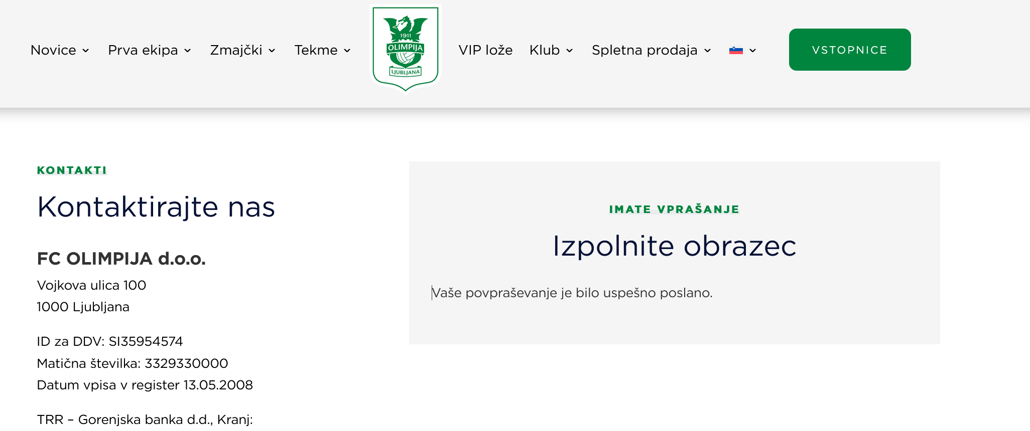

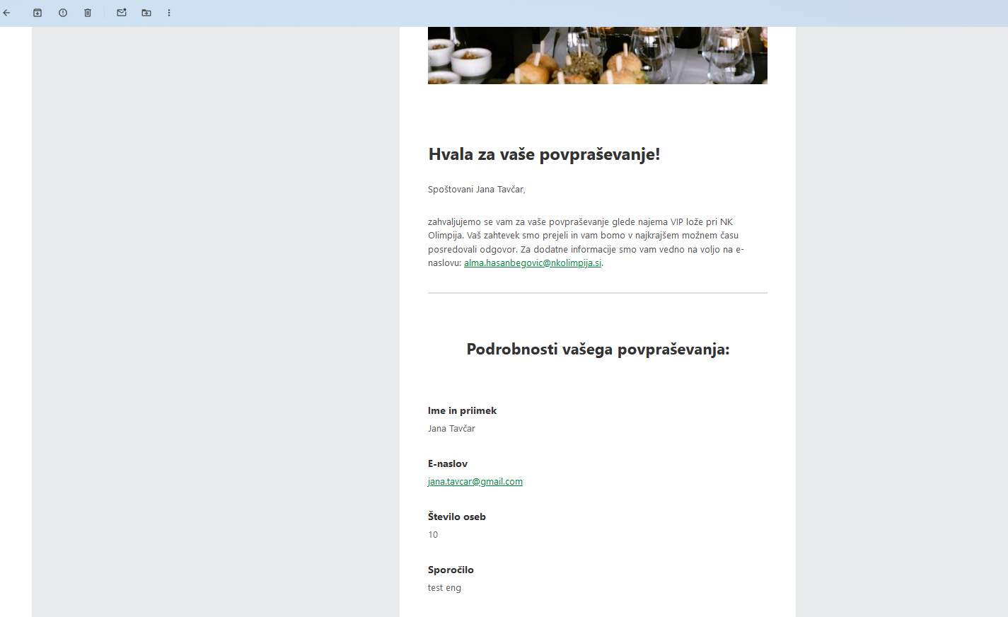

February 10, 2025 at 5:01 pm #16688978
gregorB-9
Dear sir,

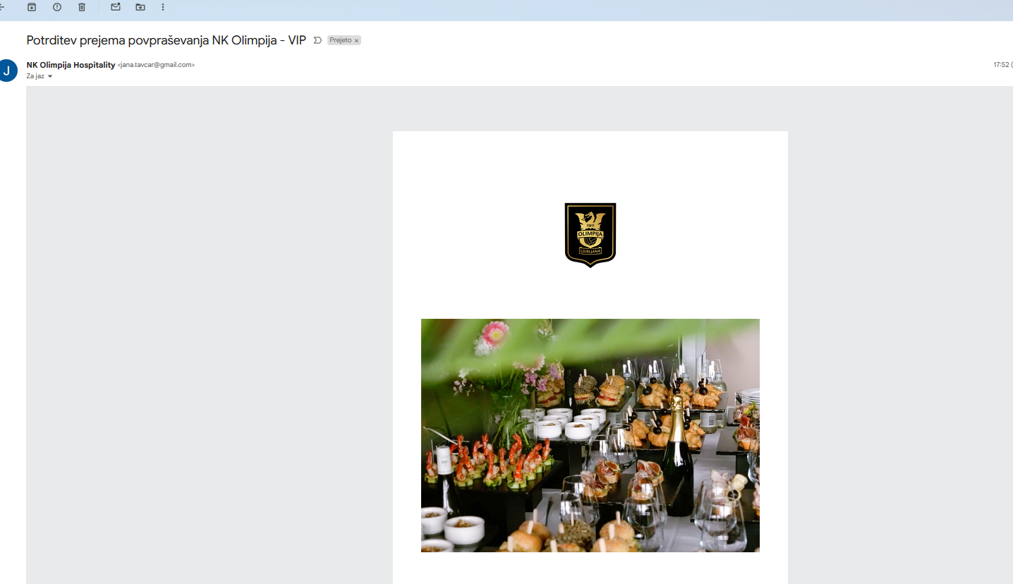

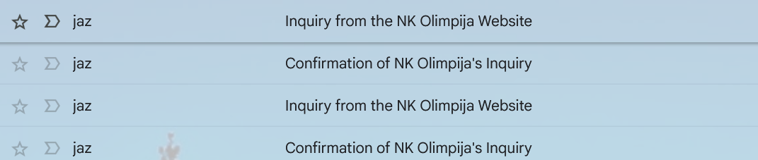

I'm loosing my nervs over this. This is just madnes. Now I have everything ok in the contact page, but on VIP hospitality page I have slovenian mails when i send it from english page and english confrirmation mails if i sendit from slovenian page. I need to publish the page tomorow!! Please find a solution for this ASAP.

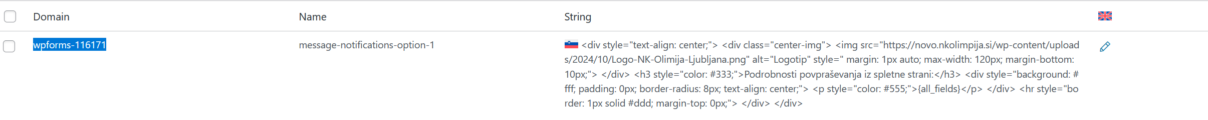

Hi....please check my string for wp form wpforms-116171 I have slovenian tekst in strings and i get english headlines on mails. This is something that is not on me anymore. I need it someone to take a look and give me a solution ASAP!
