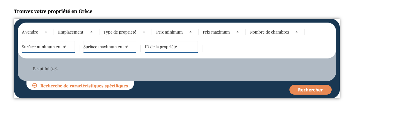

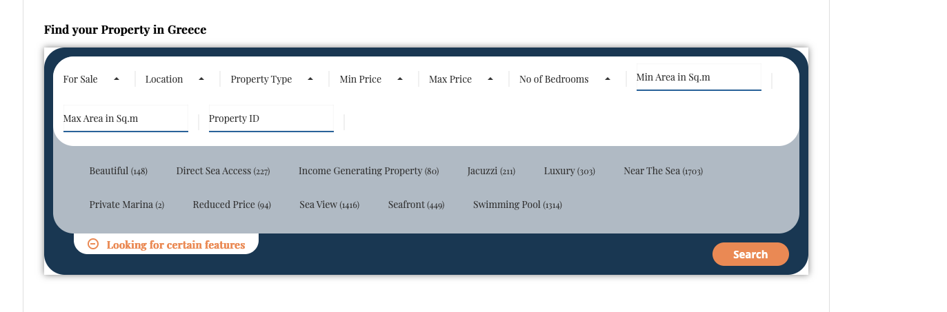

I am using the Real Homes theme and have created a search form with Elementor on my site hidden link. I have translated the Property Features taxonomies using WPML, and the slug is the same in both languages.
The Elementor search form does not display the translated Property Features, except for one feature that is not translated and remains in English.
Why are the translated Property Features not appearing in the Elementor search form?
How can I ensure all translated Property Features are displayed correctly in the search form?

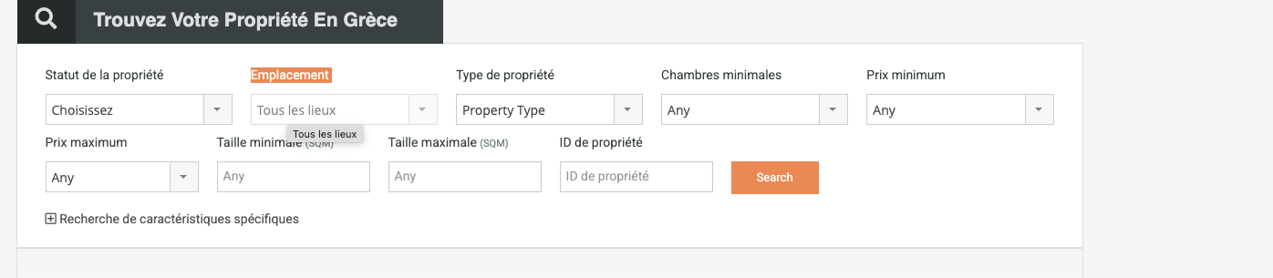

Any updates? I’m also experiencing an issue with the main Search Form of my RealHomes theme — the property locations (called “Emplacement” in French) don’t appear unless I update the page. They show temporarily after the update but disappear again shortly after.

I still dont see
1. in the elementor search form the "Additional Property Features"
2. in the Main Themes Search form the "Property Types"

I solved the issue with the main Themes Search Form. That the property Locations didnt appear in the French translation.
This was a Themes Customation option, to show or not to show the empty ( without assign properties) Locations.
The problem was that since I choose NOT to translate the Properties ( because are many,like 2000), the tranlsated Locations appeared as empty, zero properties in every location ( Athens etc) in French.
Sio by enabling to show also teh empty Locations, the isue is resolved.
I still cannot find solution for the Elementor Serch Form, for the" Additonal Features" ( Seafront etc) that do now appear in French Translation.
I assume that is exactly the same issue. That in the French translation, the assign "seafront: properties are zero and this is why they dont appear.
However I dont have any customization given from my them for the "additional Fields were I can just check "show Additojnal Fields with Zero assigned Properties".
So what we do about it?

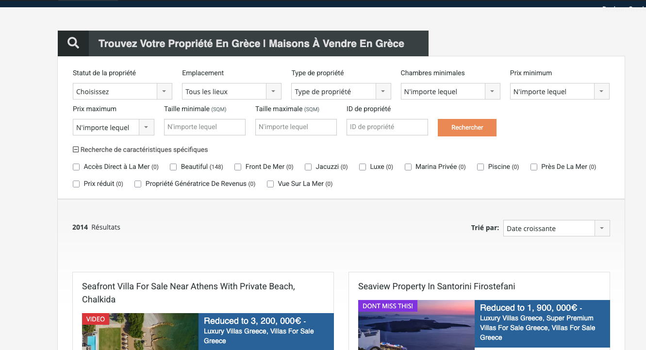

Ok I will add this code but just a clarfication, the search results are ok, the only issue is that I dont see the "additional features"
For example in the classic form, that the additional features are shown correctly, i see the number of properties that have a feature (lets say seafront) 0 ( zero) but the results are shown perfect.
So what I want is the additional features to be shown even if appears zero properties with these features,

I remind you that in the classic search from of the theme I see all the additional feauters with a zero number next to them but workds great.
