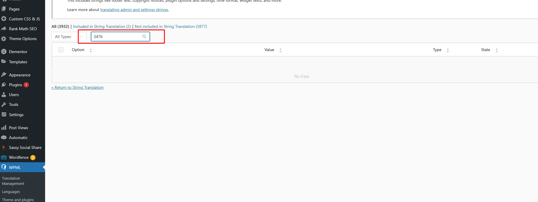

josephN-9
I need to translate a few templates using string translation, but I cannot find them in the string translation area or even in Admin Texts Translation. The issue can be seen on this page: hidden link.
<b>Symptoms: </b>
I cannot find the templates I need to translate in the string translation area or Admin Texts Translation.
<b>Questions: </b>
Why can't I find the templates in the string translation area?
How can I translate templates that are not appearing in Admin Texts Translation?
I'm using Foxiz theme, Elementor page builder and all is up to date:
I created a few Ruby template for individual category [Ruby_E_Template id="3476"]
And translated it to spanish
when I try to translate it from "string translation"
I cannot find this template by search and not even Admin Texts Translation.
What's wrong ?

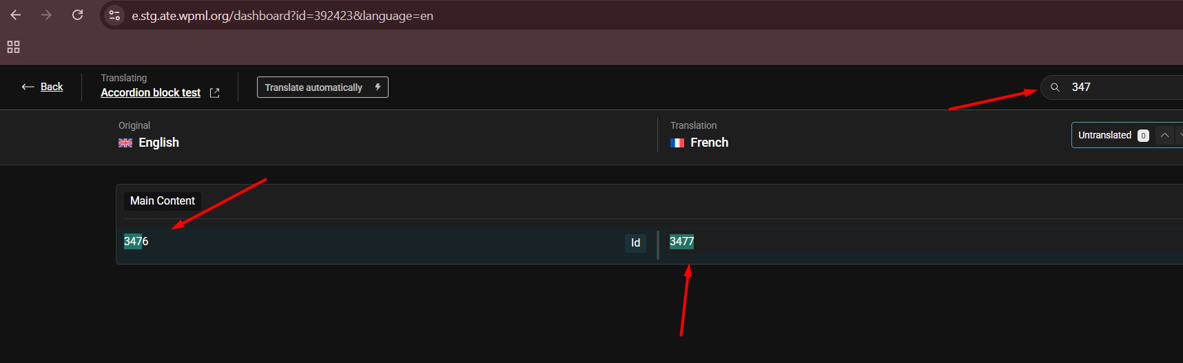

3. Edit the default language page where the shortcode is used. Make a small change (like updating the title), then save.
4. Open the translation in WPML’s Translation Editor. You should now see the template ID string (e.g., 3476). Replace it with the translated template ID.
5. Complete the translation and check if it shows correctly on the front end.

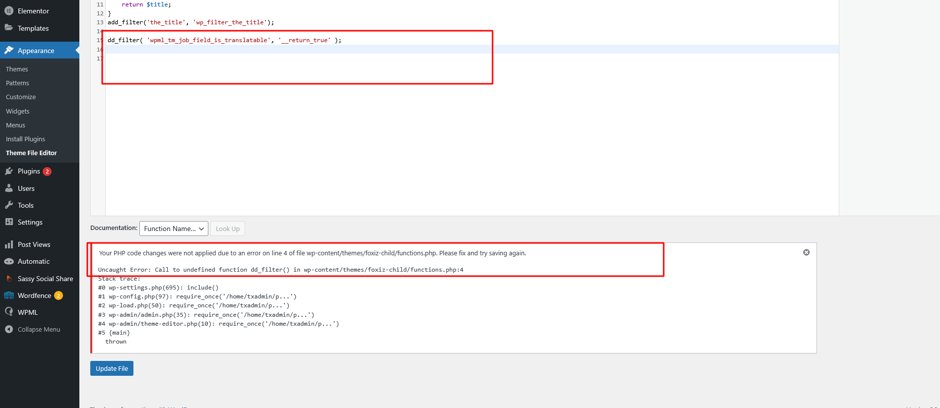

I'm using Foxiz Child theme. I encountered an error when I put below code on funmction.php of child theme
dd_filter( 'wpml_tm_job_field_is_translatable', '__return_true' );
Error:
Your PHP code changes were not applied due to an error on line 4 of file wp-content/themes/foxiz-child/functions.php. Please fix and try saving again.
Uncaught Error: Call to undefined function dd_filter() in wp-content/themes/foxiz-child/functions.php:4

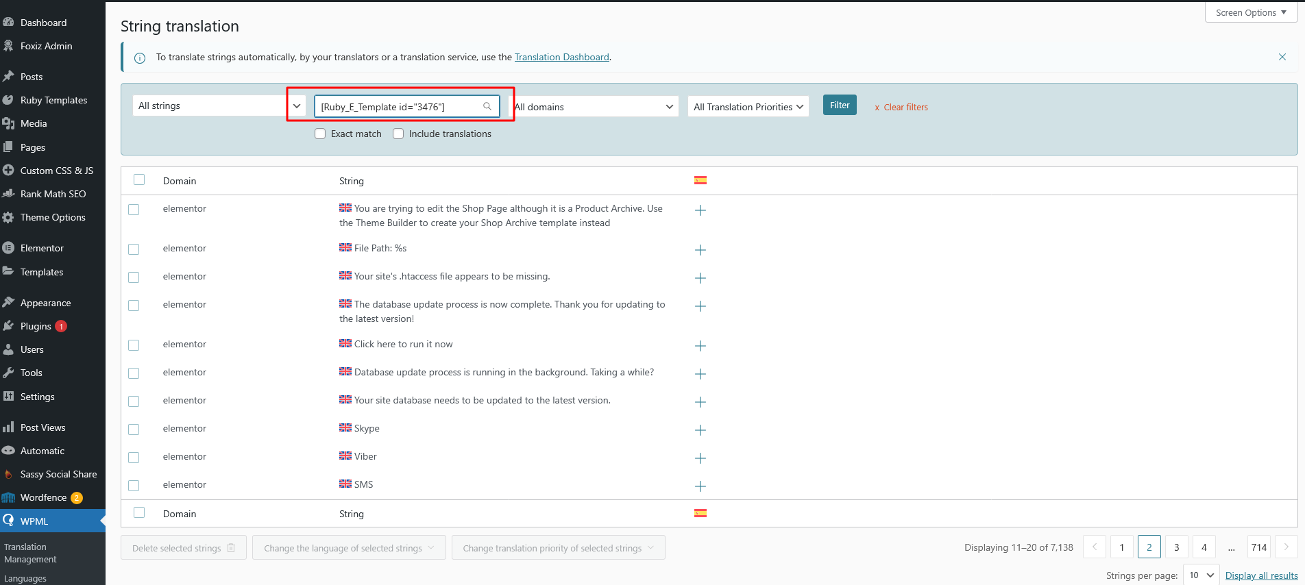

Now I have added code on function.php and WPML >> Settings > Custom XML Configuration section.
And Change this template[Ruby_E_Template id="3459"] style and publish again by elementor builder.
But still I cannot find [Ruby_E_Template id="3459"] this one from Dashboard > WPML > String translation

Thanks for the update. Since the shortcode [Ruby_E_Template id="3459"] is not showing in String Translation, it's likely because it's used inside an Elementor template or content that isn’t yet connected to WPML’s translation workflow.
Here’s what I recommend:
1. Edit the page where the shortcode is used.
2. Make a small change and update the page.
3. Then open the translation, the template ID should now appear for translation.
Let me know if the ID appears in the Translation Editor after that. Please try to search for a shortcode ID using the search input box.
If not, please send a screenshot and page link where exactly [Ruby_E_Template id="3459"] shortcode is being used.
