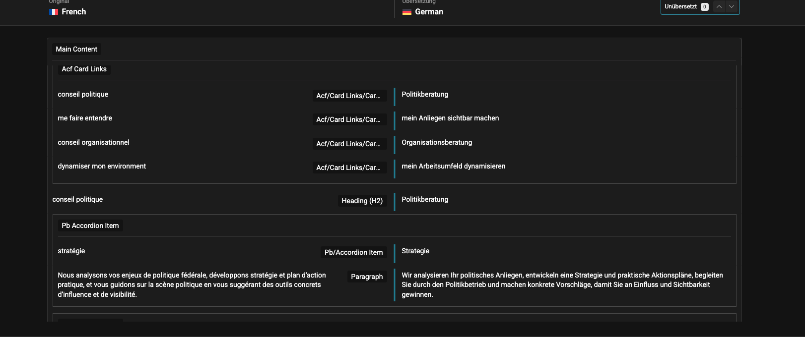

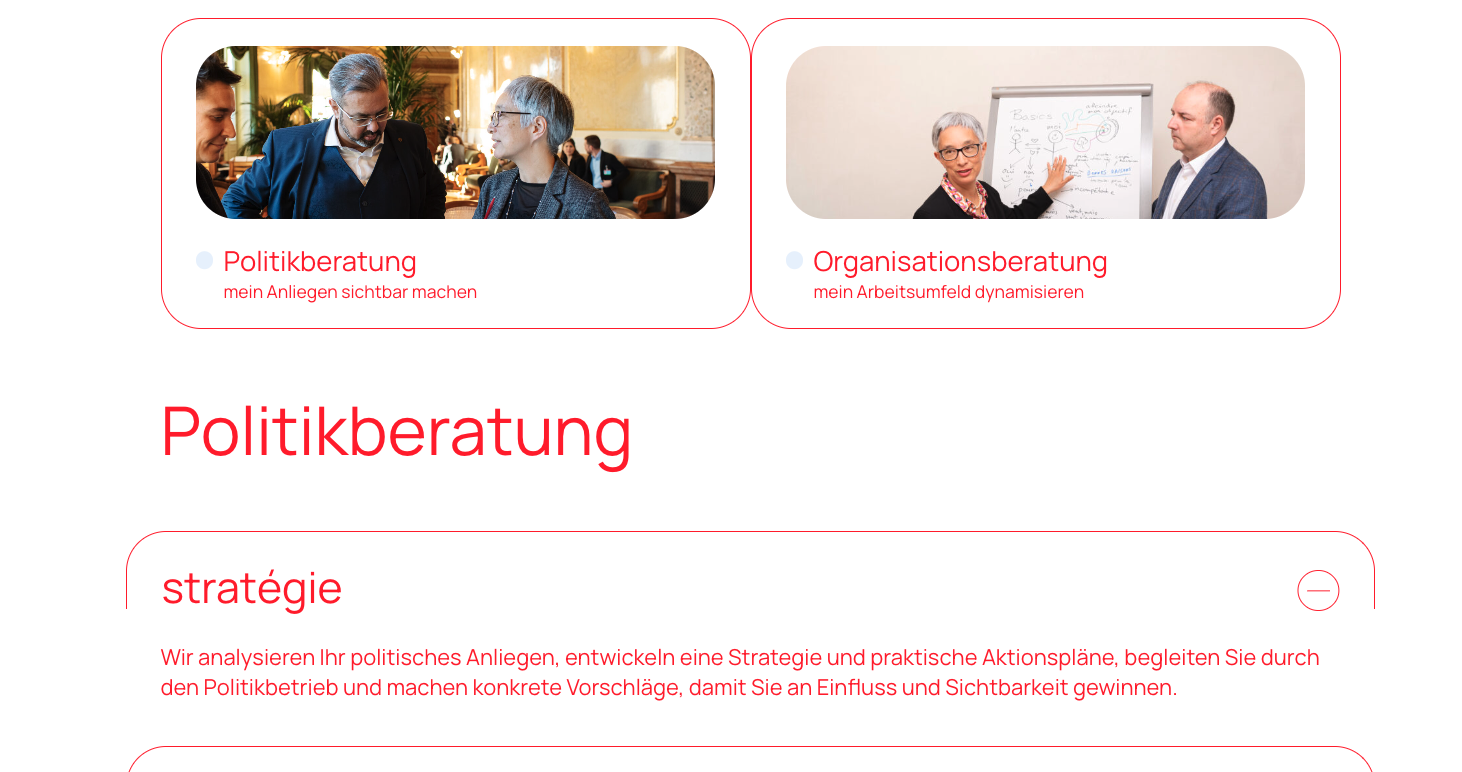

I am trying to translate a page from French to German using the advanced translator. The issue can be seen on this page: hidden link
Certain elements are not appearing translated on the German page. For example, 'stratégie' should appear as 'Strategie'.
Why are certain elements not appearing translated on the German page?
How can I ensure all elements are translated correctly?

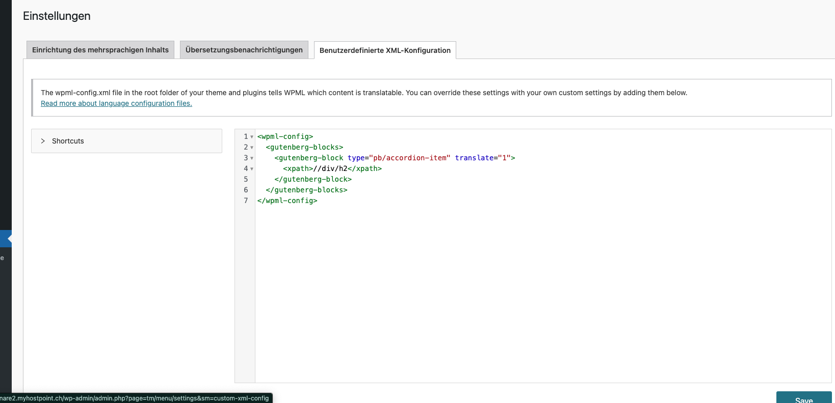

Thank you for contacting WPML Support. Could you please try to follow the below procedure and see if this resolves the issue:
1. Add the below XML in WPML >> Settings > Custom XML Configuration section:
<wpml-config>
  <gutenberg-blocks>
    <gutenberg-block type="pb/accordion-item" translate="1">
      <xpath>//div/h2</xpath>
    </gutenberg-block>
  </gutenberg-blocks>
</wpml-config>
2. Make a small change in the default language page to reload the translation.
3. Open the translated page in WPML Advanced Translation Editor and press the Complete Translation button.
Thank you

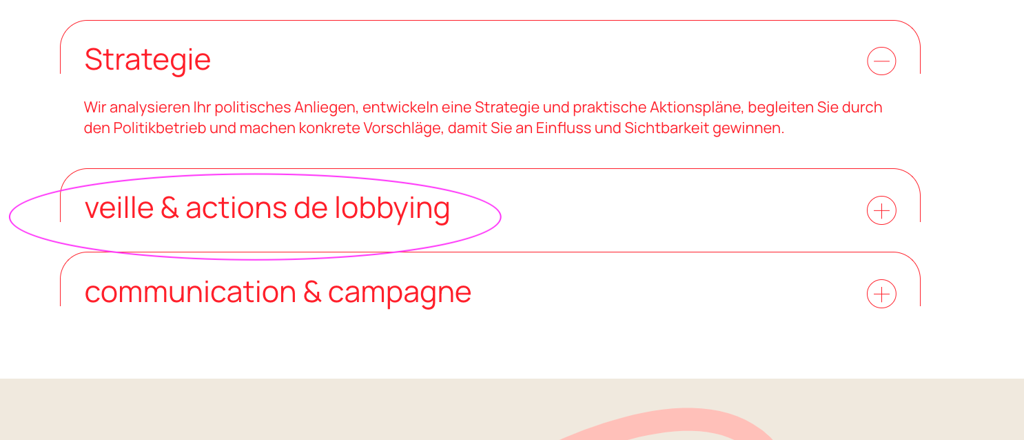

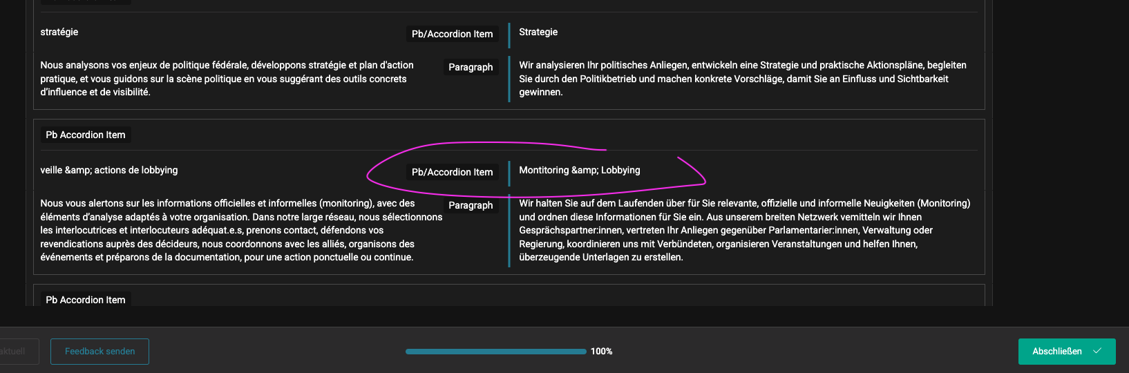

Hi Noman, thanks for your reply. I followed your steps, the problem unfortunately persists: hidden link (see also screenshots attached)

Thanks for providing the login details. I’ve investigated the issue and found that the translation doesn't work when there’s an ampersand (&) in the string. I tested it with default WordPress blocks and it works fine, so the issue seems specific to the Accordion Blocks plugin.
As a workaround, please try replacing the "&" with "and" in the default language accordion title and check if that resolves the issue.
Alternatively, you can contact the Accordion Blocks plugin author to see if they have a fix for this, or consider using a WPML-compatible blocks plugin from this list: https://wpml.org/plugin-functionality/gutenberg-blocks/

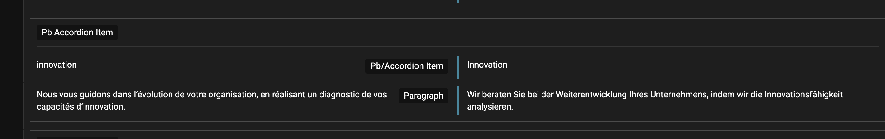

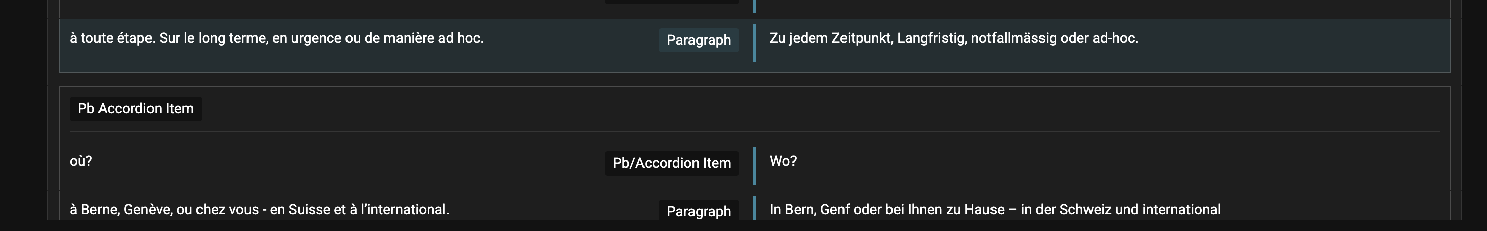

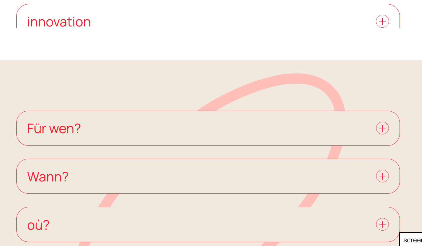

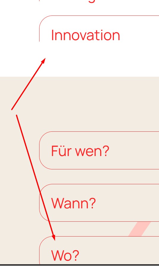

Thanks for your reply. I can see that the two elements you mentioned are fixed. However there are a couple more without any ampersand, e.g ou -> Wo / innovation -> Innovation. The accordeon plugin is a very lightweight plugin with a clean html structure, I don't understand how this can be a problem. And how certain strings are translated and others not.

Thanks for checking. I followed the steps below:
1. Added a space in the two strings and updated the translation.
2. Then removed the space and updated the translation again.
Now the other two strings are also showing the correct translation, as you can see in the attached screenshot.
It seems the issue only affects strings that contain the ampersand (&) symbol. While the Accordion Blocks plugin has clean HTML, special characters like this can sometimes interfere with how WPML detects and handles the content, especially in custom blocks.
For now, the best workaround is to replace "&" with "and" in the original content. Alternatively, you could reach out to the plugin author to see if they can improve compatibility with WPML.
