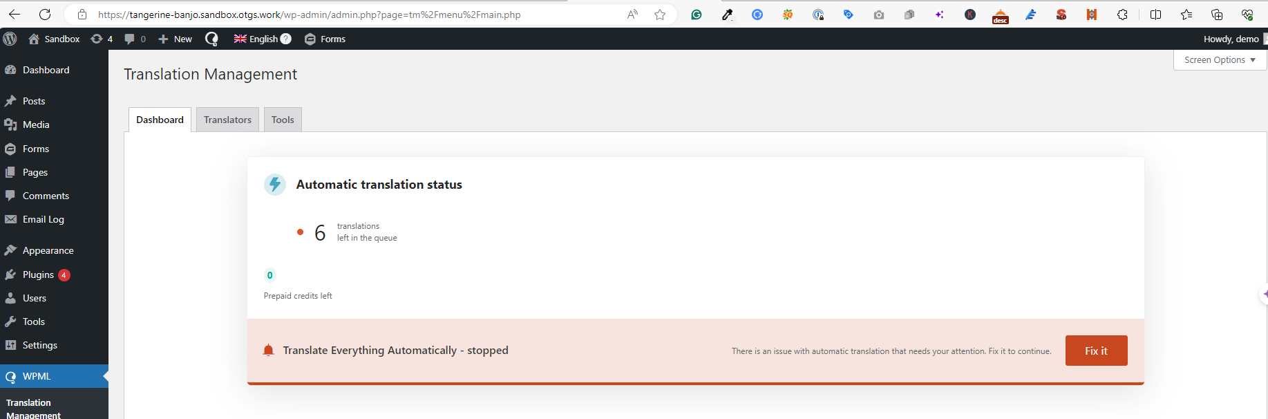

March 28, 2024 at 8:57 am #15459377
montaS
Hi Mohamed,
It seems that there is an issue with the automatic translation.
I attached a screenshot.
Could you have a look at it?
Thanks,
With kind regards,
Martien Verhaar

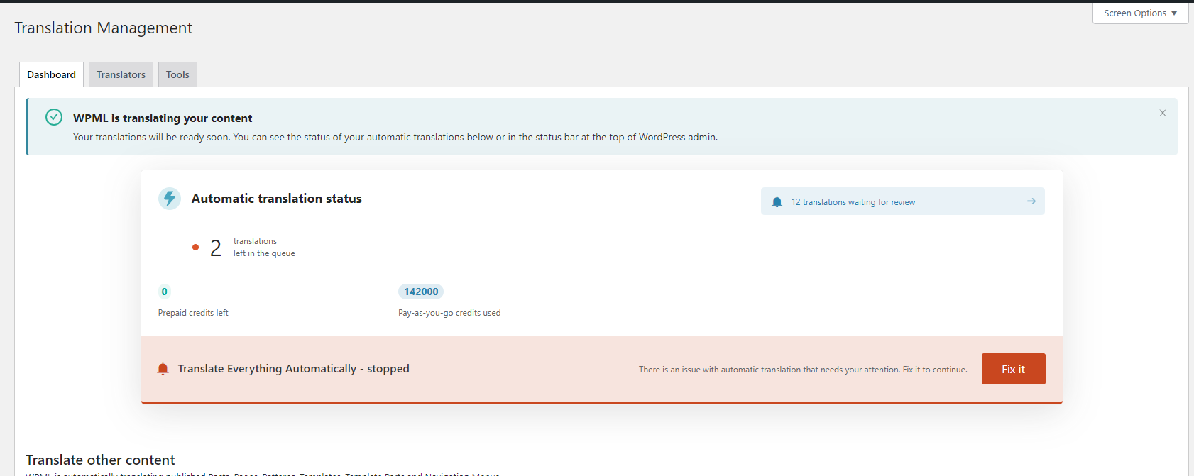

March 28, 2024 at 11:41 am #15460207
montaS
Hi Mohamed,
i get another translation error. (screenshot is attached)
The form needs to be translated because when the trigger words for the routing are displayed in another language the routing does not work anymore.
And that is exactly the problem what i would like to solve.
With kind regards,
Martien Verhaar

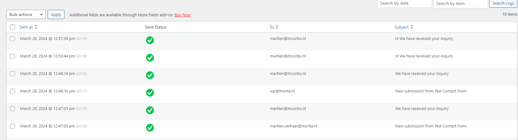

March 28, 2024 at 12:57 pm #15460663
montaS
Hi Mohamed,
I replicated the issue.
In the attached screenshot you can see that 4 forms where submitted.
2 from the English and 2 from the Dutch part of the website.
By the English forms you see there is a notification email send to the user and to the admin/sales department
By the Dutch forms you see that only the email to the user is send.
The email to the admin can not be sent because the routing is not working anymore.
How can i fix that? where can i adjust the routing settings in any other language then the source language?
With kind regards,
Martien Verhaar

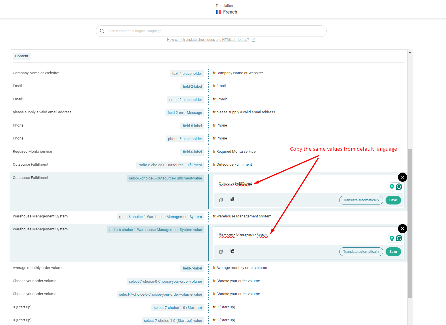

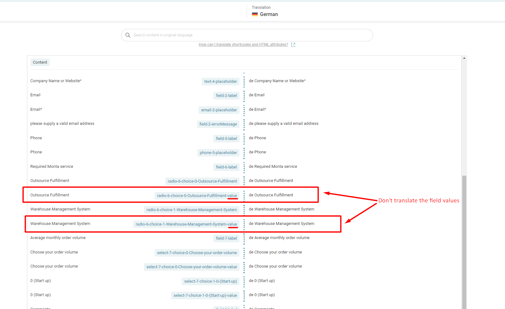

March 30, 2024 at 7:23 pm #15466747
Mohamed Sayed
Hi Martien,
Sorry for the late reply due to the weekend.
The issue happens because the choice field values are translated, and the Routing option depends on those values to send notifications to different email addresses.
You can fix this issue with the following steps:
1. Go to WPML > Translations
2. Edit the form translation
3. Copy the choice field values from the default language for the following:
- radio-6-choice-0-Outsource-Fulfillment-value
- radio-6-choice-1-Warehouse-Management-System-value
4. Complete the translation
I tested this on the sandbox site and now the routing is working from second languages as you can see here: hidden link
