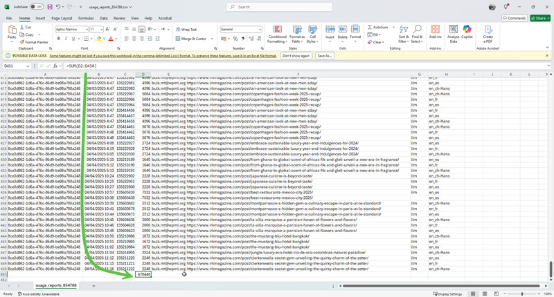

Did you follow Christopher, my colleague's advice?
I downloaded and examined the April report for automatic translation from your site. You have used 678,448 credits and 125 different pages, and posts were translated into 3 languages. Please see the attached screenshot. The most used automatic translation engine is WPML AI (llm), which uses 4 credits per word, Microsoft 1 credit per word, and DeepL 2 credits per word.
Do you observe any mistakes in the report?
Do you see any translation job for which you should not have been charged?
About the transition memory. Please know it is working for future translations. This means that the translation memory will not work on translations sent in the same batch. If you have the same phrase in later translation jobs, the translation memory will be applied, and you will not be charged with credits.
