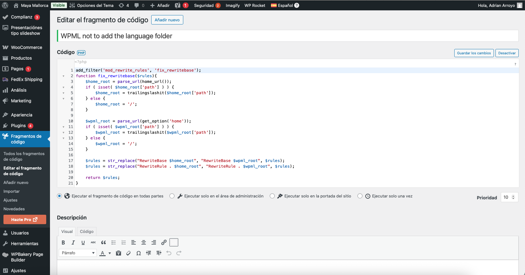

June 18, 2025 at 11:50 am #17145928
adrianA-18
Hello again Drazen,
Finally I added the code via Code Snippets plugin. I attach you a screenshot.
Could you let me know if I added it correctly?,
Also I deleted the cache,
Do I have to do something more?,
Thanks so much,
June 18, 2025 at 3:11 pm #17147433
Noman
WPML Supporter since 06/2016
Thank you for contacting WPML Support. Yes, the code is added correctly, now, please try to follow the below steps:
1. Re-save Permalinks from the Settings >> Permalinks page by pressing the Save Changes button.
2. Clear all sorts of site/server/CDN cache and it should solve the issue.
Thank you
