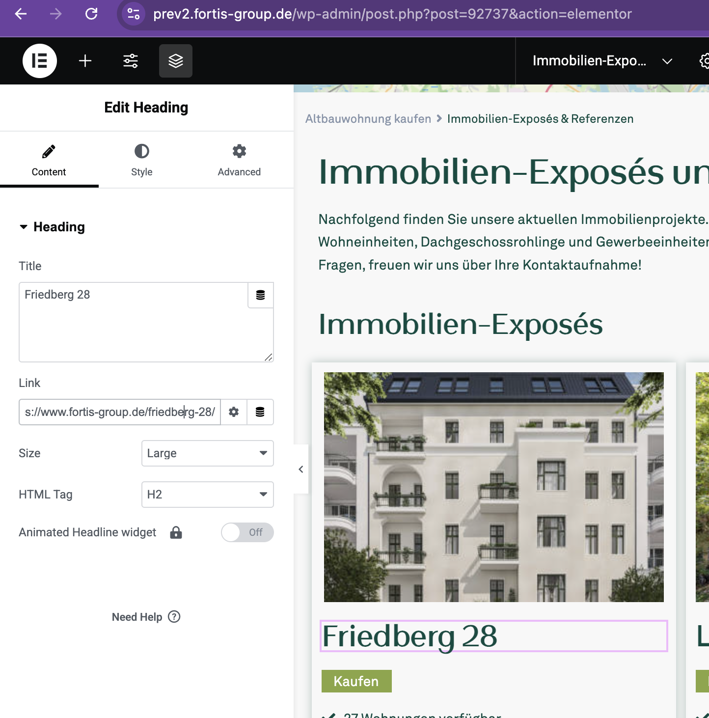

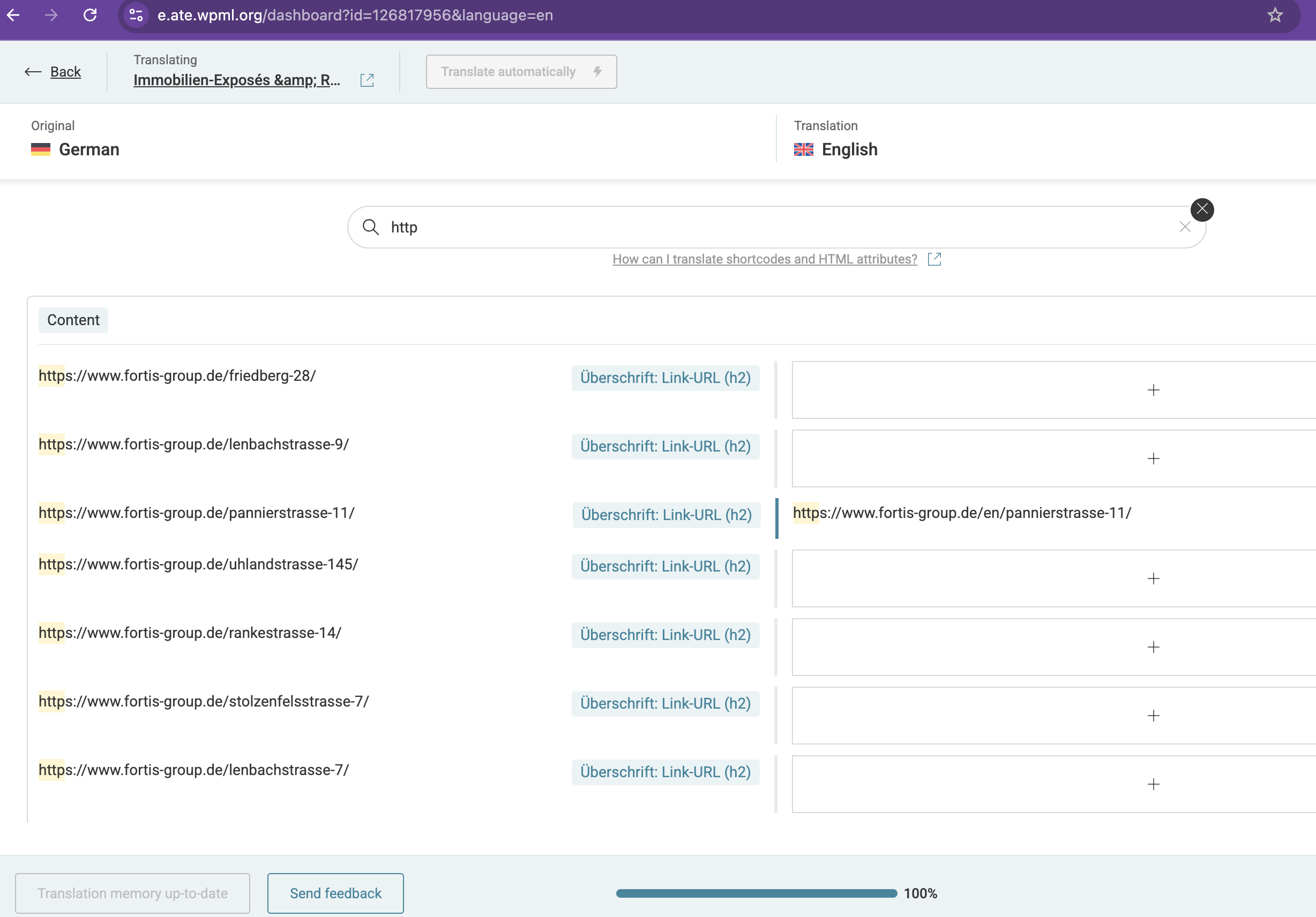

I am developing a site where the original language is German. I want internal links to automatically link to the English version on several pages. I scanned for internal links and used ATE to search for 'http', but nothing was found. I am following the 'wpml internal links' documentation.
Internal links are not set for the English language version and are not visible in ATE.
What is the solution for automatically linking internal links to the English version without changing them manually?

Thanks for contacting us.
I've checked your screenshots and it looks like you're translating a page created using Elementor. Links should be visible in the Advanced Translation Editor.

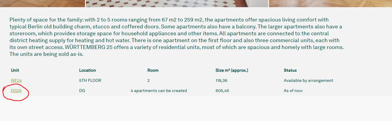

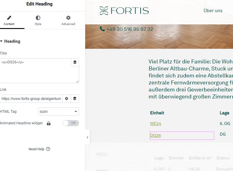

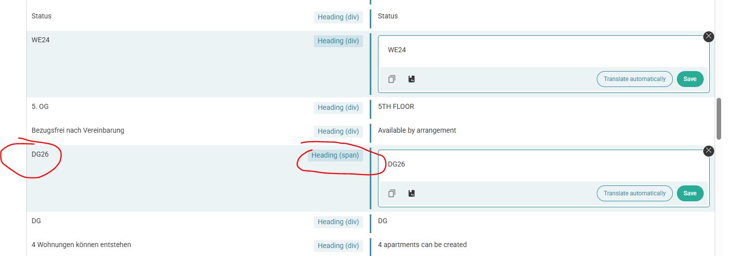

January 21, 2025 at 1:36 pm #16618798
WPML Supporter since 08/2022
Thanks for your reply. I've checked this page hidden link and it looks like you're using static links.
You'll have to manually translate the links as shown in the attached screenshot.
Also, could you tell me which form is not translated?
