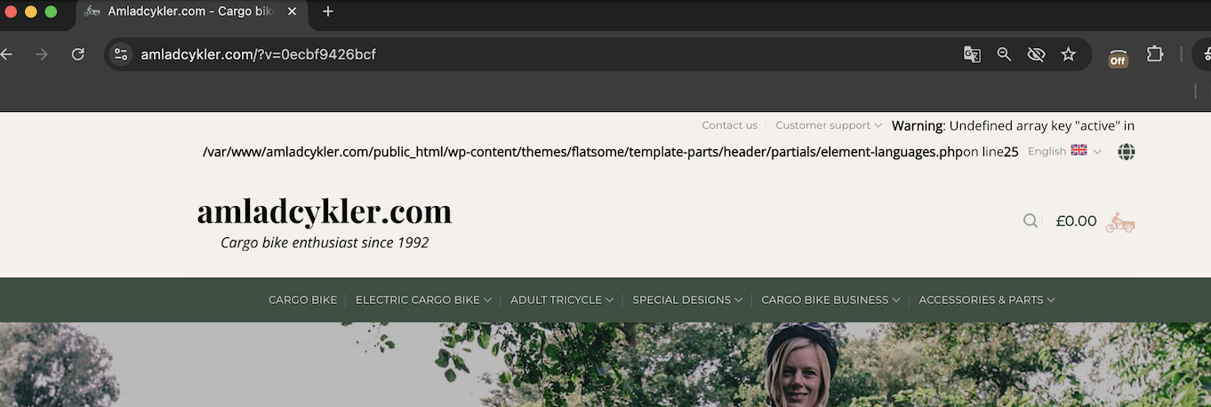

Hi there. Thanks a lot for your help until now🙏. Close but not still there, I get these issues when I'm trying to add your code in my functions file.
Can you help me with why this is?

April 9, 2025 at 10:19 am #16912547
Noman
Could you please try to use the updated code and see if this resolves the issue:
function custom_language_switcher_links( $languages ) {
    $languages['external1'] = array(
        'url' => '<em><u>hidden link</u></em>', // Replace <em><u>hidden link</u></em> with your required external URL
        'native_name' => 'International site',
        'translated_name' => 'International site',
        'country_flag_url' => '<em><u>hidden link</u></em>', // Replace it with flag URL
        'language_code' => 'ext1',
        'code' => 'ext1',
		'active' => 0,
    return $languages;
add_filter( 'icl_ls_languages', 'custom_language_switcher_links' );
Please let me know the results,
Thank you

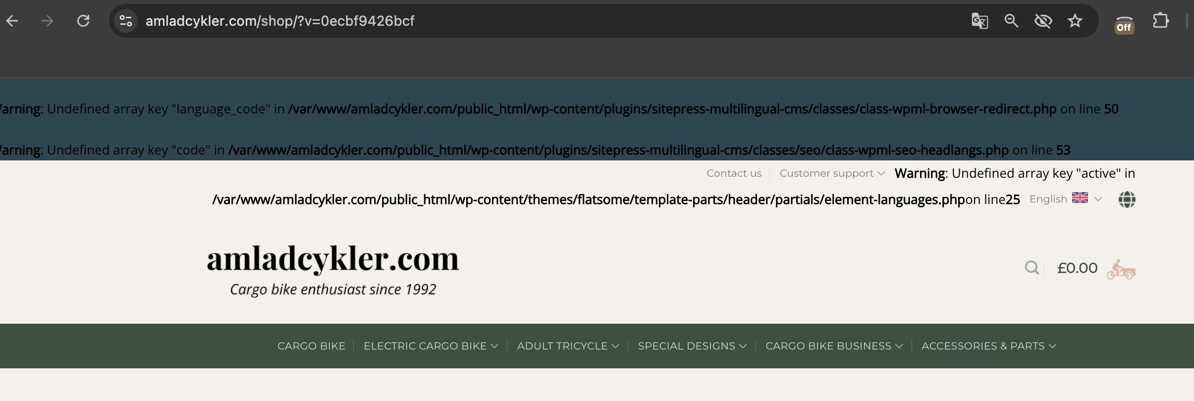

April 10, 2025 at 7:50 am #16916964
martinA-60
Hi there
Thanks a lot for your try, but it still fails, but now only at our shop page: amladcykler.com/shop/. Try to take a look on my screenshot below. Really hope you can help🙏

April 10, 2025 at 12:29 pm #16918509
Noman
Sorry for the trouble. I was testing earlier with the default WP theme which didn’t show any warnings. Now I tested using the Flatsome theme and was able to see the warnings. I’ve updated the code to fix this:
    $languages['ext1'] = array(
        'country_flag_url' => '', // Replace it with flag URL
        'code' => 'ext1',
        'active' => false,
    return $languages;
Here is an example page for your reference:
Please try this updated code and let me know how it goes. Thanks a lot for your cooperation and patience
