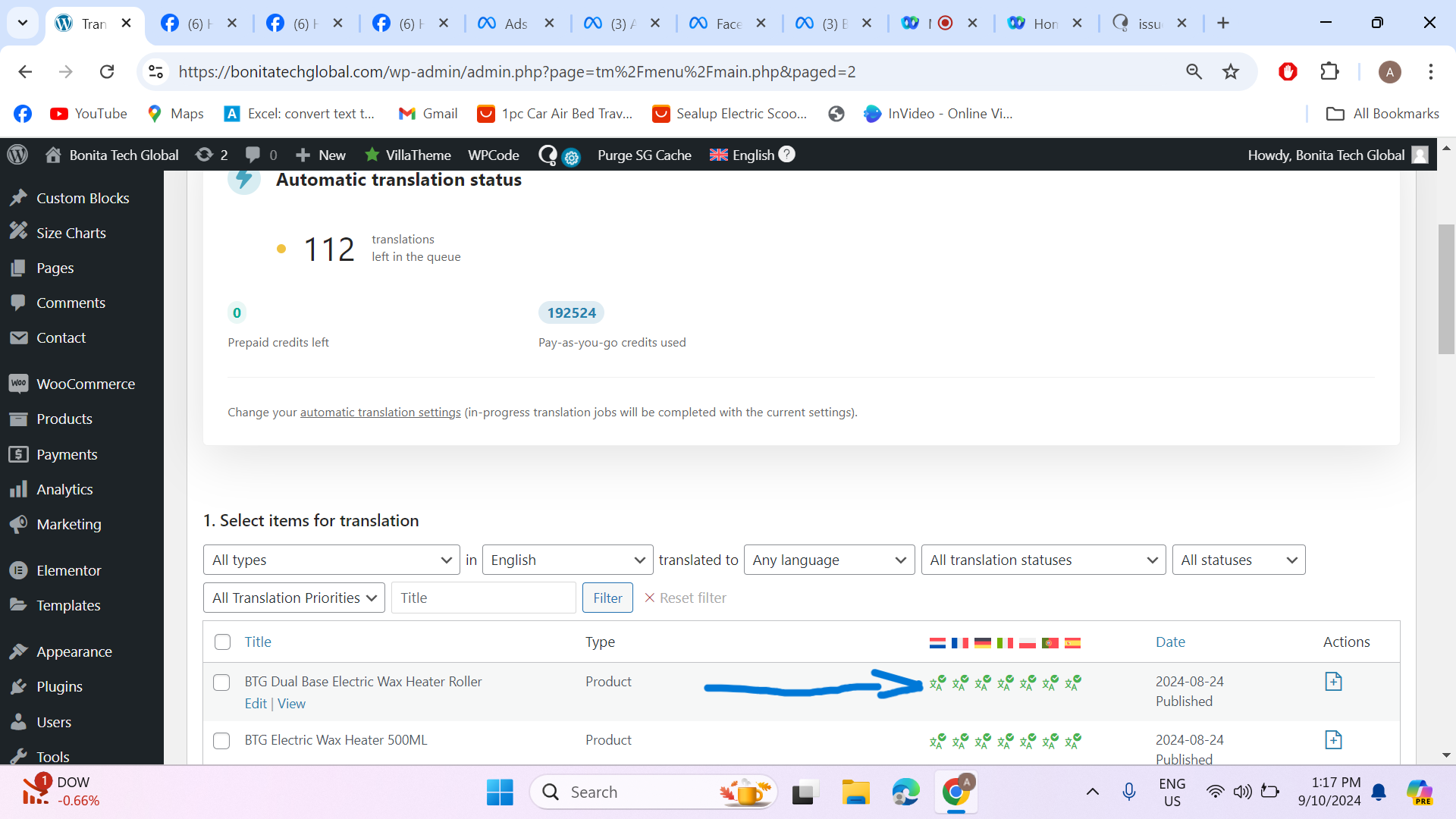

sir it wasnt a notice update , it was just the update icon near every product which i had to translate one by one again. The icons shown in the photo..
Thanks,

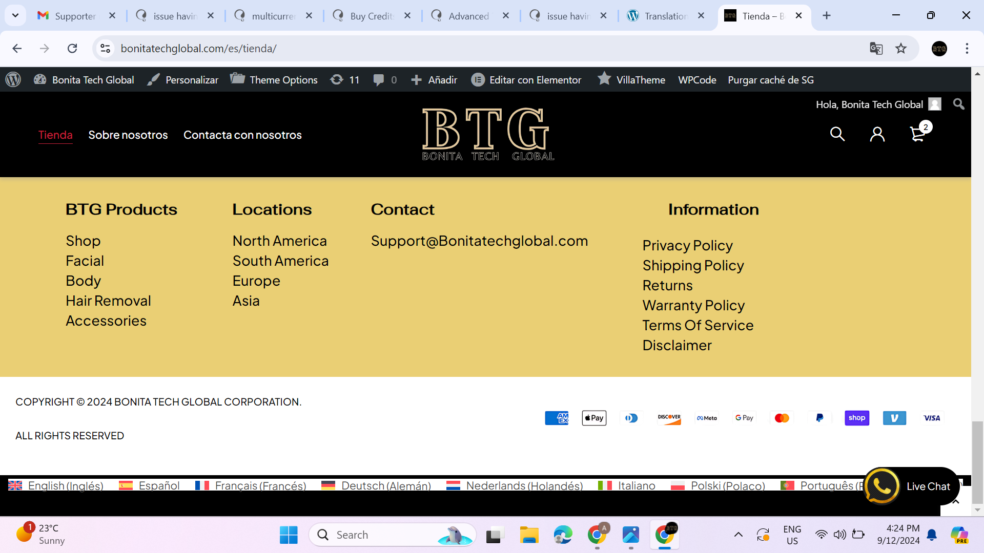

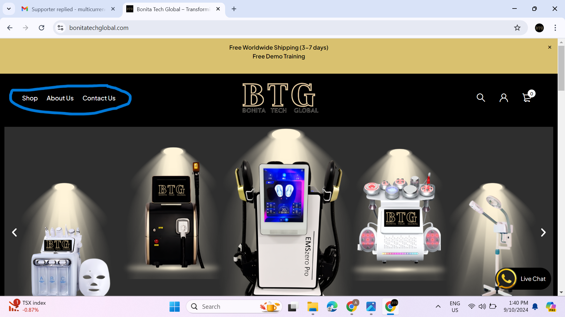

abdullatifE
Also , how do i make sure that the footer and header are translated? As you see in the header picture only shop is being tranlsated and the about us and contact us are dissappearing. the footer is not getting translated at all!
thanks
New threads created by Prosenjit Barman and linked to this one are listed below:
https://wpml.org/forums/topic/split-few-sections-are-not-getting-translated/

The icon highlighted in the screenshot indicates that the page is fully translated. When you see it under the language flag, you can be confident that the translation is saved and displayed correctly. If you make changes to the default content, an update icon will appear. For now, everything seems fine. However, if you're experiencing any issues even after the translation, could you provide more details? Sharing steps to replicate the issue, a video, or screenshots would be really helpful. I'll review the information and assist you further.

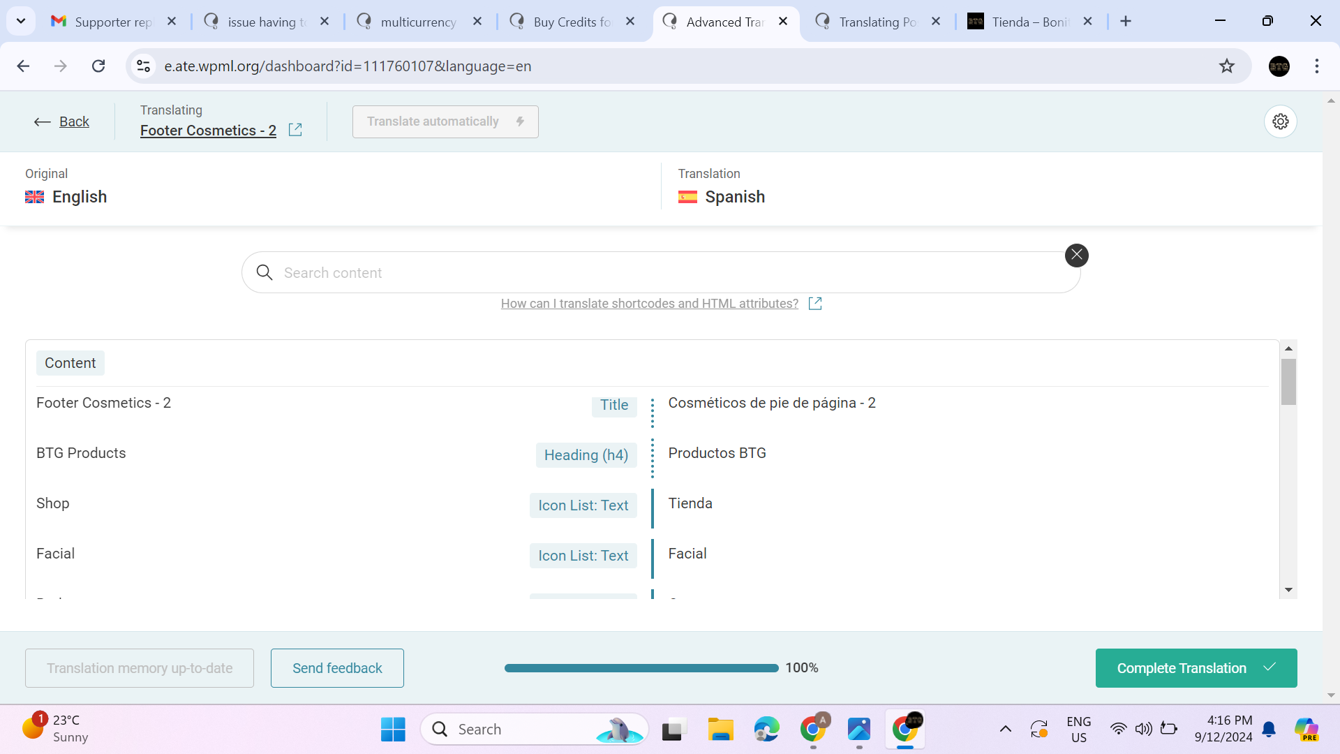

September 12, 2024 at 8:26 pm #16173447
abdullatifE
Hello Again,
I went to footer block and translated as shown in the image. However, Its not getting translated in the footer page.
kindly advise what may be the issue!
Thanks,

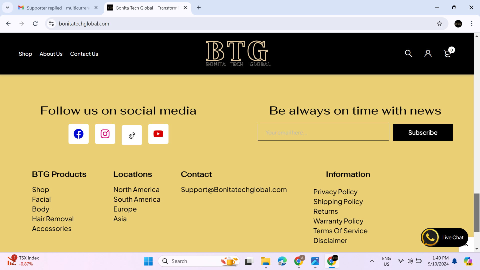

September 16, 2024 at 6:30 am #16181376
abdullatifE
hi,
so as mentioned the footer was translated in the footer block section in the wordpress dashboard however on the website it still doesnt show as translated.

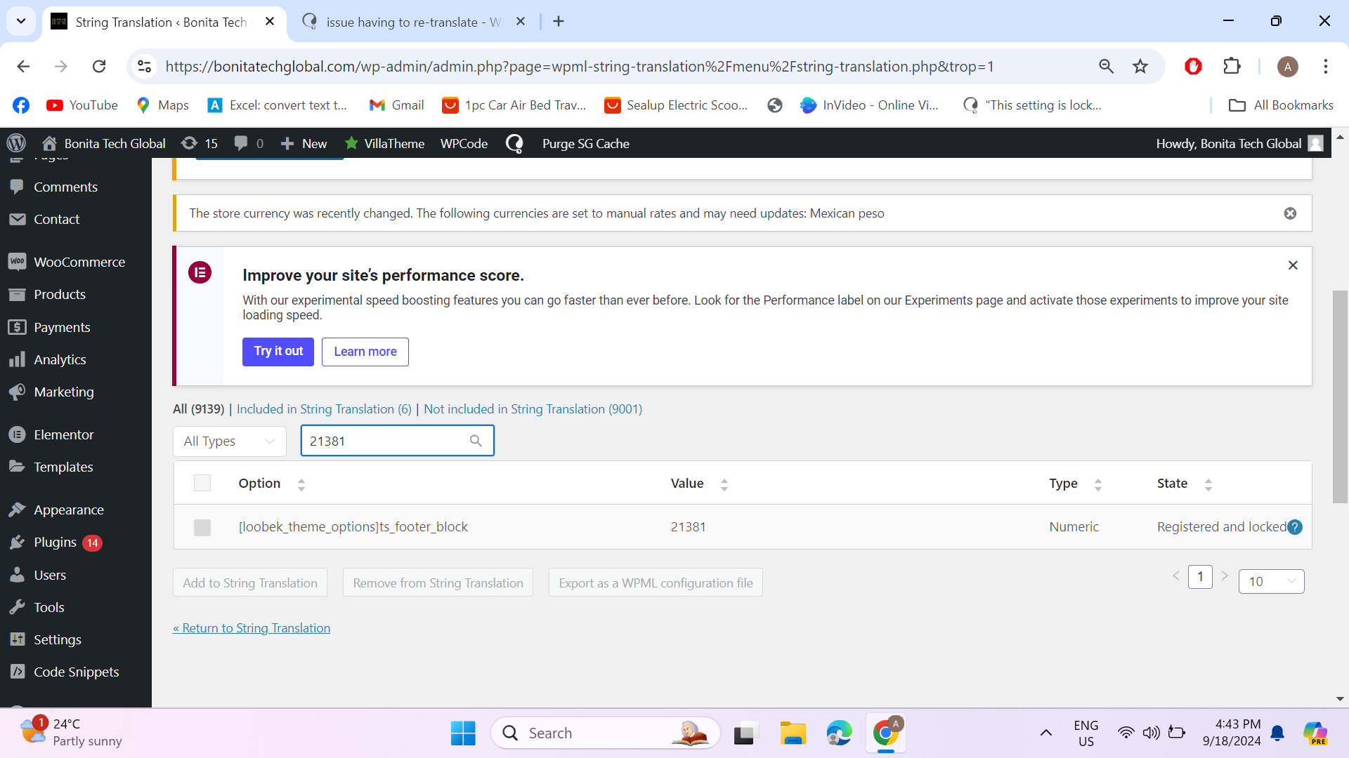

September 18, 2024 at 8:45 pm #16195437
abdullatifE
Hello Again,

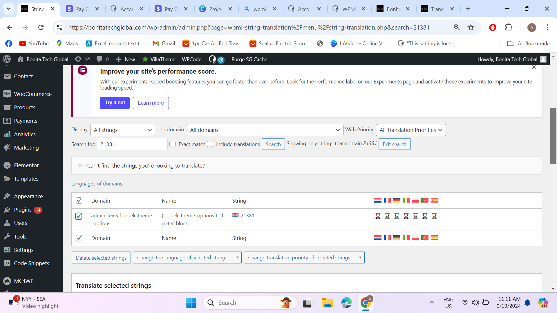

I had followed the steps and got stick on step 3.(Once the admin screen loads, enter the ID of the default template in the search box. If you find any entry containing the default ID, select it and add it to the string translation).
I had found the entry but couldnt select it because its locked!
i tried to troubleshoot it by looking at available threads on the wpml forum but still stuck on it.
Kindly recommend how to move forward with this!
thanks,
September 19, 2024 at 3:51 am #16195857
Prosenjit Barman
WPML Supporter since 03/2023
Hi There,
Thank you for the update.
The lock icon means that the string is already registered for translation. Now, go to WPML > String Translation and search for the ID. If it appears in the results, add the ID of the translated footer block.
Ensure the source language for the default ID matches the main language of your site. If it’s not set correctly, you can update it by following the instructions provided in this guide: https://wpml.org/documentation/getting-started-guide/string-translation/how-to-change-the-source-language-of-strings/
I hope it helps. Feel free to let me know if you have any other questions or need clarification. I will be happy to help.

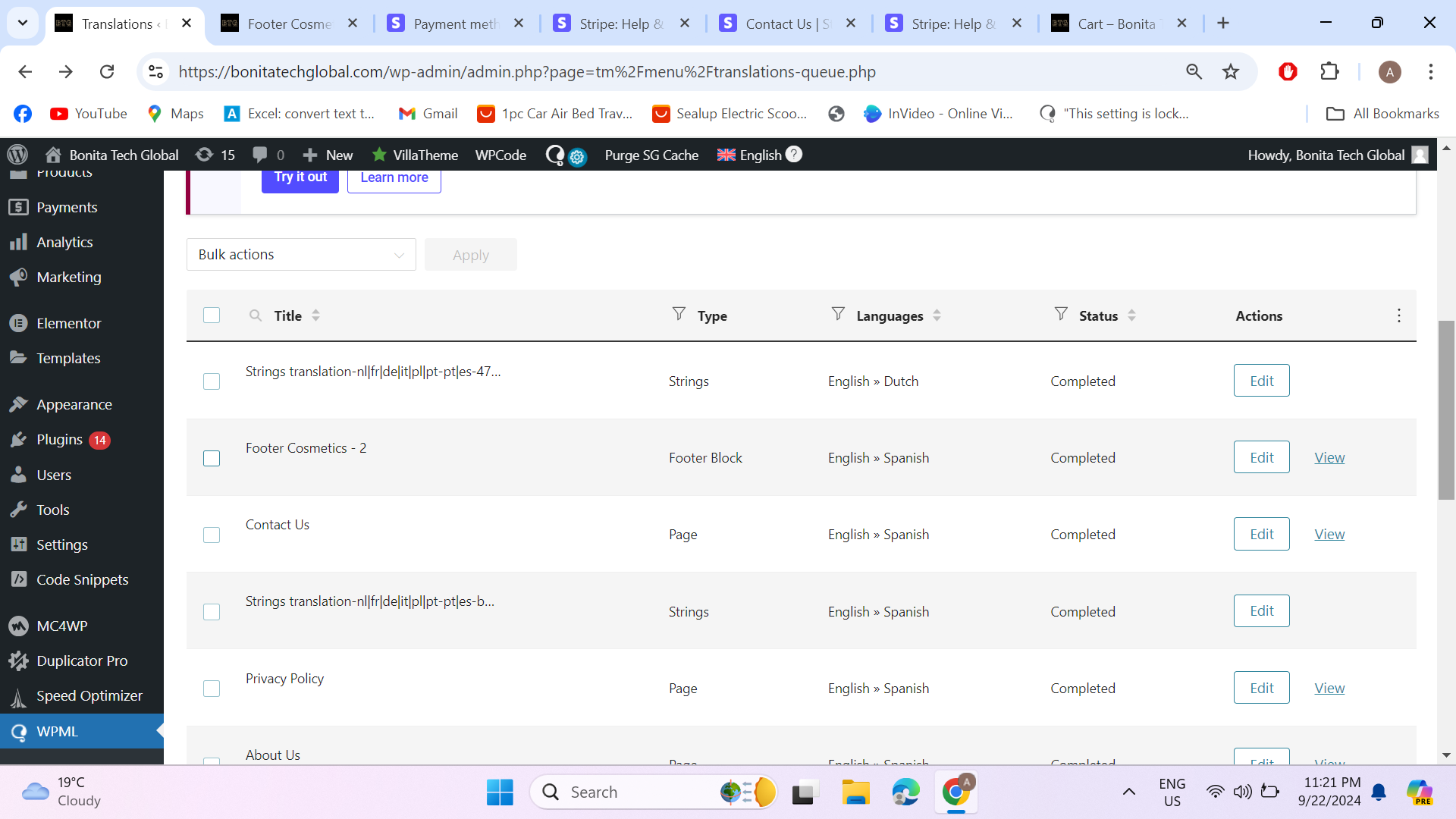

September 20, 2024 at 4:05 am #16201107
Prosenjit Barman
Hello There,
The reason the ID needs to be translated is to ensure that the correct template is loaded for each language. By translating the ID, we are specifying which template should be used in the other languages.
The reason you’re seeing "Waiting for translator" is because the strings have been sent to a translator for translation. You can now go to "WPML > Translations" to take and translate the string, or you can cancel the string translation jobs by clicking the "Trash" icon from the WPML > Translation Management > Jobs tab(Strings should be marked as "string").
After canceling the translation job, you'll see the "+" icon, allowing you to add the translation in String Translation. It’s recommended to cancel the jobs and translate the ID directly from String Translation for a smoother process.
Please let me know how it goes. I will be happy to help if you need further assistance in this matter.
Prosenjit

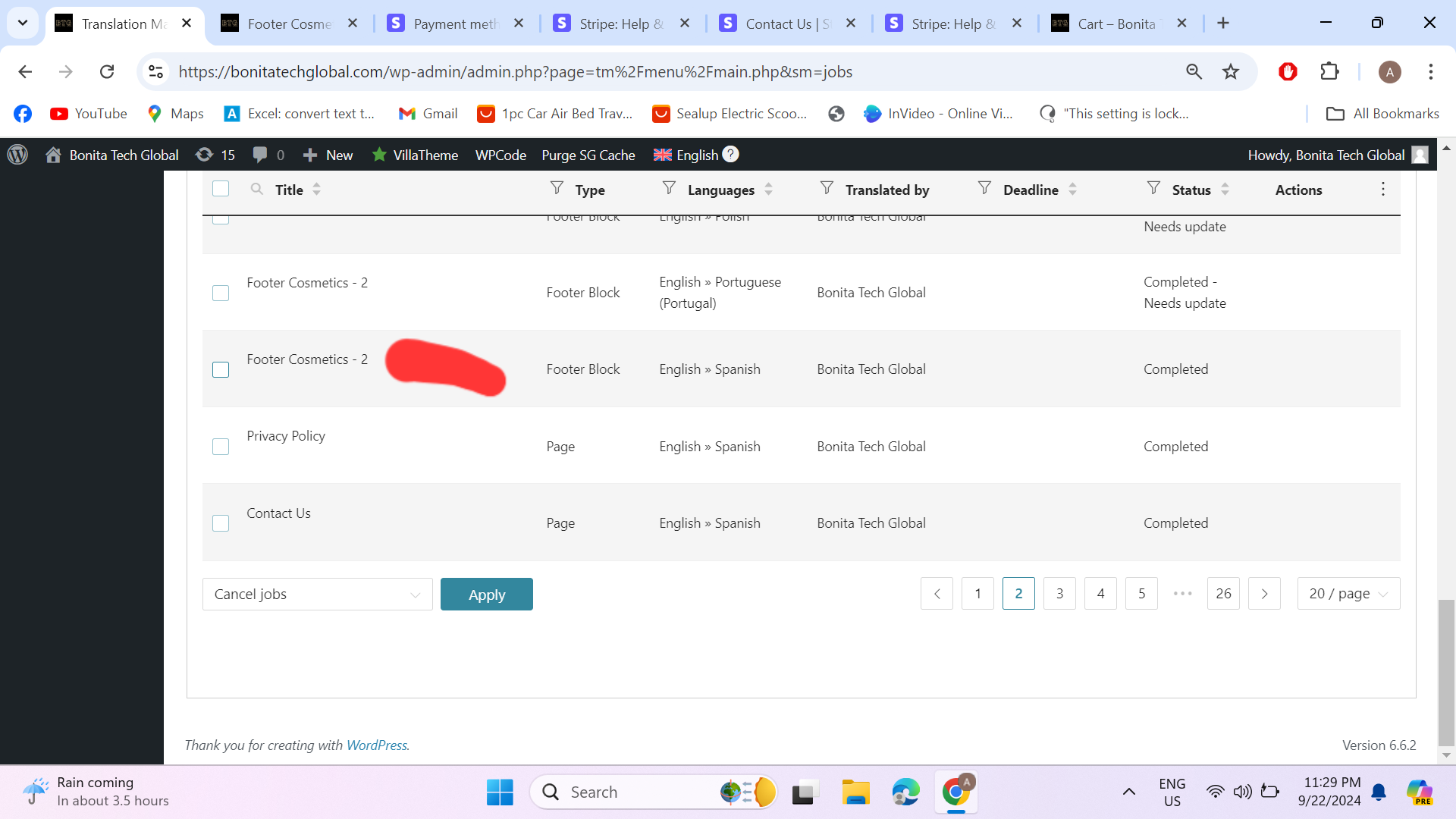

September 23, 2024 at 4:04 am #16207222
abdullatifE
Kindly check the attachments below ( in jobs tab and un string translations). Both were completed and no trash icon next to it since its completed!
