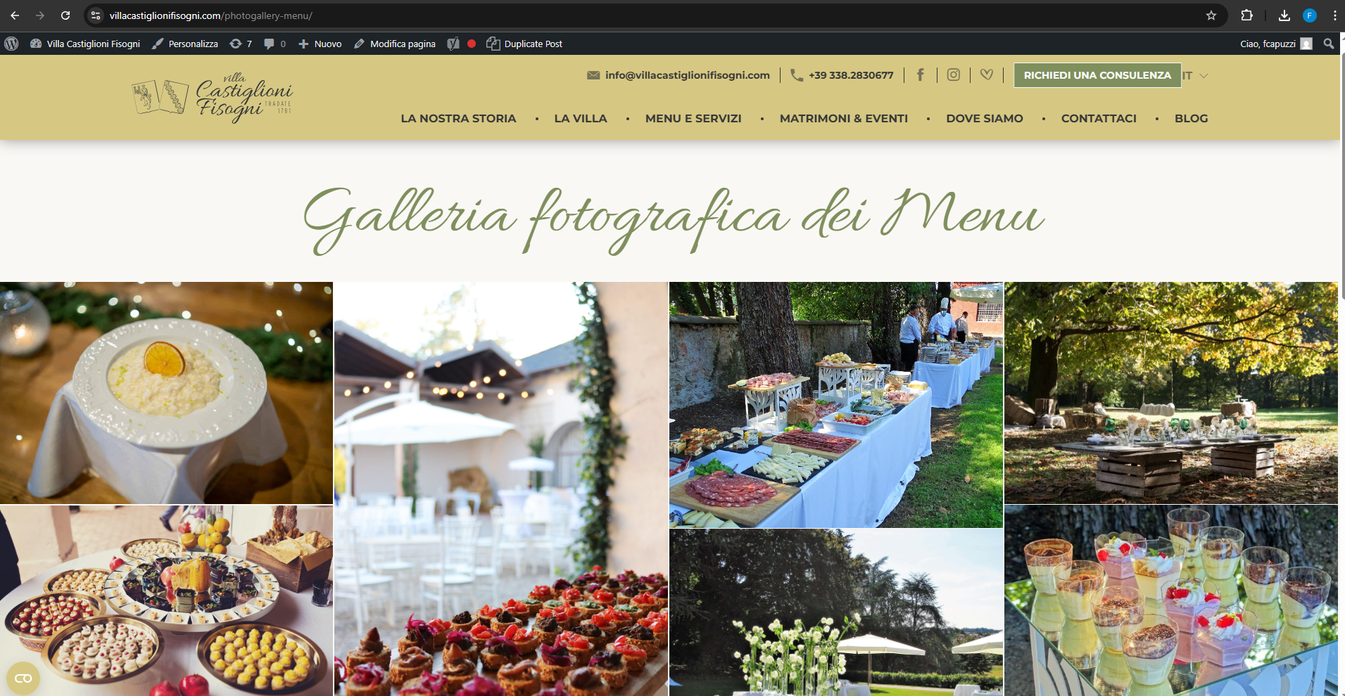

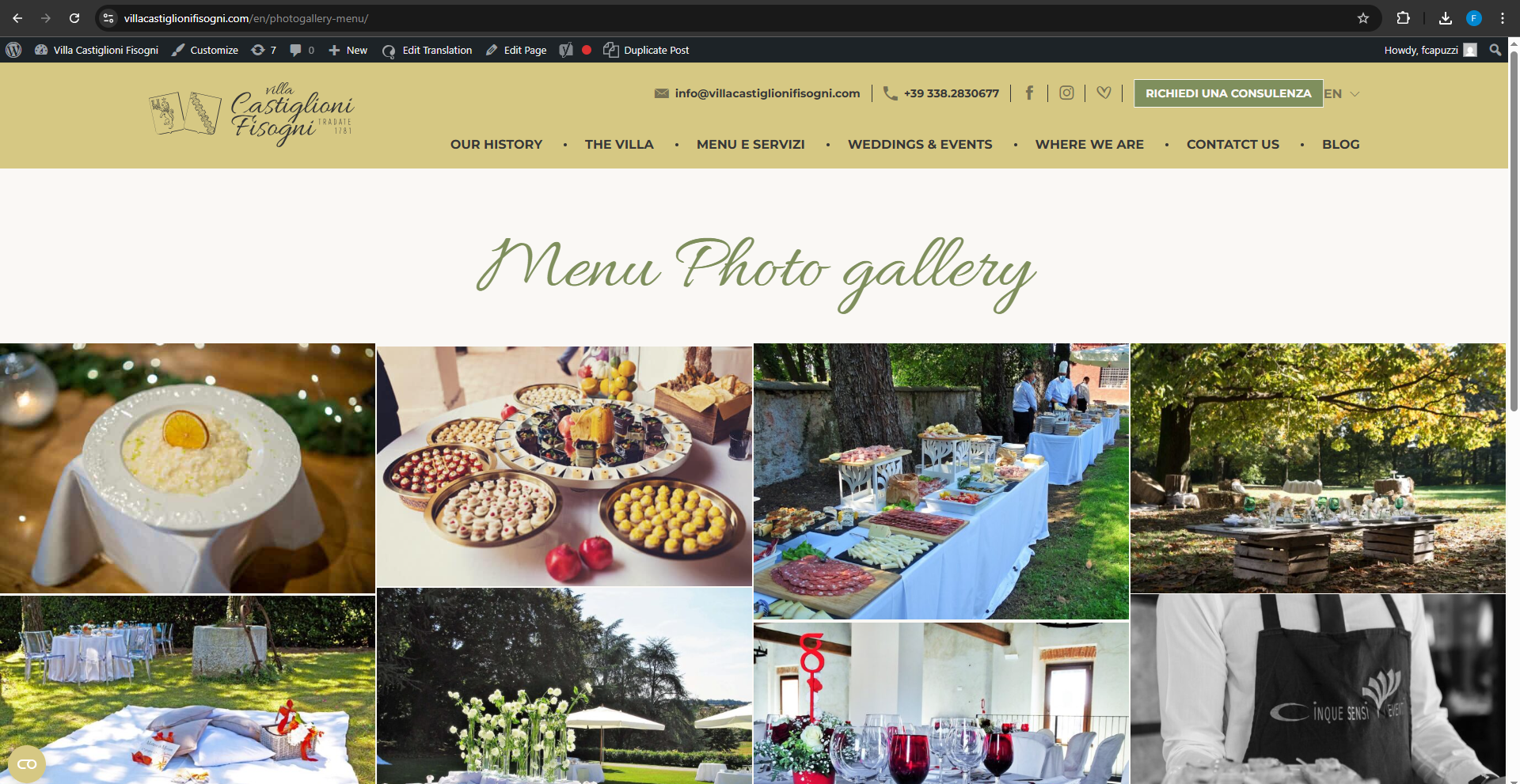

I am trying to fix the image ordering in two ACF galleries on the English version of hidden link and hidden link. The correct order is shown in the original Italian version and also in the Japanese version. The English page is visible only when logged in as admin.
Images in the English version of the galleries appear out of order. The issue seems to be related to WPML not properly syncing the image order field between translations.
Why is the image order not syncing correctly in the English translation?
How can I ensure the image order in the English version matches the Italian and Japanese versions?
