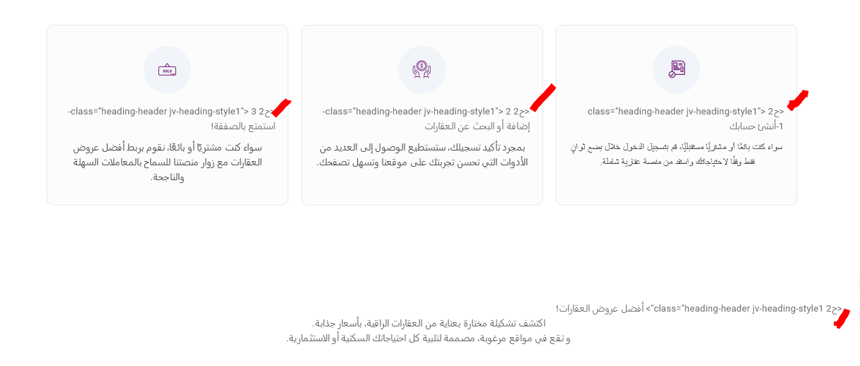

I have a problem with arabic translation after a auto translation for Home page from english to arabic, the html tag translatated also from "<h2>" to "ح2" and this makes a problem in Front-end
The problem came out just two days ago and it wasn't before.
And The home page in English sometimes appears in Arabic.
Any solution please?

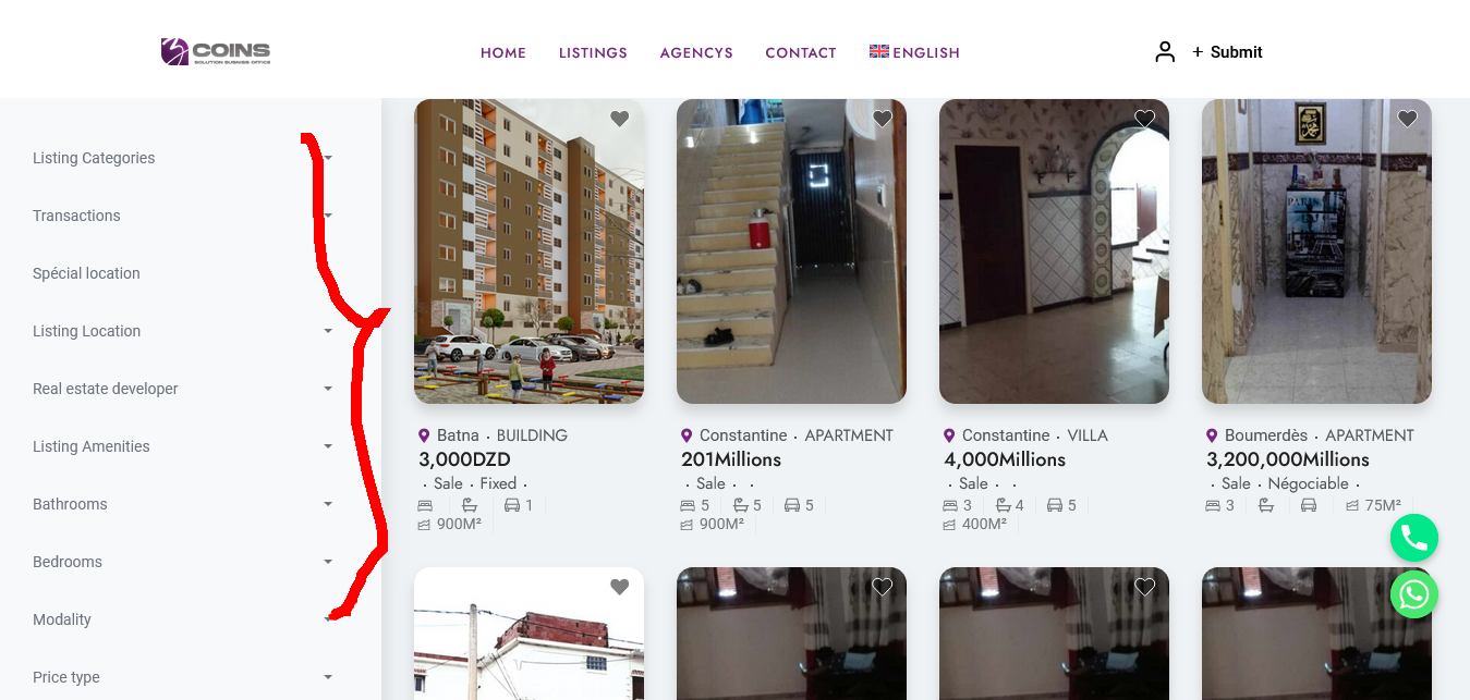

Thank you for your answer, the problem is not in Javo house theme, because Everything was working fine until the last week cleared up this problem, and some traduction stirng deleted as sidbar menu in listing page :
and we can't translate it,
any solution ?

2) These strings can be found and translated via WPML-> String Translation. For example, the "Listing Categories" string can be found here. (hidden link)
Osama

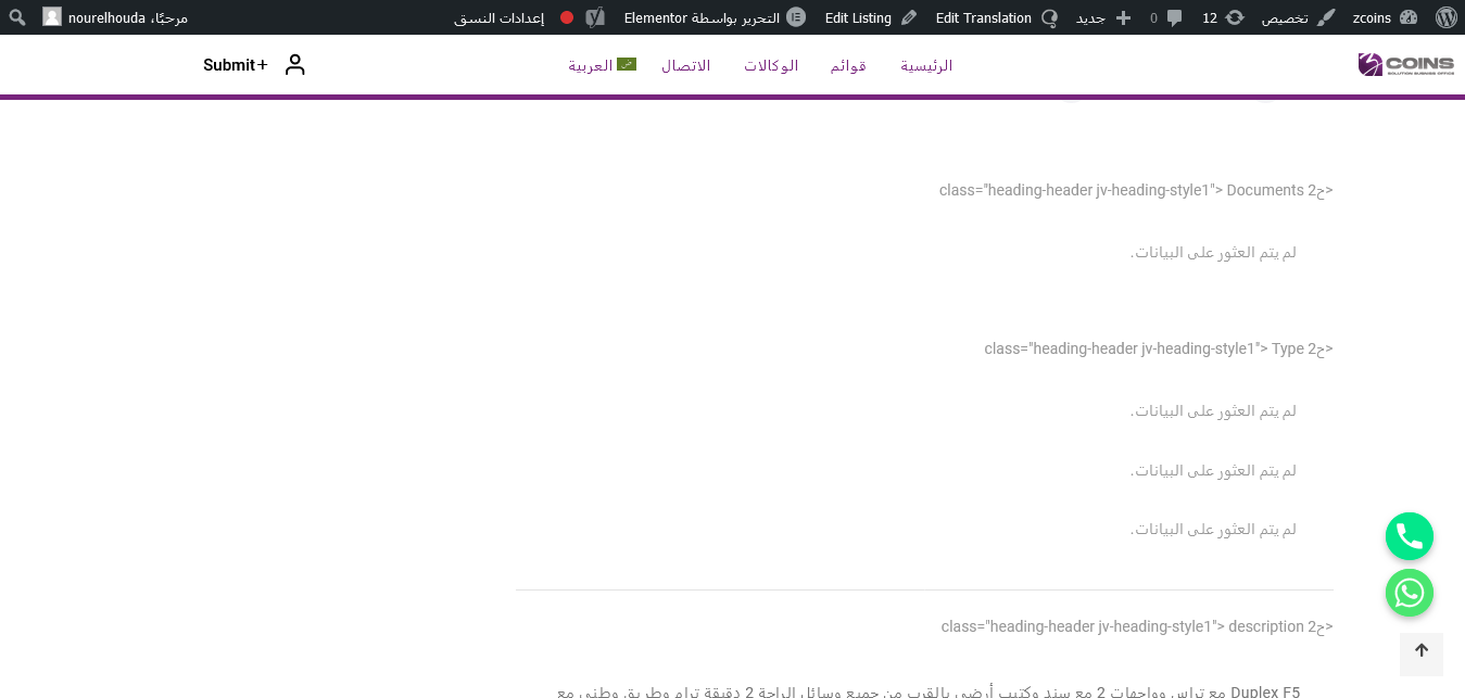

the same problem here withe titles

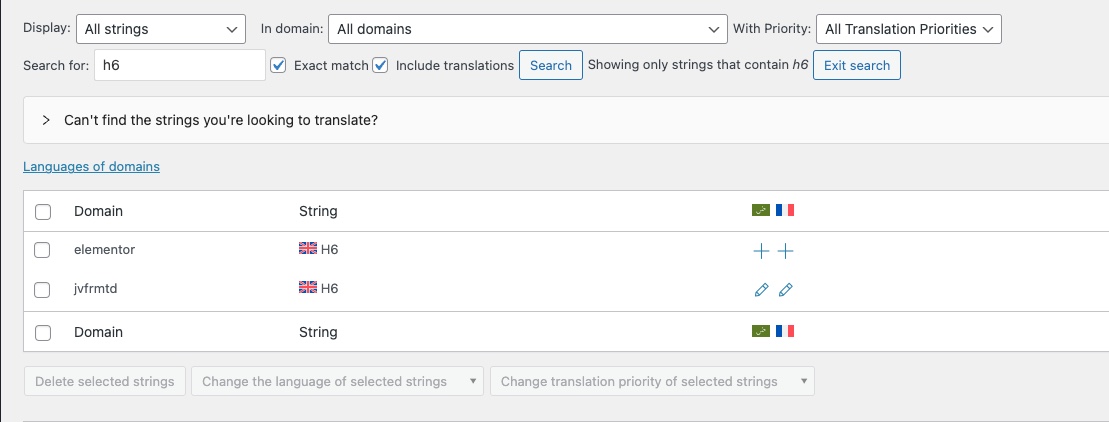

When checking the issue on this listing page, I found what caused the issue. The <h> tags were translated in String Translation, which caused the issue. (Kindly check the attached screenshot)
After deleting these translations, the strings appeared correctly. Would you please check them and let me know if they work as expected?
