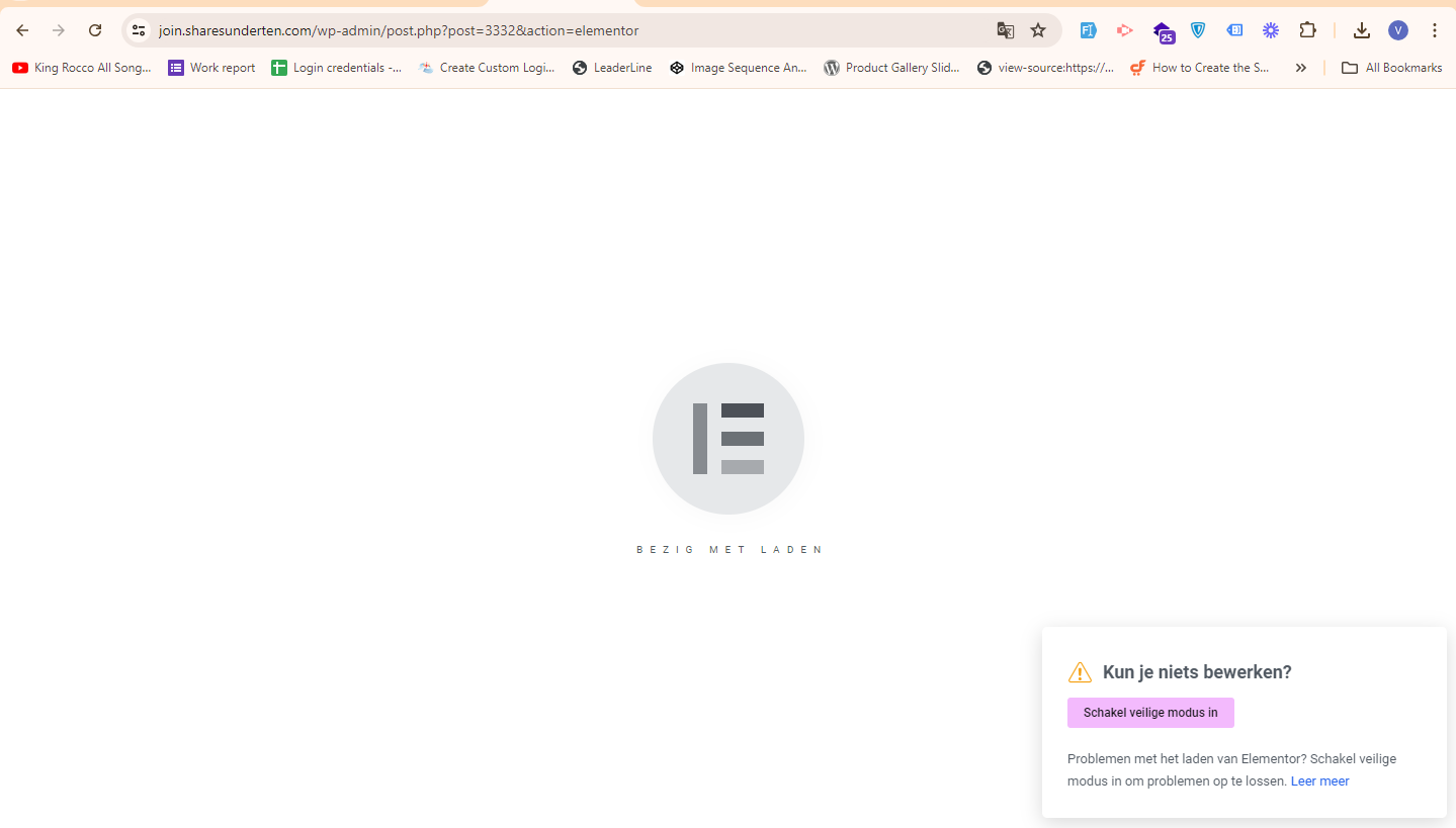

I have an existing website built using Elementor, and recently I installed the WPML plugin to enable multilingual support, specifically for Dutch language. Despite troubleshooting by deactivating all other plugins and reverting to a default theme, the issue persists. Interestingly, when I deactivate WPML, Elementor functions correctly again. Website URL: hidden link Username: [Removed by WPML Support] Password: [Removed by WPML Support])
<b>Symptoms: </b>
Elementor is no longer loading properly after installing WPML, making it impossible to edit or manage the site’s content through Elementor.

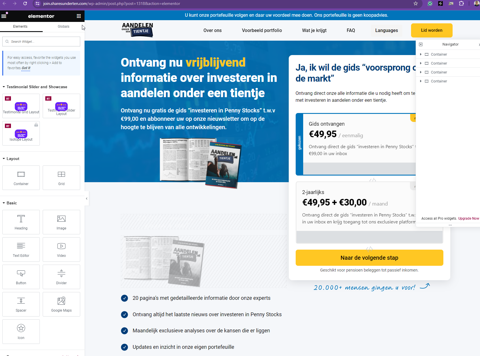

WPML Supporter since 08/2022
Thanks for your reply.
I've checked this page hidden link and I'm able to edit the page using elementor without issues as shown in the attached screenshot.
May I know which page are you working on?

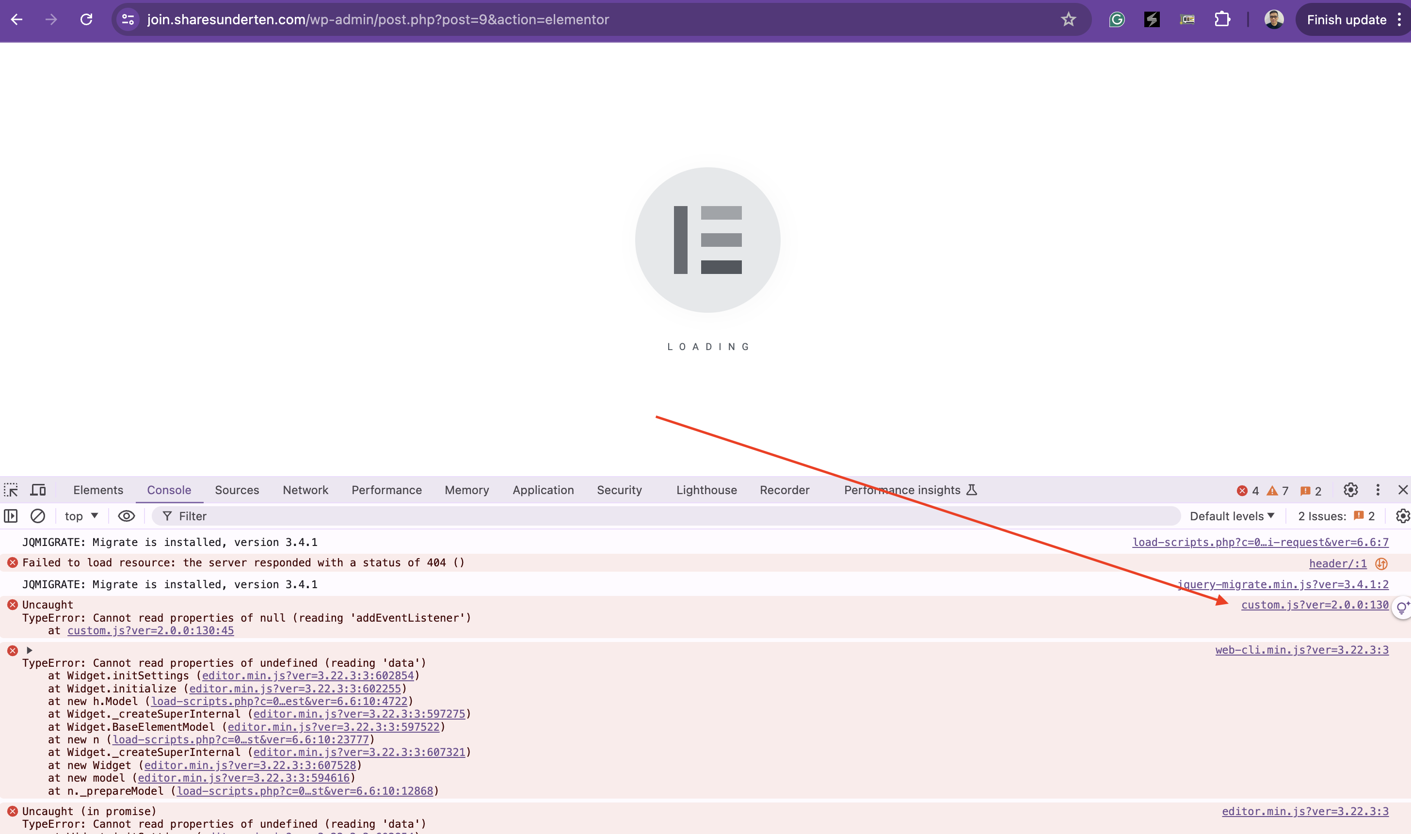

I've rechecked and it looks like the issue is coming from the child theme "Hello Elementor Child". Switching to the parent theme "Hello Elementor" fixes the issue. Upon inspecting, it looks like some code in the "Hello Elementor Child" theme custom.js is causing the issue as shown in the attached screenshot.
Could you check with your theme developer?
