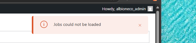

I was trying to view a list of online active jobs on my website. You closed the ticket, which is not ideal since we don't work on the website every day. The issue can be seen at this link: hidden link.
Jobs could not be loaded.
I found out why, the database was corrupted because a Post set to have its excerpt translated had a blank entry and as per debug
"[01-May-2025 13:42:04 UTC] PHP Fatal error: Uncaught DivisionByZeroError: Division by zero in D:www.albioneco.co.ukdev_htmlwp-contentpluginssitepress-multilingual-cmsclassesAPIRESTjobsclass-wpml-tm-rest-job-progress.php:41"
It looks like your code is trying to translate something which isn't there and fails

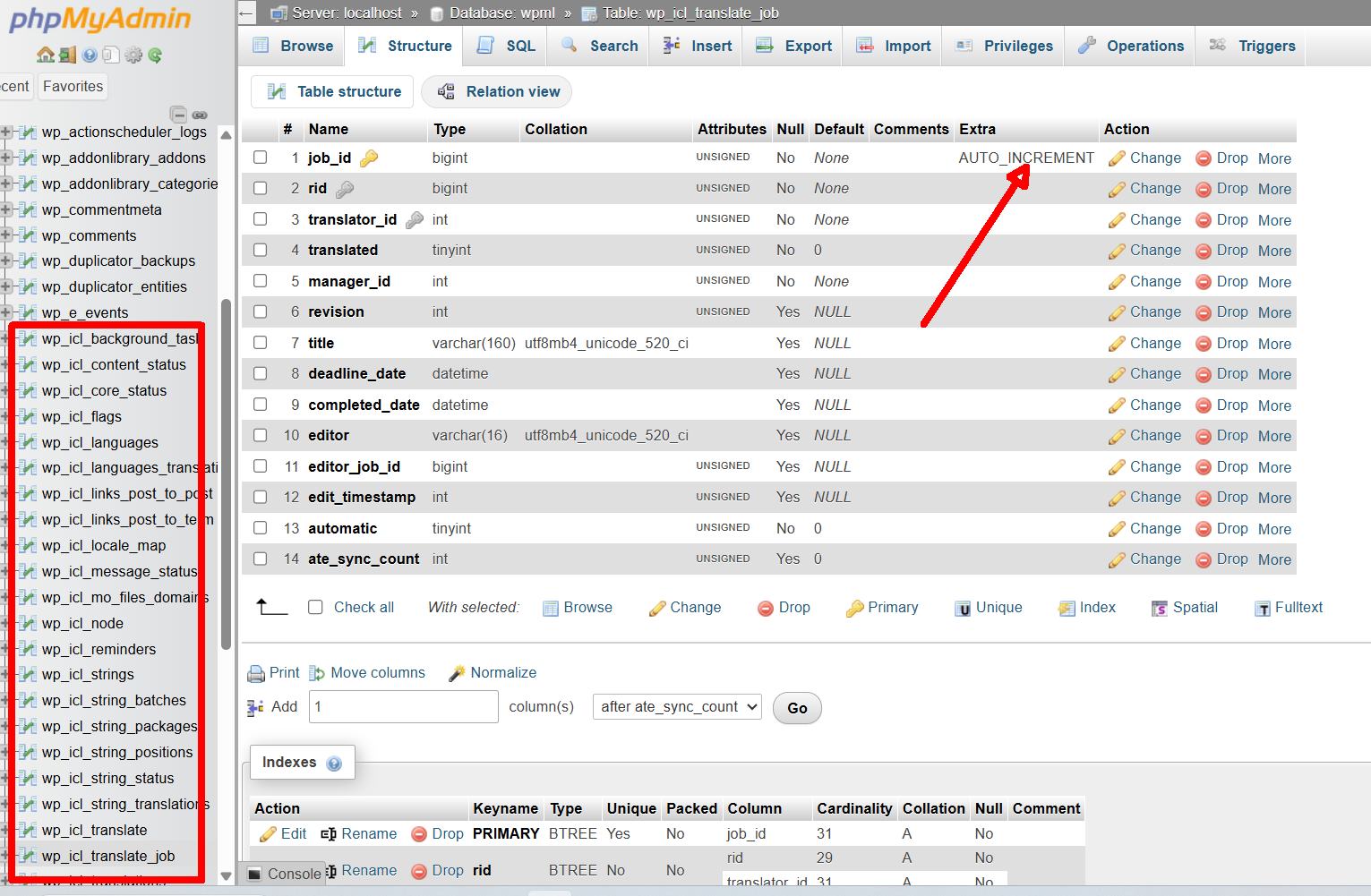

Can you run this SQL to confirm that WPML tables have proper auto-increment on ID fields?
SHOW CREATE TABLE wp_icl_translation_jobs;
SHOW CREATE TABLE wp_icl_translation_status;
SHOW CREATE TABLE wp_icl_translations;
etc.
Look for AUTO_INCREMENT on fields like job_id, id, etc.
Let us know what you find and we can assist further if needed.
May 6, 2025 at 8:47 am #17000296
paulT-50
`wp_icl_translation_status`
rid Primary bigint(20) No None AUTO_INCREMENT
`wp_icl_translate_job` SHOW CREATE TABLE wp_icl_translation_jobs; doesn't exist
job_id Primary bigint(20) UNSIGNED No None AUTO_INCREMENT
`wp_icl_translations`
translation_id Primary bigint(20) No None AUTO_INCREMENT
I still think it has more to do with the fact that the item it was trying to translate was empty ""
Until we added an excerpt - see attached image the jobs list crashed
