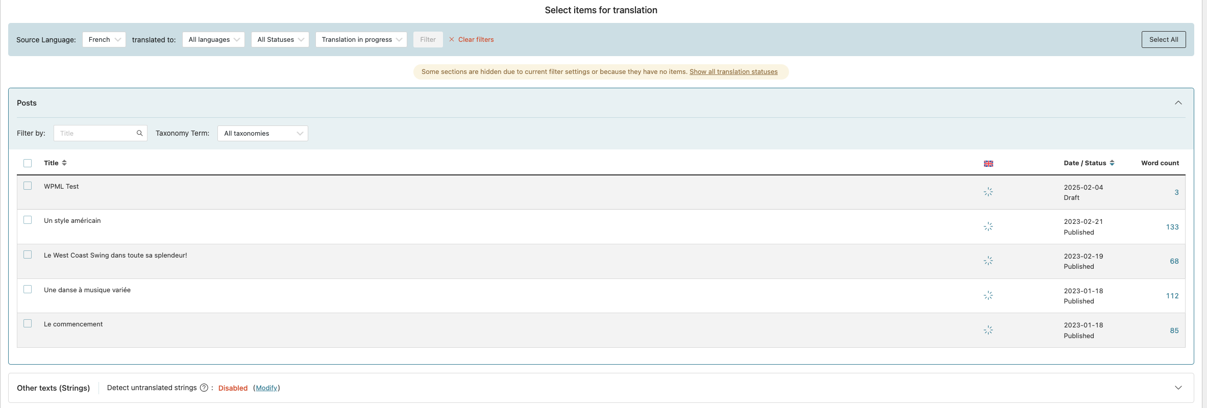

Ok so I did clear the lines with a status of 9 in the wp_icl_translation_status table but the translations are still not completing (and they are still visible).
