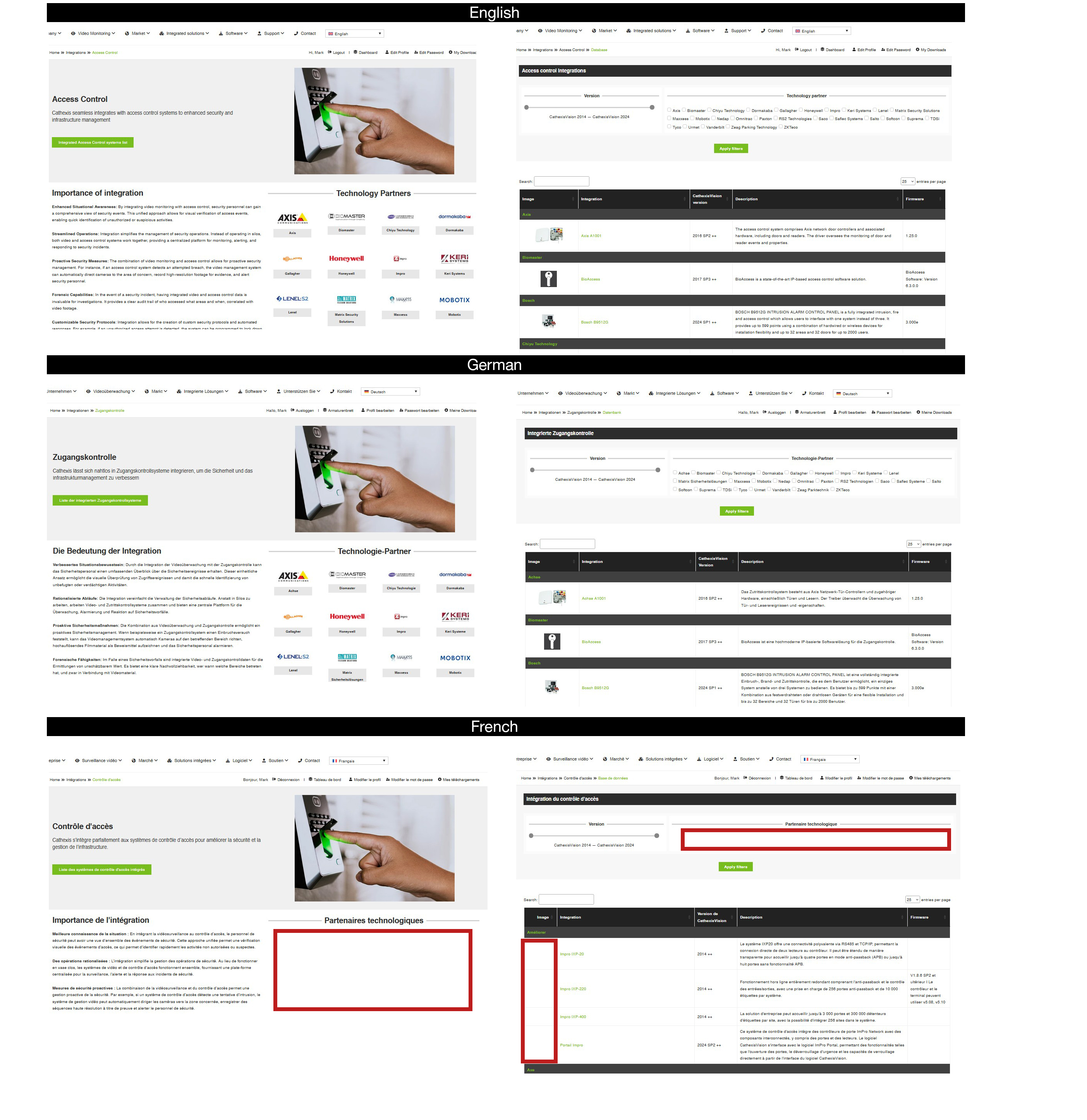

I am using JetEngine custom post queries on a site under development. The queries work for some languages but not others. For German, Spanish, and Russian, the queries fetch the correct posts. However, no posts are fetched for French or Italian translations. Example URLs: hidden link and hidden link. You will require a login to view the page. See the attached screenshot. I am following this documentation: hidden link
JetEngine custom post queries are not fetching posts for French or Italian translations.
Why are JetEngine custom post queries not fetching posts for French or Italian translations?
How can I ensure that JetEngine custom post queries work for all languages, including French and Italian?

I've investigated in much detail and looks like the problem is with only Italian query for these tech partner posts. For example, even if you check the archive itself at hidden link, you'd notice that it returns nothing for Italian (not even by changing the selection - checkboxes). However, if you switch to any other language, for example Spanish (hidden link), it works just fine.
I've tried many things, including deleting Italian translation for the loop item and translating again, checking query in detail and relevant settings/configs.
I need some more time, so I can reproduce it in another environment and check with my team. I 'll get back to you on Monday.

Thank you for your patience and cooperation.
I investigated further and tried to reproduce the problem in my local without any luck.
So I've prepared a fresh sandbox site at hidden link (one-click login). Here I've added your theme, related plugins, Tech Partners post type and taxonomies with a few sample ones (and translated).
I've tried my best to replicate the basic setup as your staging site. However, I'll request to create those queries and templates to reproduce the problem.
And meanwhile you do it, please note down the steps for me, so I can then retry and understand the difference. We'll also be able to understand if this issue is only happening in your site (i.e. a DB or environment specific) or can be reproduced elsewhere.
Please let me know when you're ready.
FYI, I installed a plugin in your site to enable download links for themes and plugins. So if you need to add any other plugin/theme, you can simply go to your Plugins or Themes page, click the download link and then upload the zip file in the sandbox by going to Plugins/Themes -> Add New page respectively.

I have checked the queries in different languages and they work.
It seems to be an issue with the way the Jetengine Listing Grid is calling the translated Listing.
