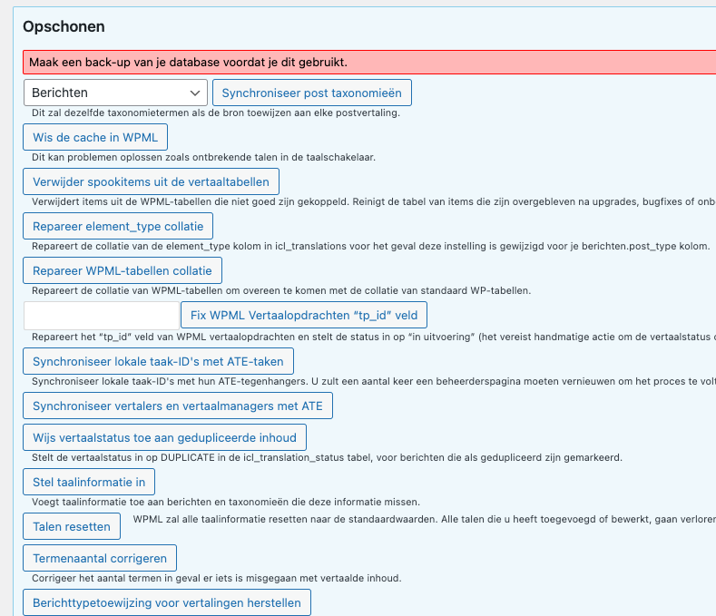

Thank you for the confirmation. One more request. Becuase it may help. Please try the following troubleshooting steps after a full site backup{mandatory} and make sure the issue exists or not.
1) Go to WPML>>Support page, click on the Troubleshooting link (blue link in the middle of the page)
2) On the Troubleshooting page, please click on the following options of the *Clean up* section. Wait for confirmation of processing after each one.
- Clear the cache in WPML
- Fix element_type collation
- Set language information
- Fix WPML tables collation
- Fix terms count
- Fix post type assignment
- Cleanup and optimize string tables
Thanks!
Bigul
June 17, 2025 at 11:22 am #17142060
jeffreyB-17
Hey Bigul,
Clicked all those options you mentioned and it didn't change anything.
Jeffrey

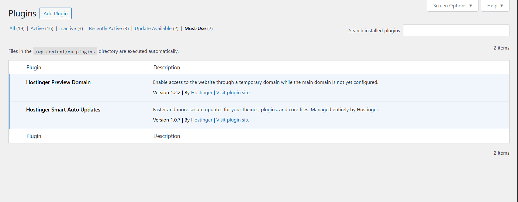

Just to confirm, is the live site hosted on One.com? If so, we noticed two must-use plugins from Hostinger in the live site, which could be causing a conflict.
Please try the following steps after a backup, and let us know your feedback:
- Remove those Hostinger MU plugins from /wp-content/mu-plugins/.
- Clear all types of caches (browser, server, plugin).
- Check if the issue still exists.
Refer to the attached image for more details.
Thanks!
Bigul
June 20, 2025 at 8:35 am #17153375
jeffreyB-17
It works! Thanks Bigul, now only the other problem is left. But that's in the other chat.
