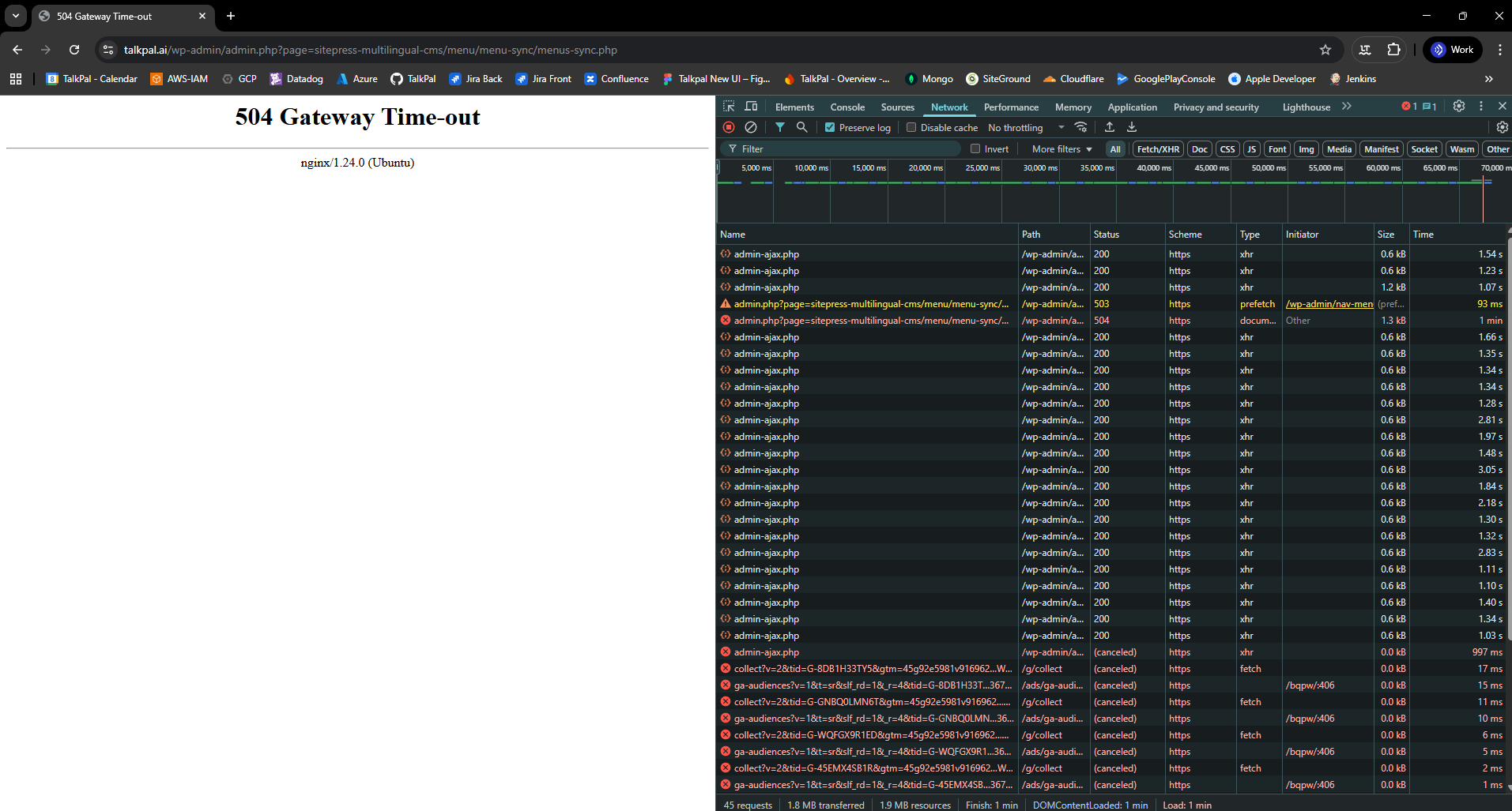

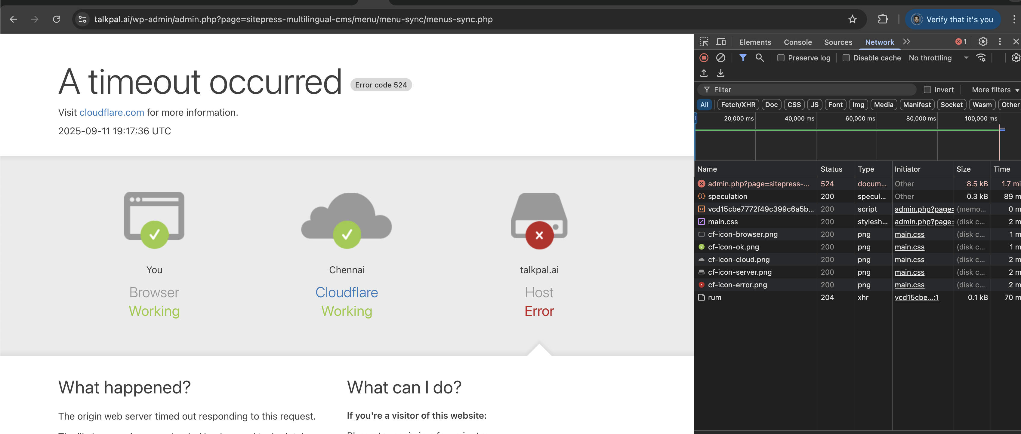

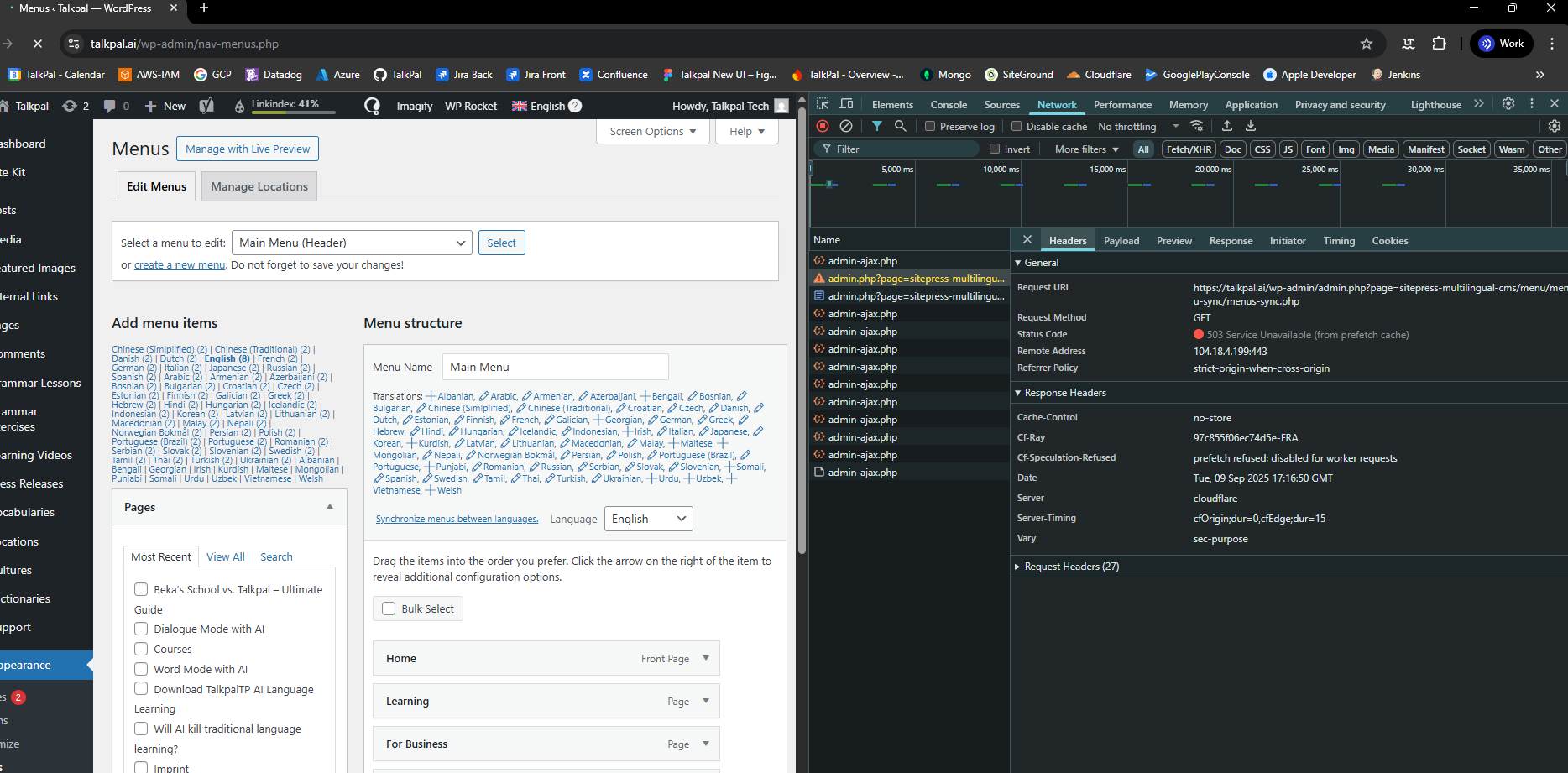

Hello Bigul, firstly thanks for your help, there are some infos:

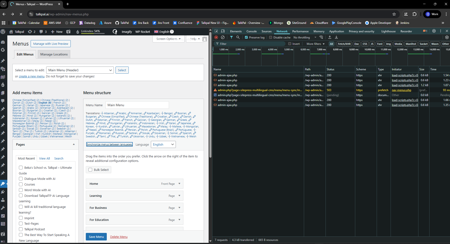

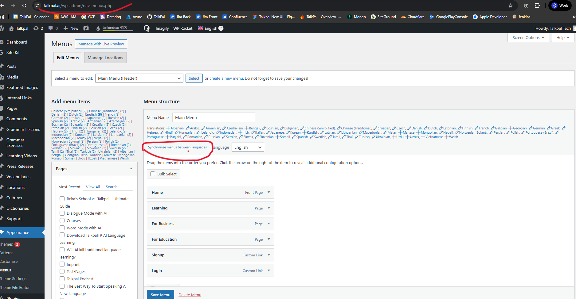

1. See screenshots, 1- when press "Synchronize menus between languages", 2 - result after 1 minute.
2. Nginx error.log and accress.log: hidden link

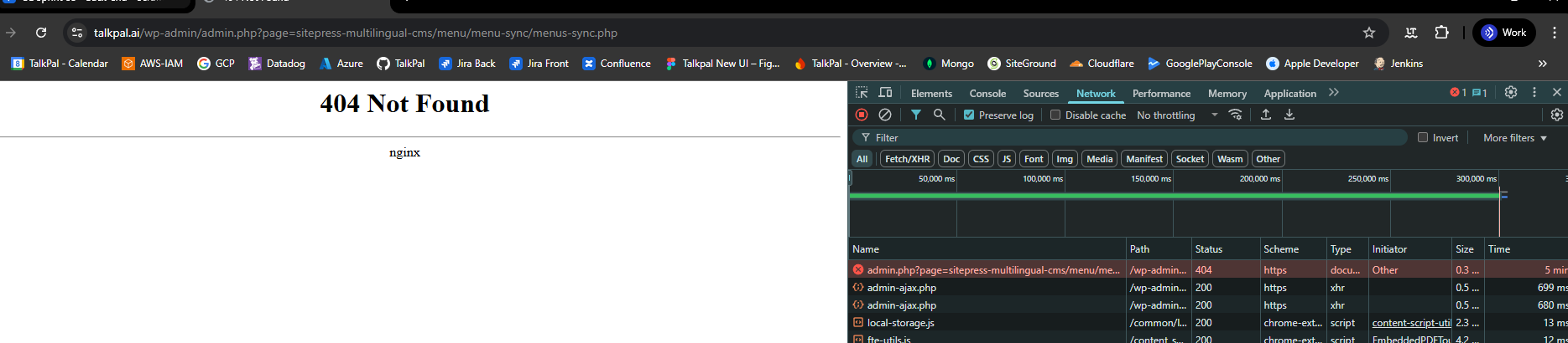

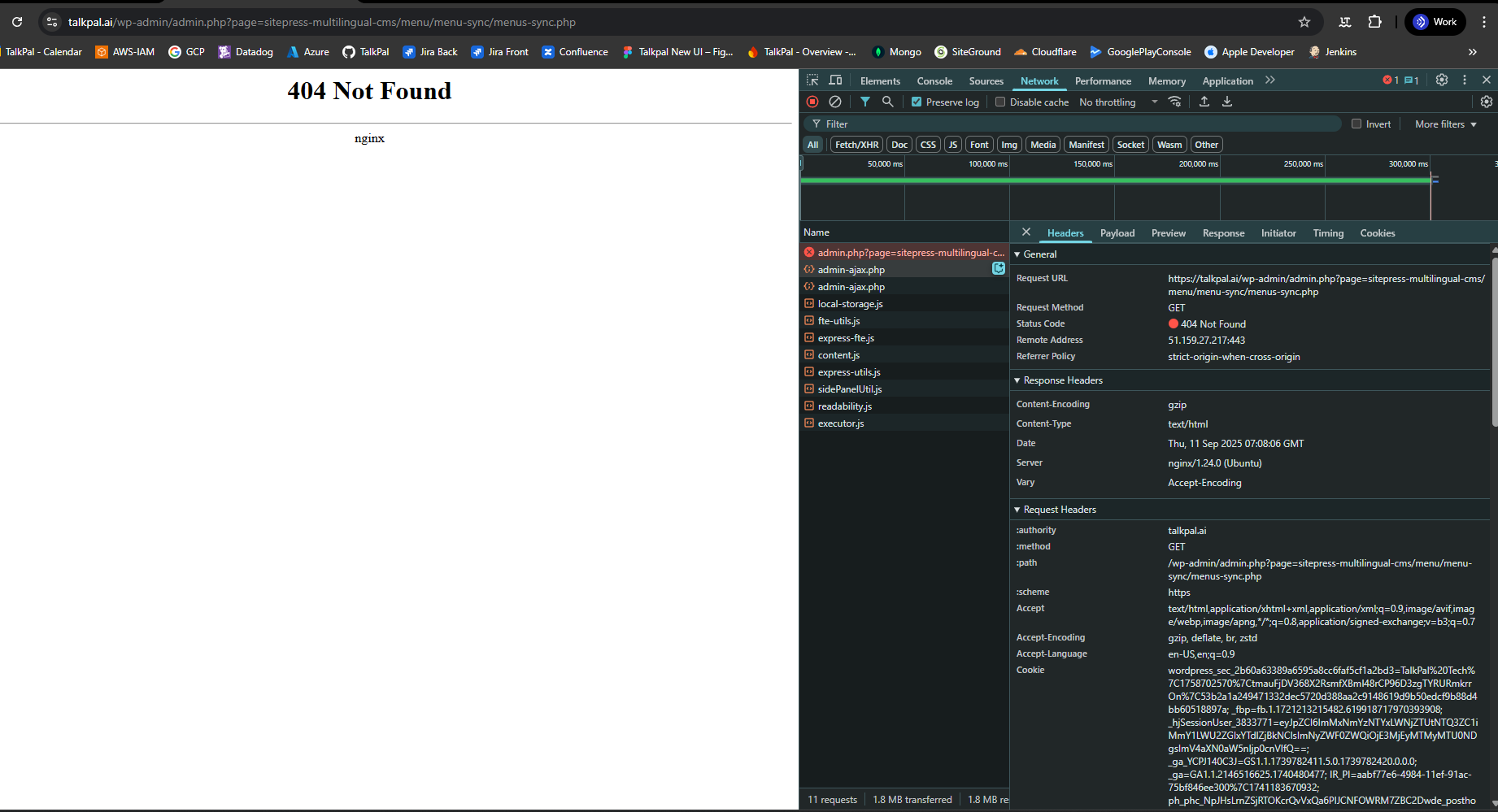

Also, one more thing, I increase fastcgi_read_timeout to 300s, now we have 404 error by nginx. Why this functionality need time more than 5 minutes?

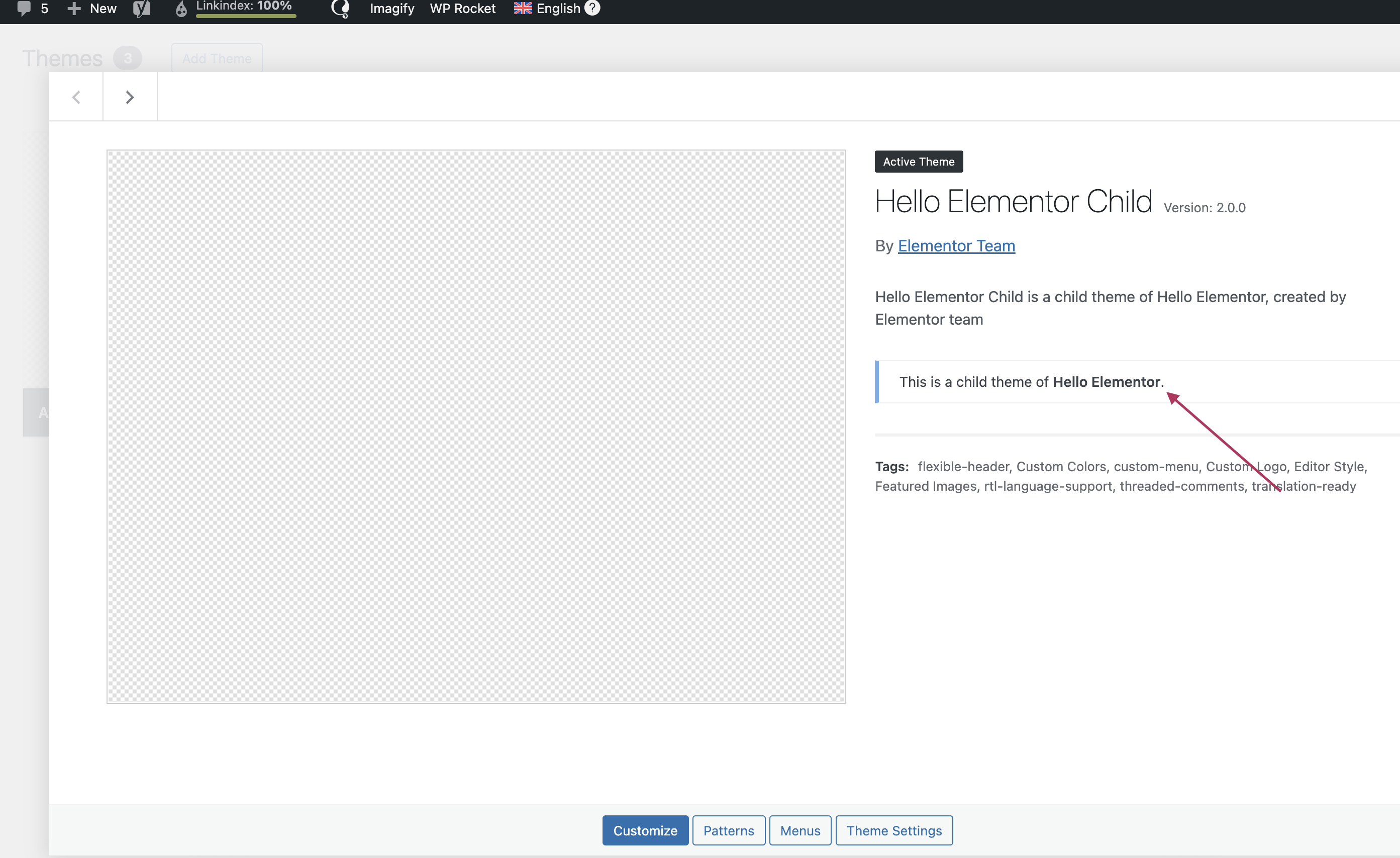

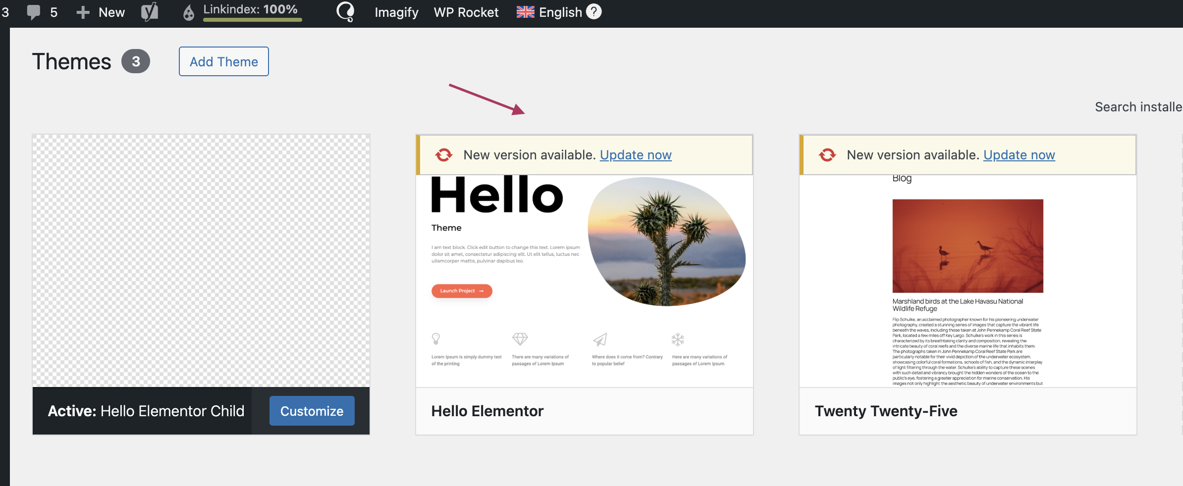

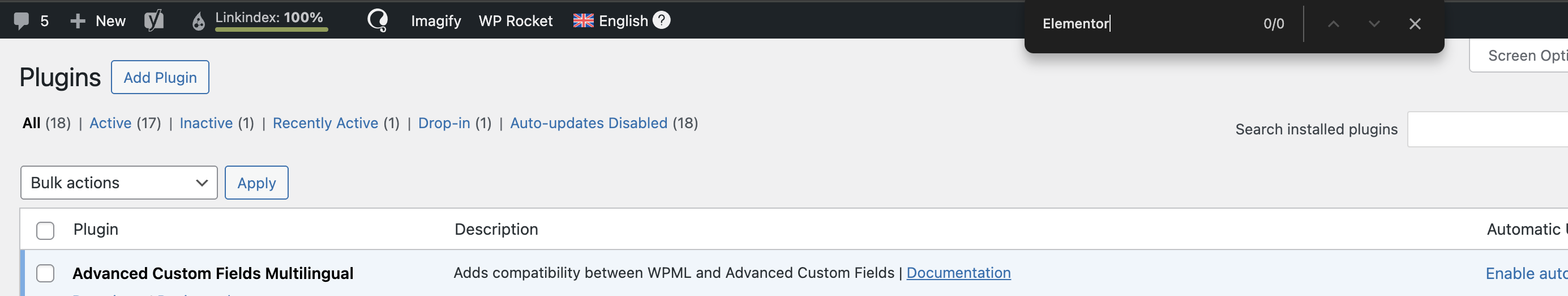

Have you used the Elementor plugin in the past? I ask because your site is currently running a child theme of Hello Elementor.
As the next step, please upgrade to the latest version of the Hello Elementor theme (after taking a full site backup) and check if this makes any difference in the results. Refer to the attached images for more details.

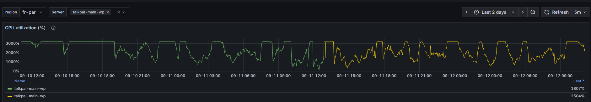

Quick follow-up with more data:

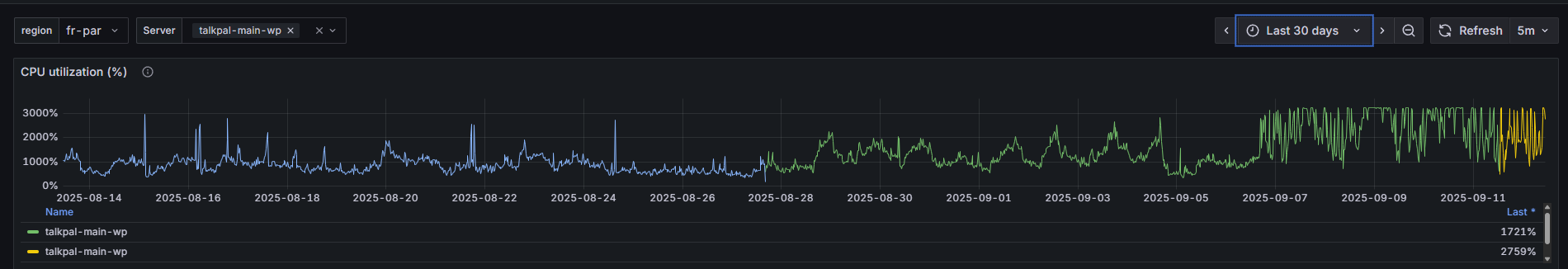

Attached CPU utilization for the last 30 days and last 2 days. There’s a clear step-change immediately after the WPML update.
We’re seeing periodic CPU plateaus that look like a scheduled task. Hypothesis: a WPML WP-Cron hook running too frequently or too long.
