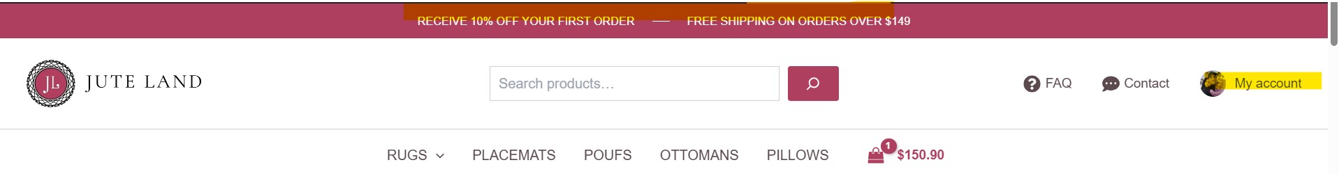

Issue is: translated content appears in the original language after I updated the theme customizer. Just check the marketing messages at the top of the website (free shipping + first order discount). It should be in english.

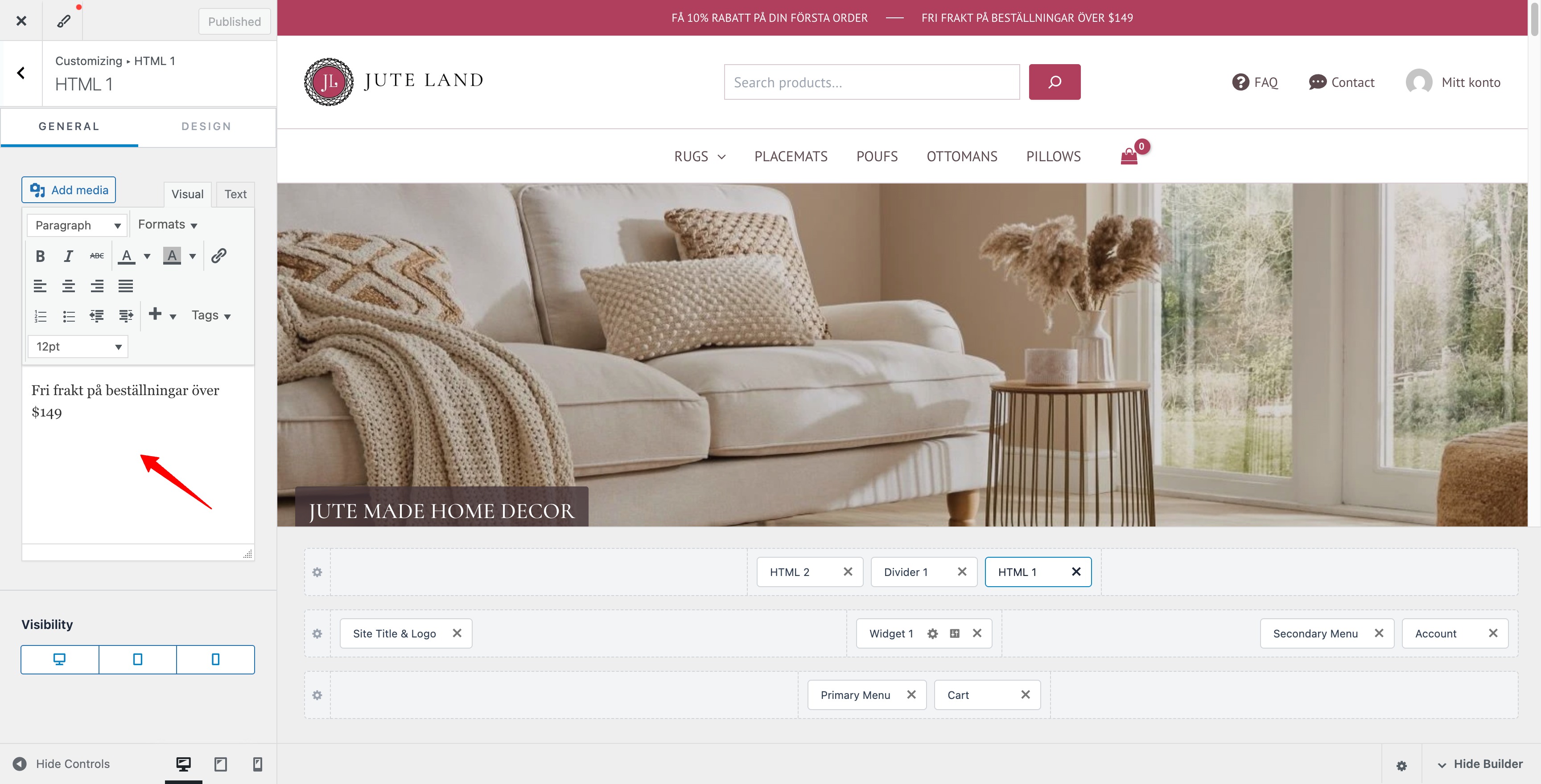

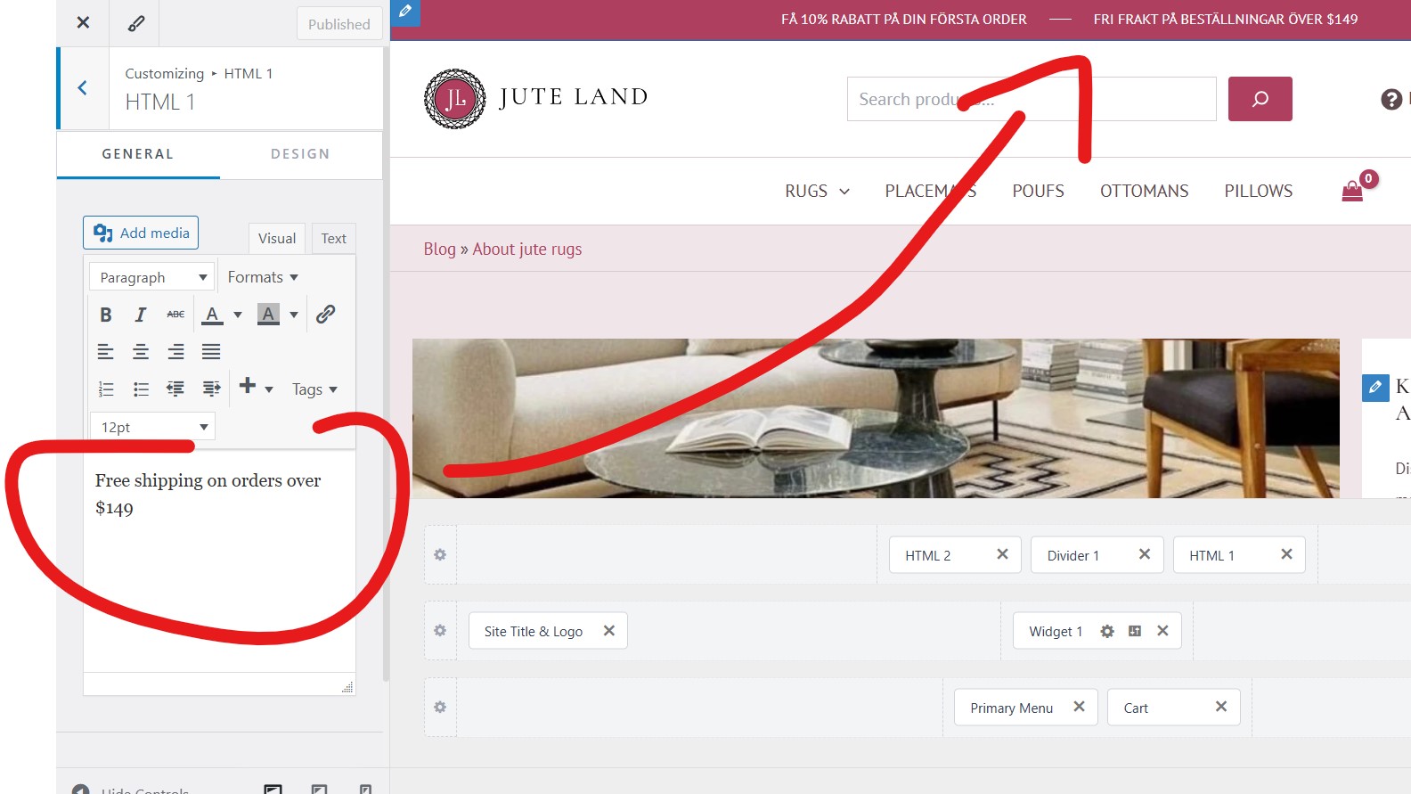

1/ Update theme customizer > Found TRANSLATED CONTENT on the website MAIN LANGUAGE > Update one more time the theme customizer to replace translated content with ORIGINAL LANGUAGE (English) > Found out that a new translation took place instead of the original language (first it was polish then in became swedish) > Contact you about the issue

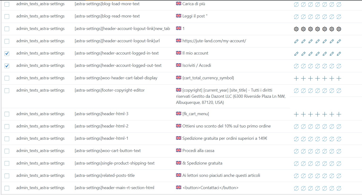

2/ Read your message > Check string translation page (the "read more" text from the blog)> Found this: english (original) is filled with dutch, and dutch (translation) is filled with english

GET RID OF THE TRANSLATED CONTENT ON THE WEBSITE MAIN LANGUAGE.
HOW TO DO THAT?

What it looks like on the wpml string translation page.
Italian language everywhere instead of english.
