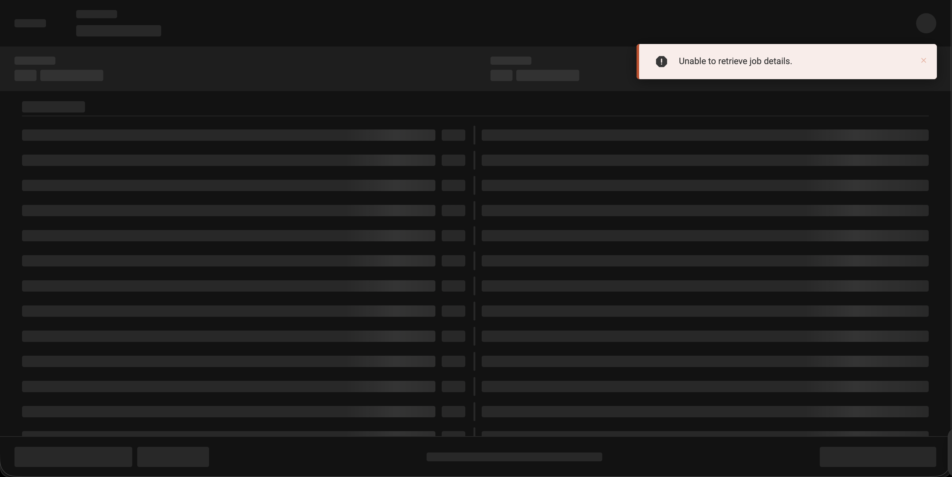

Some pages fail to translate automatically, showing an 'Unable to retrieve job details' error despite standard troubleshooting attempts.
The issue was caused by custom code added to the Astra Child theme used on the site. This code overrides part of our product’s core logic, preventing it from functioning as intended. As a result, switching to an alternative theme (or removing the conflicting customizations) was necessary to ensure full compatibility and proper operation of our product.

January 6, 2026 at 4:49 pm #17707336
dennisB-32
My site doesn't translate pages, and when trying to edit translations, I get this error: "Unable to retrieve job details."

January 19, 2026 at 3:59 pm #17743365
dennisB-32
Hi Diego
How to get this solved asap?
My client is expecting their WPML-setup to be working, and I reported this issue two weeks ago with a promise to get it fixed fast...
January 20, 2026 at 7:37 am #17744762
Diego Garcia
Hi Dennis,
Please accept our sincere apologies for the delay in resolving this matter. Despite extensive investigation, we have not yet been able to conclusively identify the root cause of the issue.
At this stage, we believe the behavior may be related to an issue we have previously identified when GZIP compression is enabled. We can confirm that GZIP compression is currently active in your Cloudflare configuration (as shown in the screenshot provided), and it is therefore likely that temporarily disabling this setting would resolve the issue.
However, in order to be fully certain and to conduct thorough testing, we would need to obtain a copy of the website for internal testing purposes. Alternatively, you may grant us permission to create such a copy on your behalf. This would allow us to proceed efficiently and work toward a definitive resolution as quickly as possible.

January 21, 2026 at 2:11 pm #17750791
Diego Garcia
Hi Dennis,
Thank you for granting us permission to create a copy of your website. We can now successfully reproduce the issue and are actively investigating the underlying cause.
While additional time is required to complete the analysis, please be assured that this matter is being treated as a priority. We will follow up with you as soon as we have further updates or a resolution to share.
Thank you for your patience and cooperation.
January 23, 2026 at 8:44 am #17756200
Diego Garcia
Hi Dennis,
Please accept our sincere apologies once again for the delay in resolving this case, as identifying the root cause required an extensive and detailed investigation.
We have now confirmed that the issue is caused by custom code added to the Astra Child theme currently configured on your site, which overrides part of our product’s core logic and prevents it from functioning as intended. As a result, using an alternative theme (or removing the conflicting customizations) will be necessary in order to ensure full compatibility and proper operation of our product.
