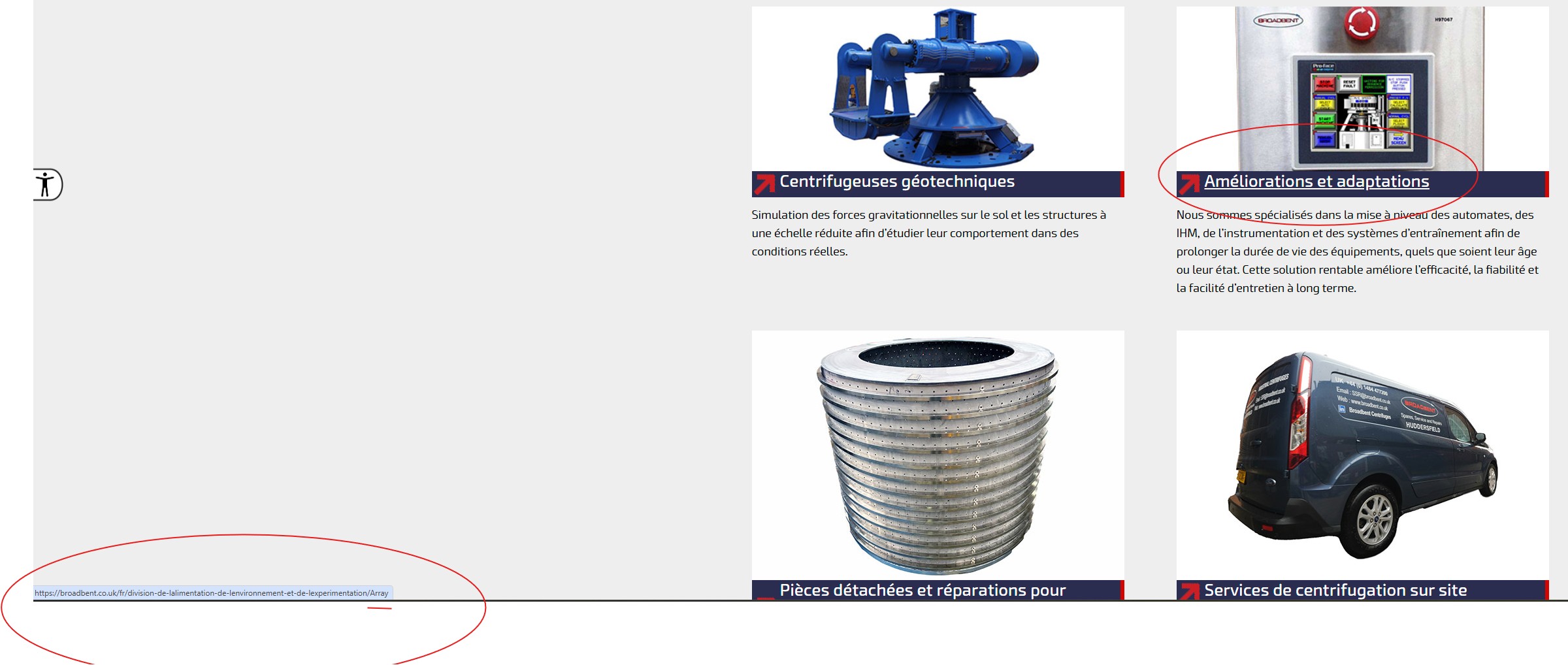

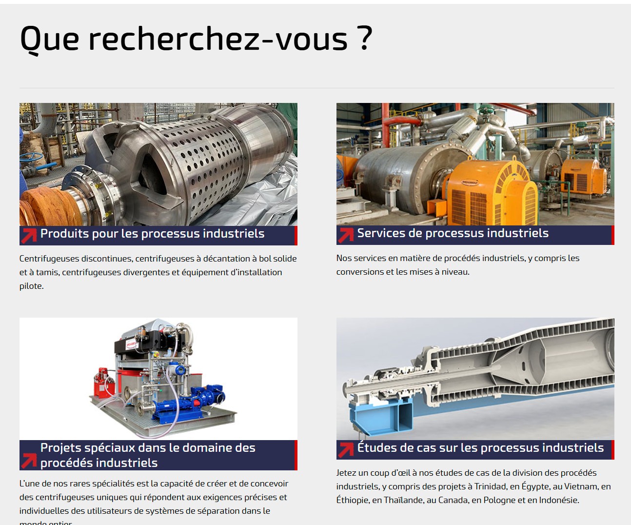

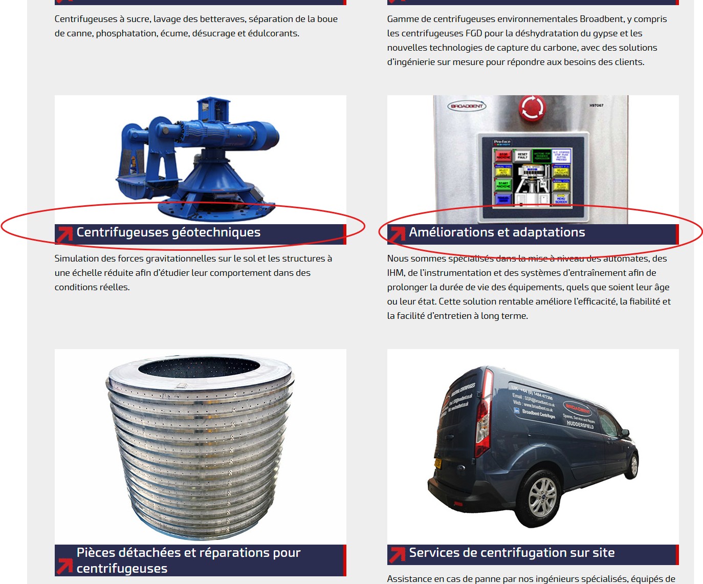

Please see the attached image: Division-link-not-correctly-fr-before-it.jpg
This shows the French version of the Divisions page with an incorrect link that doesn't have the /fr/ (Shown bottom left of the image as I hover over the link circled in red.)

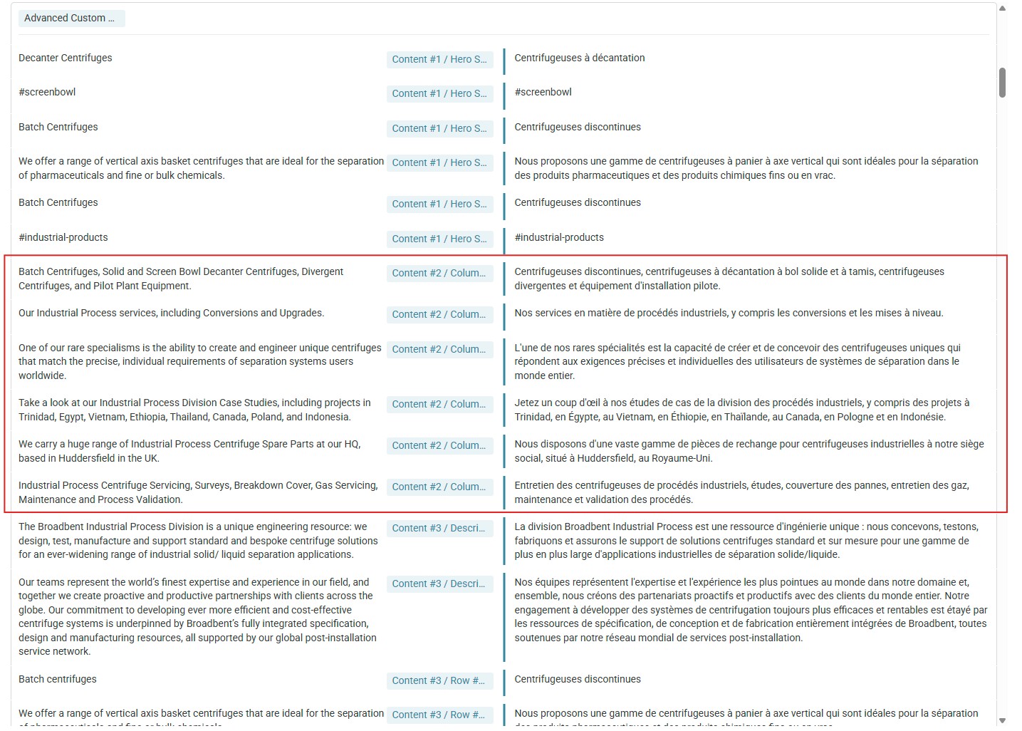

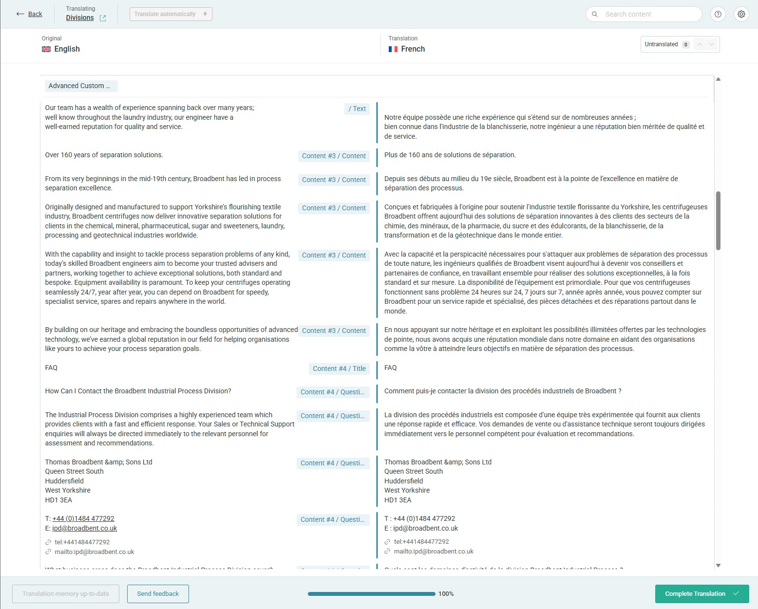

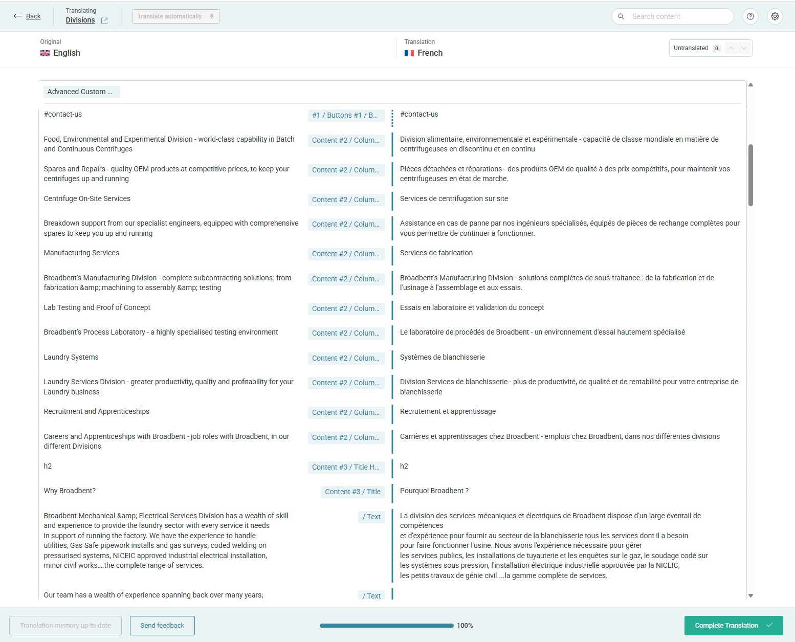

I have also attached 4 images: Division-in-wpadmin-link-not-showing-001.jpg onwards (There was no point in me showing you further down as 004 is at the FAQ point at that point at the bottom of the page.)
These are a screen grab of when I go into the WordPress Admin, click on Divisions in English and hit Translate.
As you can see, there is nowhere showing where I can see the incorrect link for this page of the page, and therefore nowhere for me to be able to manually change it to say /fr/division-des-procedes-industriels/ which is the French version of the links location.

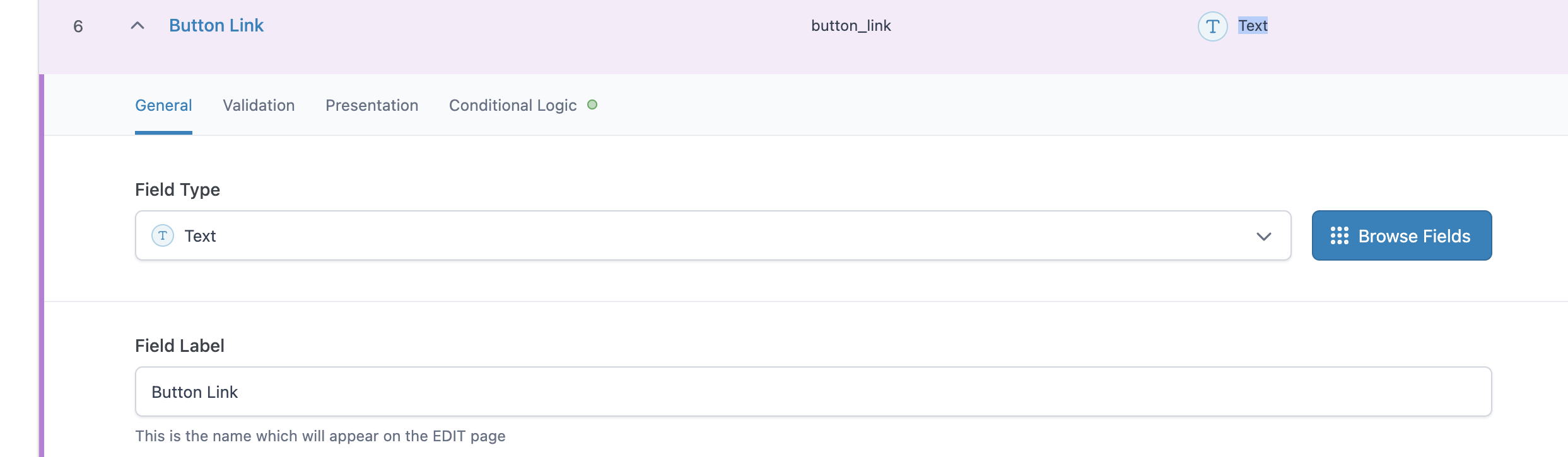

2 things to note here that might help.
1. When we reviewed the ACF field groups we noticed that the button link is set as a text field type and it might be better to be link type.
Please go to ACF -> Field Groups -> Flexible Content -> Content -> Button Link -> Field Type -> Change from Text to Link
This should help with the automatic translation of the link as long as the translation of the page you are linking to exists.

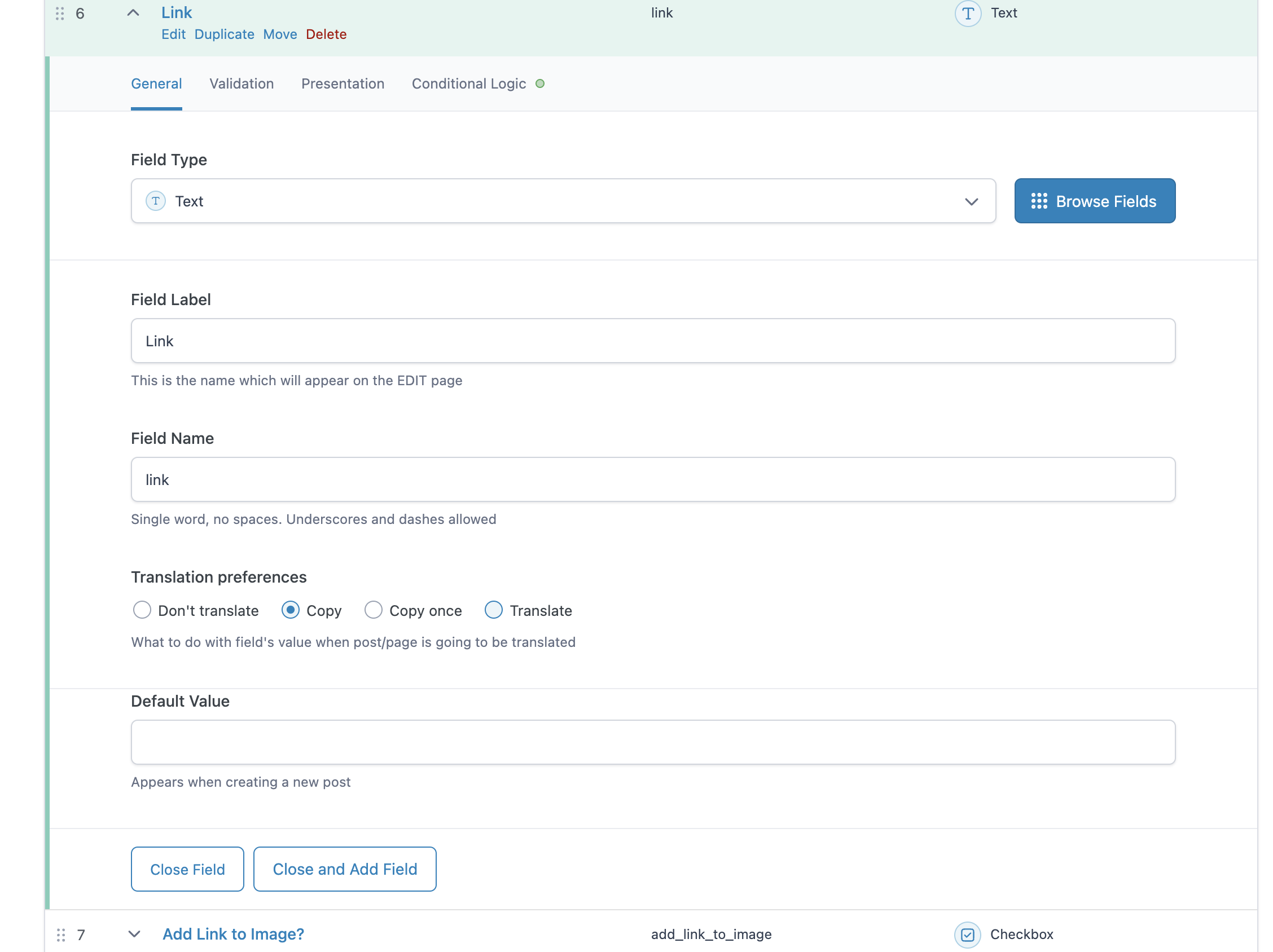

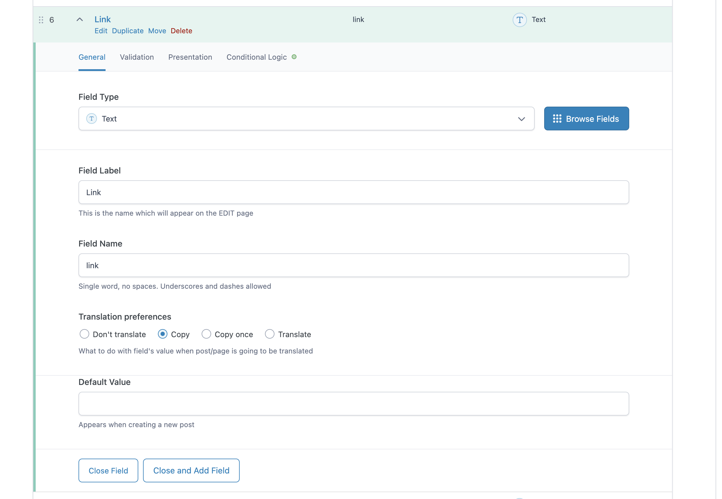

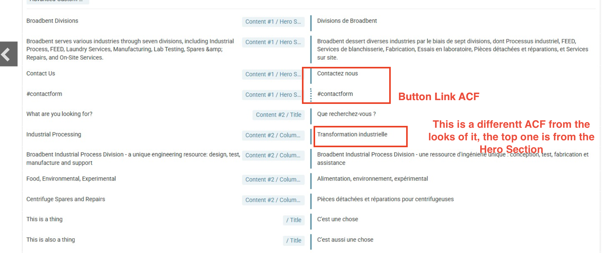

2. In your screenshots notice how you are seeing the button link item for Contact Us includes the Button Link underneath it.
The item that you are missing the link from looks like it's coming from a different ACF field
Looks like it's coming from the Columns / Column / Repeater / Link
This item is set to 'Copy' which is why it's not showing in the ATE editor for you to manually edit.
let's leave it as 'copy' and change the type from text to link as well.
Make a small edit to the default language content and update then update the content and let me know your results, that way we can compare the copy vs translate after it's changed to "link" type.

I followed your instructions. Please see attached image:

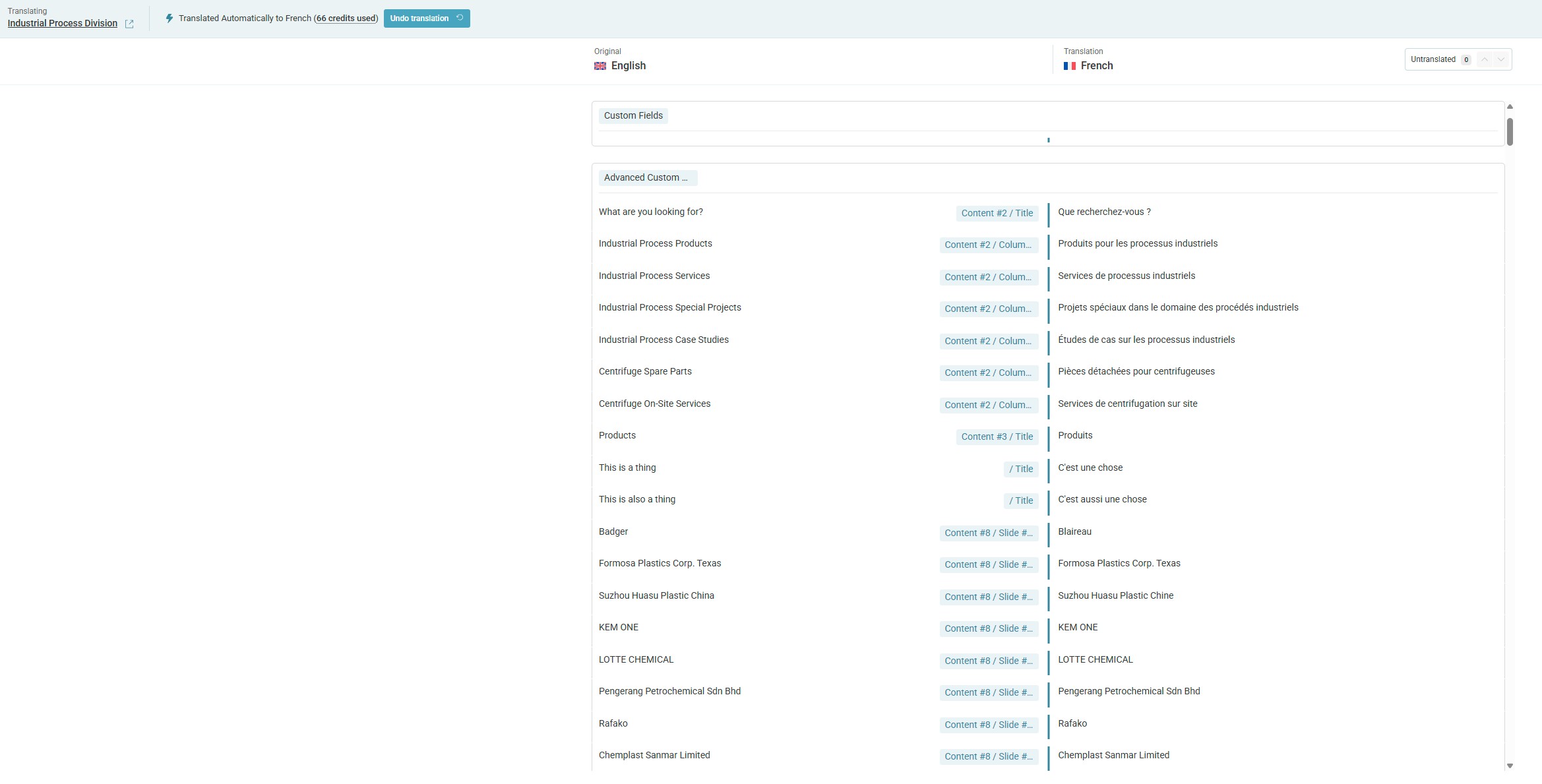

In that image, you can see that in changing the Columns / Column / Repeater / Link from Text to Link, removed the title from being translated all together on the 'Translate' page (and also didn't add a bit that was it's link to be amended)
N/B, the image attached: FEED-page-reference.jpg is the Feed page that I was testing this on, and you can see the title that should be showing up on the translator.
I ran the translate anyway and when I looked at the page, it had made it into a /fr/ link, however it also added /Array on the end of the link and therefore it didn't work and went to the 404 page. Please see attached image: added-forward-slash-Array.jpg

IF you do not want to change the ACF structure (as we have seen this can cause issues), I suggest going to ACF's Columns / Column / Repeater / Link and setting it to "Translate" same as the other, this will allow you to translate it and manually add the /fr/ in the ATE editor.

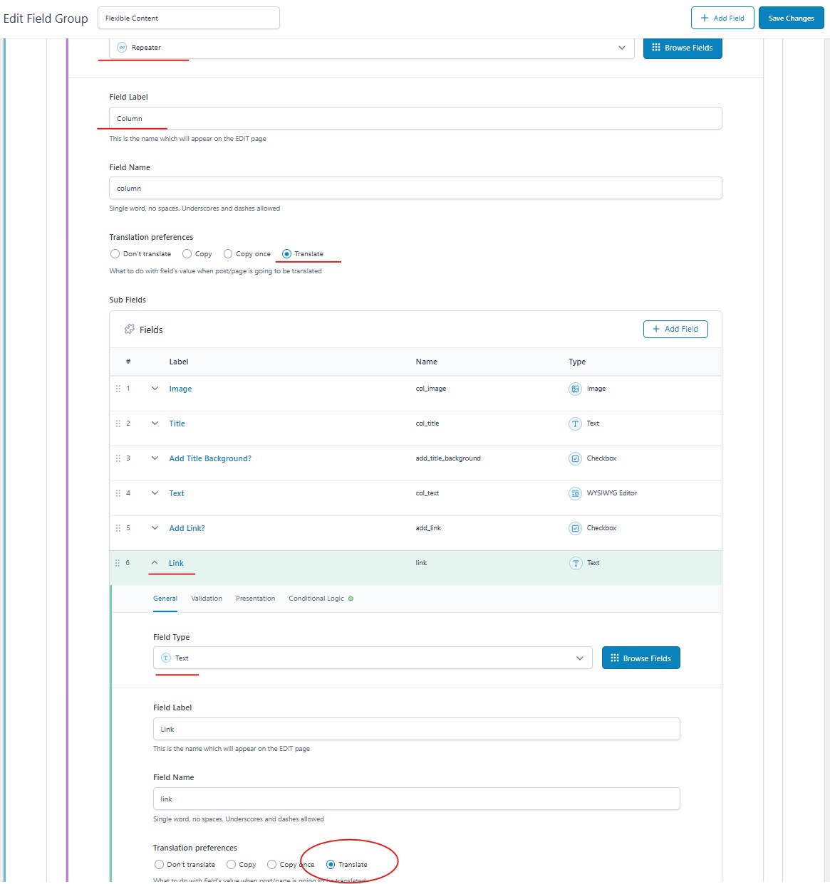

danielT-92
Thanks, I have changed the ACF's Columns / Column / Repeater / Link and set it to "Translate" as suggested. Please see the attached image: ACF-link-location.jpg
I have gone back to the industrial processing page and slightly amended the text on the English page and Updated.

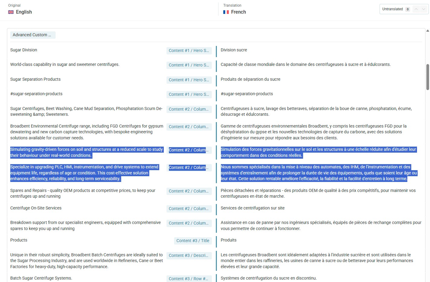

I have clicked on the French translation. As you can see from the attached images set-to-translate-still-no-place-to-change-01.jpg and set-to-translate-still-no-place-to-change-03.jpg the place to manually change the link is not showing up.
N/B: As before, set-to-translate-still-no-place-to-change-03.jpg is showing where we are talking about with the location on the page.

Bobby
The page we were working on—Divisions—is now functioning as expected. If you check it, you’ll see that the URL link is being correctly pulled into the ATE editor.
The page you shared above is using a different ACF field. However, if you search for your link using the search bar in the top-right corner of the ATE editor, you'll see it’s been picked up and is available for manual translation.
