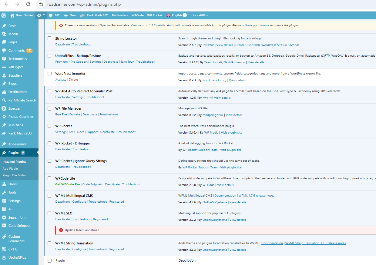

October 4, 2025 at 3:16 am #17455577
eamonnT
I am working on a site under development and trying to update the WPML plugin.
The plugin is not updating.
Why is the WPML plugin not updating?
How can I update the WPML plugin?

October 6, 2025 at 2:25 am #17457944
eamonnT
The site was rvrentacampervan.com and I a have since set up a new site and 301 rthe original site to roadsmiles.com..
I wish to make sure The backend databes are still connected so I will not ce charged again for trabslations...
So please advise hwo achieve... I have so far created a new key for roadsmiles.com ... is it okay to use this key?
