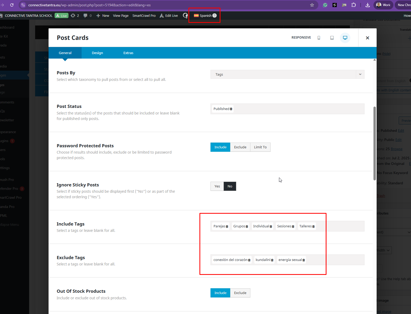

Thanks for your reply. The filters were not configured correctly here hidden link in your Spanish language as shown in the attached screenshot and I've corrected it for you and could you please check?
October 5, 2025 at 5:59 pm #17457701
dosvisual.com
Hi Kor
Thanks, but your workaround got erased as soon as I updated the translation.

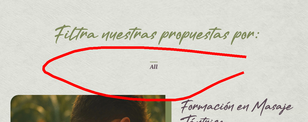

The filters should be automatically translated, as the categories/tags & post-card element were already translated. Can you please dig deeper on this issue?
Additionally, I tried to translate the "all" filters button and the "More.." buttons (for the filtered elements) by searching in the translation editor, but it´s not working..
Thanks!
https://wpml.org/forums/topic/cannot-translate-all-filters-button-and-the-more-buttons/

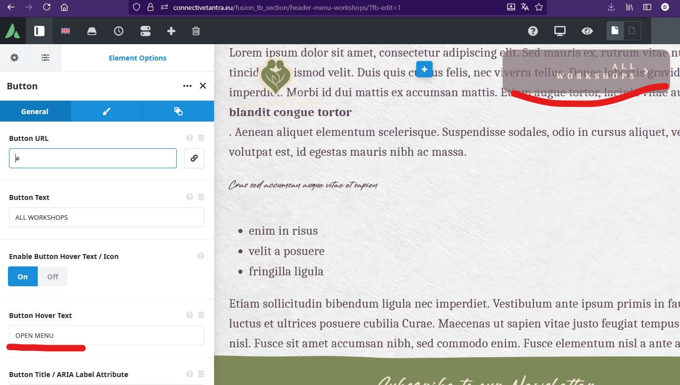

Kor, 1 more, I cannot translate the "button hover texts" on the header´s layouts either.
I´ve tried all recommendations found on the forum and on Ai agents without success (scanned strings too).
You can see it on the front-end here> hidden link "Todos los talleres" > hover: Open menu
https://wpml.org/forums/topic/cannot-translate-the-button-hover-texts/
