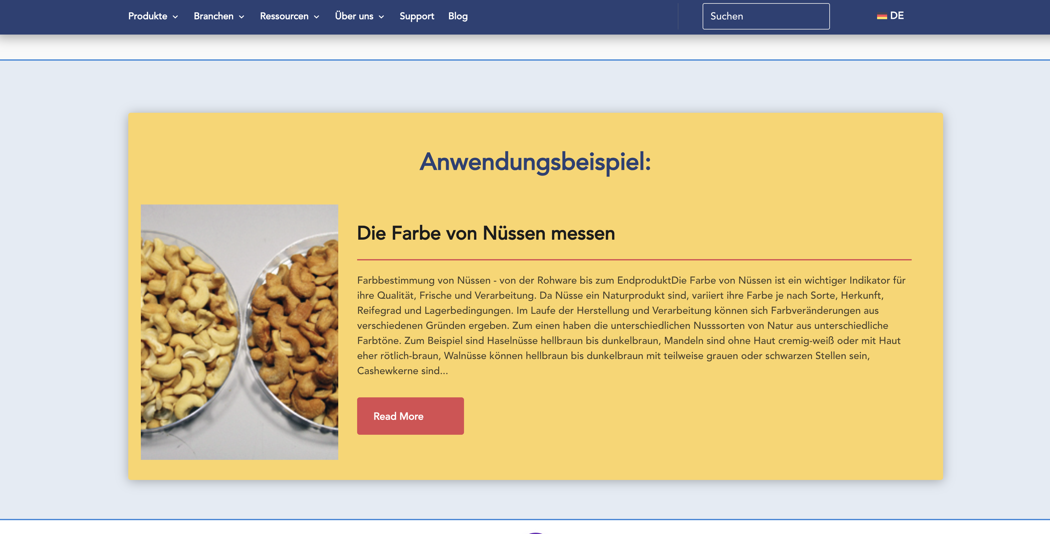

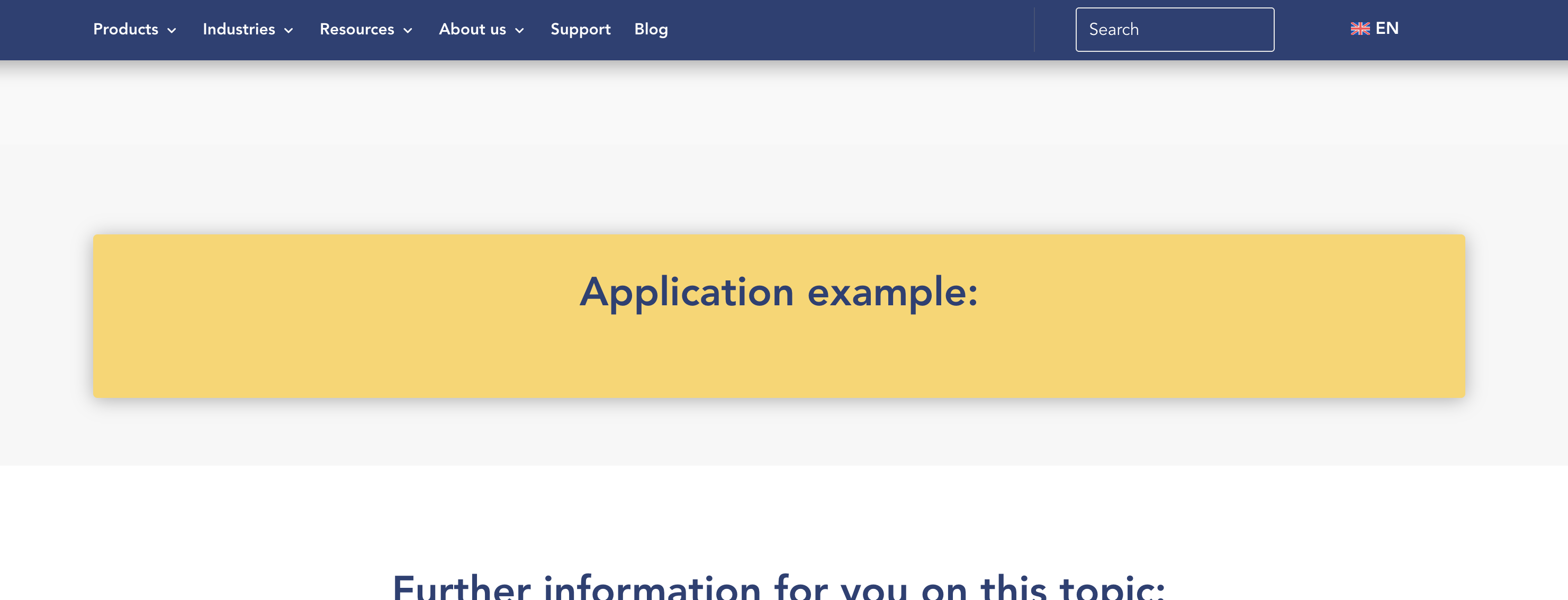

I am trying to display the linked post also in the other languages. The issue can be seen on this page: hidden link
I expected to see the translated post in all languages, but instead, I got nothing.
Why is the translated post not showing in all languages?
How can I ensure the linked post displays correctly in other languages?

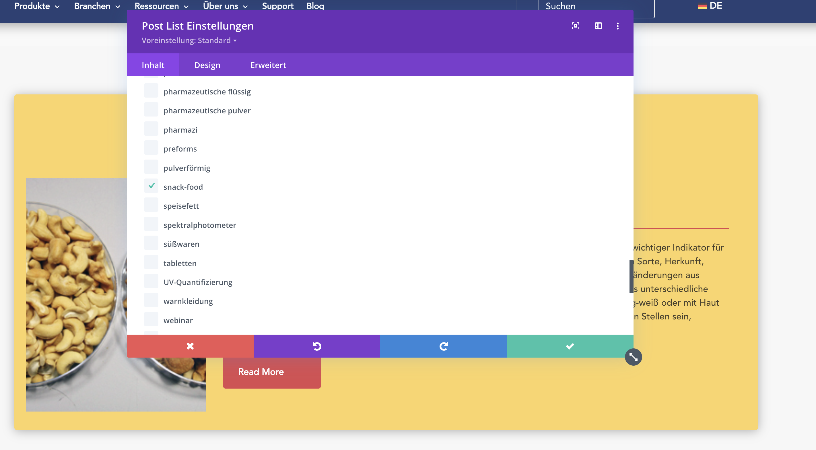

Go to the page in question in WordPress editor, from the top language switcher switch the language to secondary one. If you see a pop up select go anyway.
Go to Divi and manually select the post in the translation in Divi.

Thank you for the login information. I found out that the section you mentioned was created by a third party plugin called DiviFlash.
That plug-in at additional Divi widgets. The widget that is used on that specific section of the page is called: Posts List.
That specific widget and the plug-in itself is not compatible with WPML.
You will need to contact the developers of that plug-in and encourage them to make their plug-in compatible with WPML, they can apply for help in our go global program measure below:
https://wpml.org/documentation/support/go-global-program/
Thanks.

I contacted Divi Flash but they ensured me that theier plugin is compatible with WPML.
I sent them a login so they can dig into the problem as well and I'll keep you up to date.
Stefano
May 26, 2025 at 8:35 am #17071617
stefanoM-53
Hi Christopher,
DiviFlash could solve the problem on their end.
Now everything looks good.
