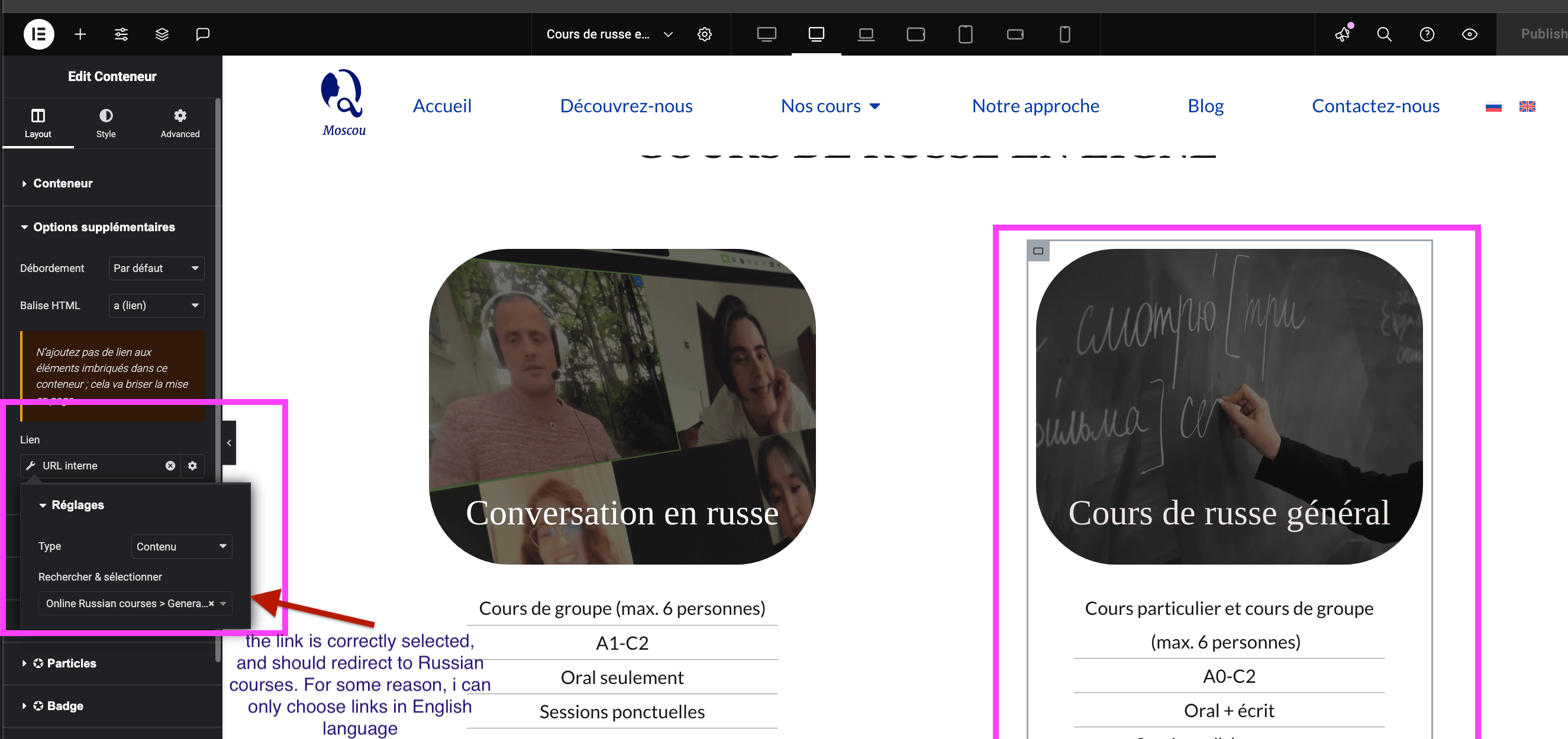

I am working on a site under development using WPML. The Russian version of the site, which is now the main language but was formerly secondary, has a link issue. I am using Elementor to edit the links.
In the Russian version of the site, when I click on 'General Russian courses', I am redirected to a page about French courses (still in Russian language though).
This issue was previously happening in the English version, but it was fixed by re-editing the link in Elementor.
For some reason, when I edit the link in the French page (the language the page was written), Elementor only allows me to choose links for English pages. This is maybe causing the issue.
How can I fix the link issue in the Russian version of the site?
Why does Elementor only propose links for English pages when linking from the French page?

May 26, 2025 at 3:50 pm #17074299
clementD-15
Hi Otto,
your rephrasing is absolutely on point.
I did all what you suggested, but because I get a warning (see screenshot), I didn't do :
"Edit the Russian page in Elementor, re-select the correct “General Russian courses” page, update"
So far, no improvement.
I edited the page in French when it used to be the main language, with the ATE, and as far as I remember, I used the automatic translation.

May 26, 2025 at 6:40 pm #17074848
clementD-15
Hi Otto,
actually, i could change the link in the original page, and i could choose French (not only English was proposed).
Just a question : you suggest to edit the Russian translation in Elementor despite it's not recommended, as shows the notification.
Are there situations where I should edit a page in a language that wasn't used for its creation?
