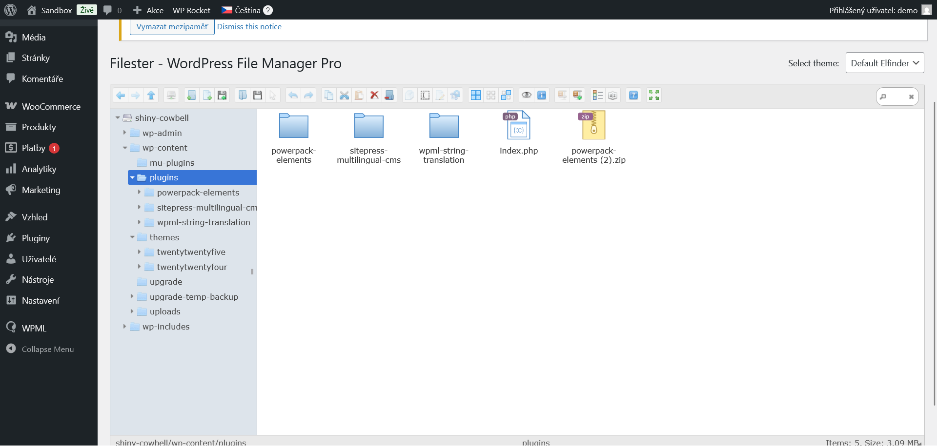

We don't have FTP access for those sandbox sites. You can use the Filester - WordPress File Manager Pro plugin, which is installed on this site, to upload your plugin.
Disclaimer. Since you mentioned that the plugin's settings are manipulated by modifying the PHP code, this issue may fall under custom work, which is outside the scope of our support forum.
Please let me know if you were able to install your customized wp-rocket-preload-dynamic-cookie plugin, and indicate where in its files you made the customizations. I'll then consult our second-tier supporters about this case.

Well I tried to use Filemanager, but probably I am not sure how to use it correctly, because in the plugin folder I see only 3 plugins (and on the site is installed more than 3) and the one I need I can't see there - you can see that in the attached printscreen.
So could you please, upload the provided file there by yourself?

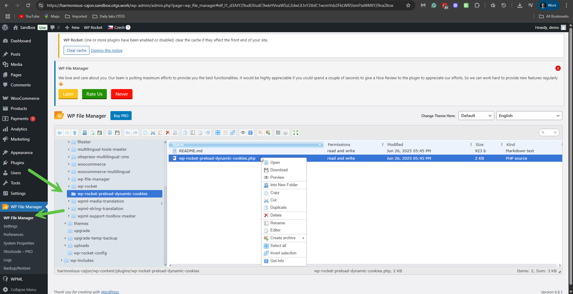

It works with the WP File Manager plugin. Please see the attached screenshot. However, I'm consulting our second-tier supporter about this case. I need to get his judgment on whether we can support this case.

I was able to rewrite the file, so now the settings of the helper plugin is correctly. But I am not able to force the WP Rocket to preload the site. I also installed Rank Math (the same plugin I use on my site) to create sitemap, which WP Rocket uses, but it didn't help. If I visit pages manually it creates the cache, but for reproducing this problem I need to preload the cache automatically.
So for now I am not able to reproduce the problem in the sandbox and I am waiting for more information from tier 2. This problem basically affects all shops, which use different taxes and WPML + WP Rocket with preloading function. Because now it's not possible to preload the cache corretly.
