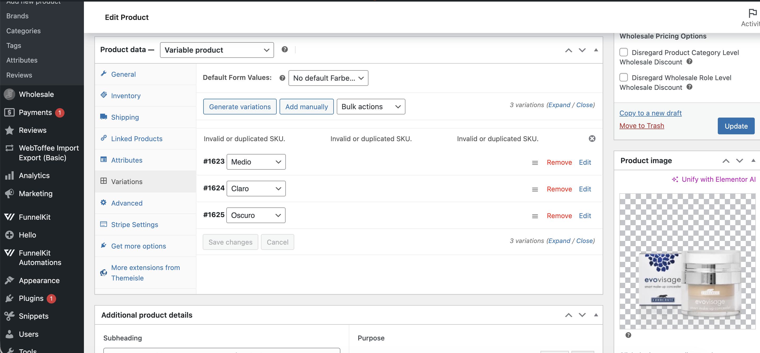

April 8, 2026 at 8:32 am #17955928
simeonN-2
I disabled the plugin, then tried to rearrange the variations, but when i try to save it, it says invalid sku and when i save it goes back to the same order.
Now I have enabled it again until you check from your side.

April 8, 2026 at 6:39 pm #17957523
I was able to confirm an issue with the translation of products.
In ACF (Advanced Custom Fields), field names must follow WordPress’s general rules for meta keys. That means:
✅ Allowed: lowercase letters, numbers, and underscores (_)
❌ Not allowed: special characters like &, #, spaces, or punctuation
So your example:
Example field names:
application_&_application_time
effects_&_results
is not valid because it contains & and #. These characters will cause issues when saving or retrieving the field, since ACF stores field names as meta keys in the database.
In this case, it breaks the translation.
Please solve this issue by renaming the field accordingly, and then get back to me. Note that you will also need to adjust the template that is rendering the field on the frontend.
