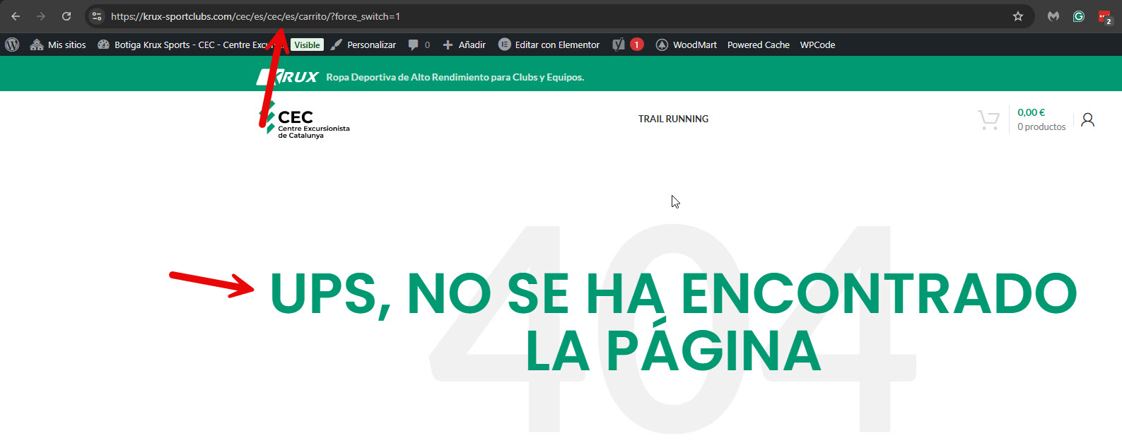

I'm trying to prompt for a confirmation and reset the cart. The issue can be seen at this URL: hidden link.
I expected to see an empty cart, but instead, I got an error 404 because the URL page name and language code got duplicated.
Why is the cart not resetting as expected?
What causes the URL page name and language code to duplicate, resulting in a 404 error?

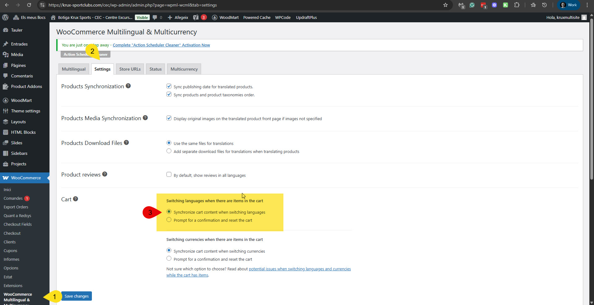

You asked: "If there is no currency involved, just a product bundled with size variation: Is it possible to set the cart to 'sync the content when changing the language' and make it work?"
Yes, and it is set to 'Synchronize cart content when switching languages' on your site. Please see the attached screenshot.
I suspect that the problem is that the Spanish language is hidden on your site. Please check if the problem persists when it is not hidden. Also, please ensure that all the products are translated and updated into Spanish.

You can duplicate and check. You will see that prompt and clear cart works when switching from spanish to catalan but not when you switch from catalan to spanish where the error triggers: the cart and language slug gets duplicated and that triggers a 403 error.

Thanks for further explaining the issue. I could replicate it on hidden link. Please see the attached screenshot. To do that, I needed to temporarily put the Language Switcher in the footer of the site (to be able to switch languages.) And also I needed to change the 'Switching languages when there are items in the cart' option from 'Synchronize cart content when switching languages' to 'Prompt for a confirmation and reset the cart'. After replicating the problem, I reverted these settings to their original state.
