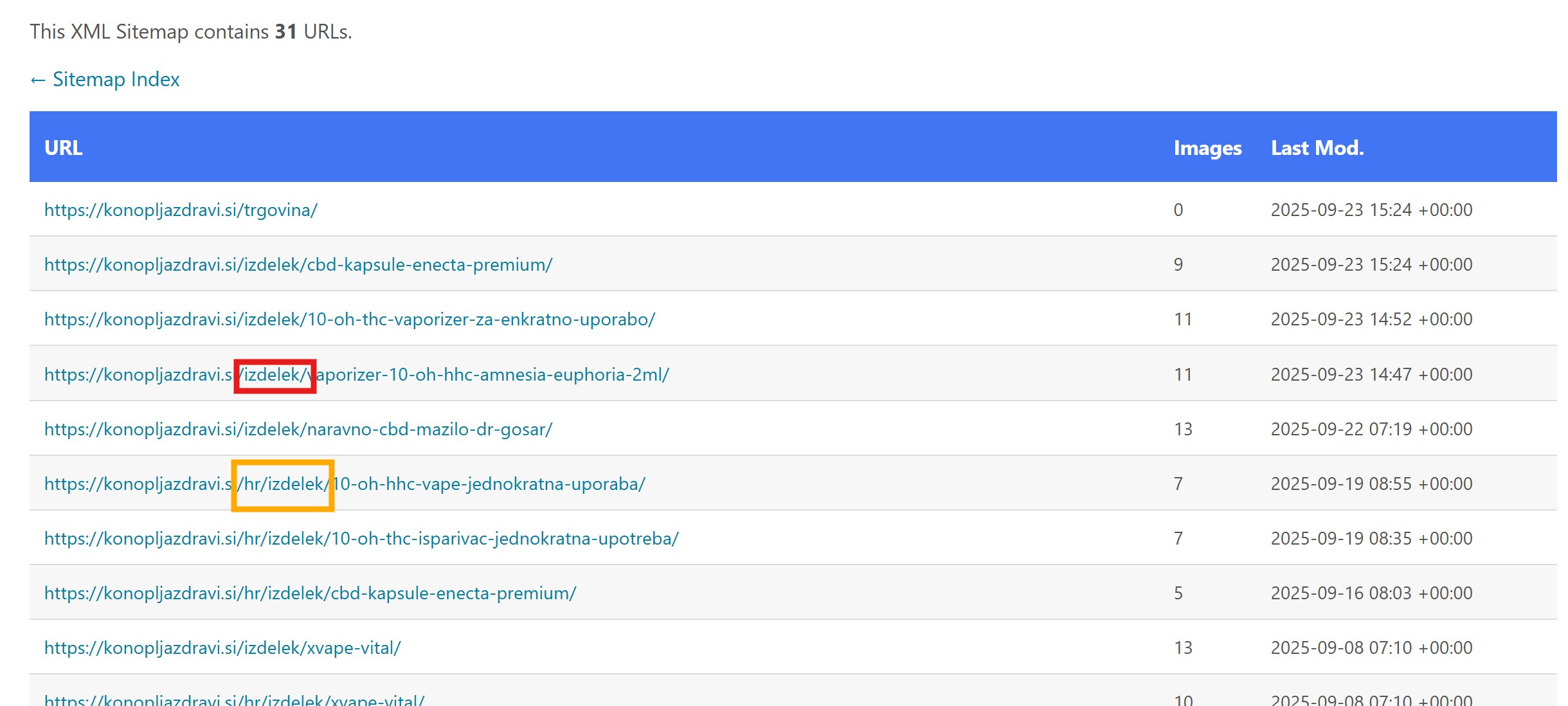

I am trying to correct the URLs in the product sitemap for the foreign URL. It is pulling untranslated slugs from the original language. The issue can be seen at: hidden link.
Instead of the expected URL 'hidden link', I got 'hidden link'. The term 'izdelek' is from the original language instead of the translated 'produkt'.
How can I ensure the sitemap pulls the correct translated slugs for foreign URLs?
Why is the sitemap using the original language term instead of the translated one?

Here is the video. I had 200 per page and changed to 10 twice.
Nothing happens:
There are still products with mixed slug:
Izdelek should be produkt in HR (Croatian)
Sitemap:
Thank you in advance!

I tried to replicate this issue on my test site, but was unable to reproduce it. Then I revisited your products' sitemap here: hidden link. And I can see that the problem is corrected. Products in the Croatian language show like this: hidden link, and there no wrong listing like this: hidden link. Please see the attached screenshot.
Could you please confirm that the issue is now resolved?

Thank you it was resolved by changing sitemap number per page or WPML SEO plugin.
