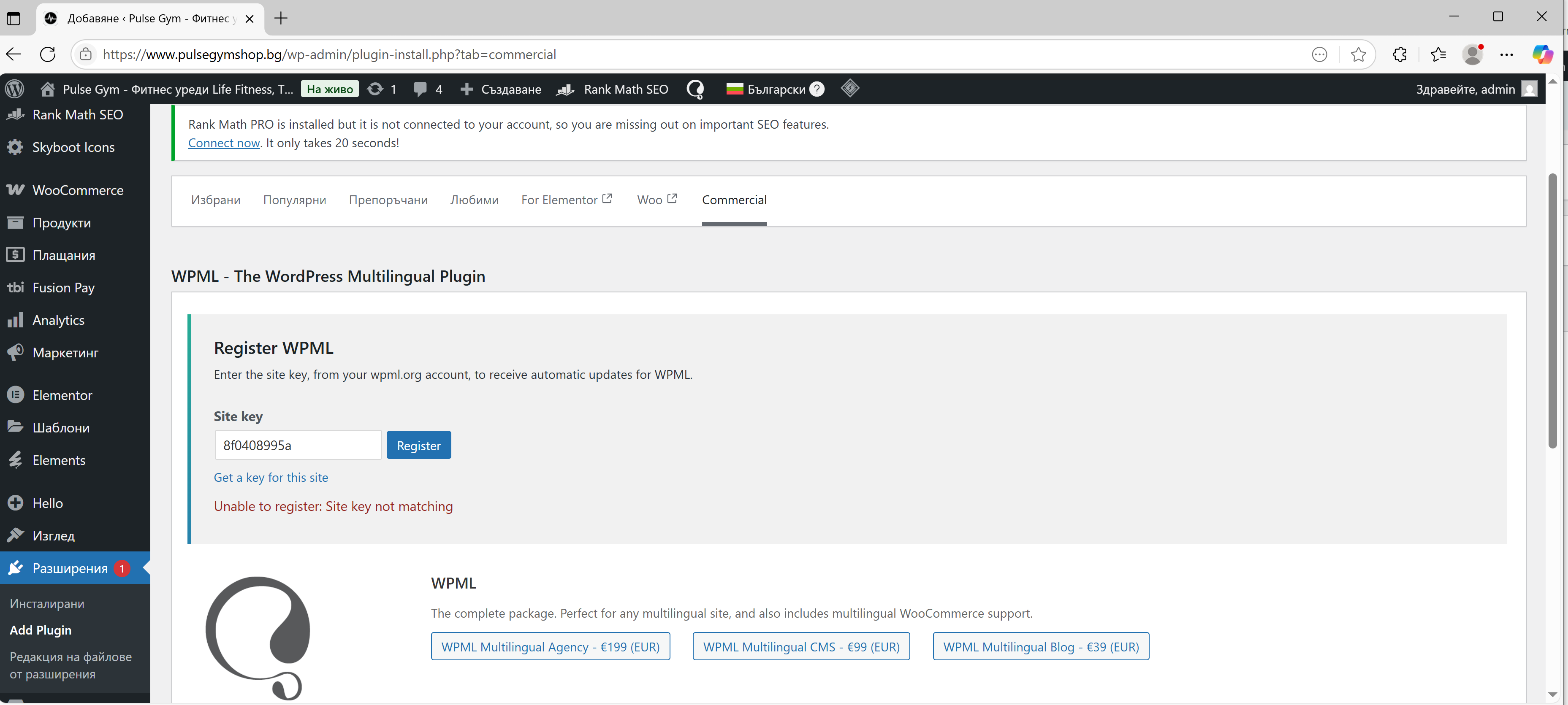

I'm trying to register the WPML in pulsegymshop.bg as production.
I getting error: Unable to register: Site key not matching
How do I register WPML as production for pulsegymshop.bg?

borislavA-2
I tried but I still get the error
"Unable to register: Site key not matching"

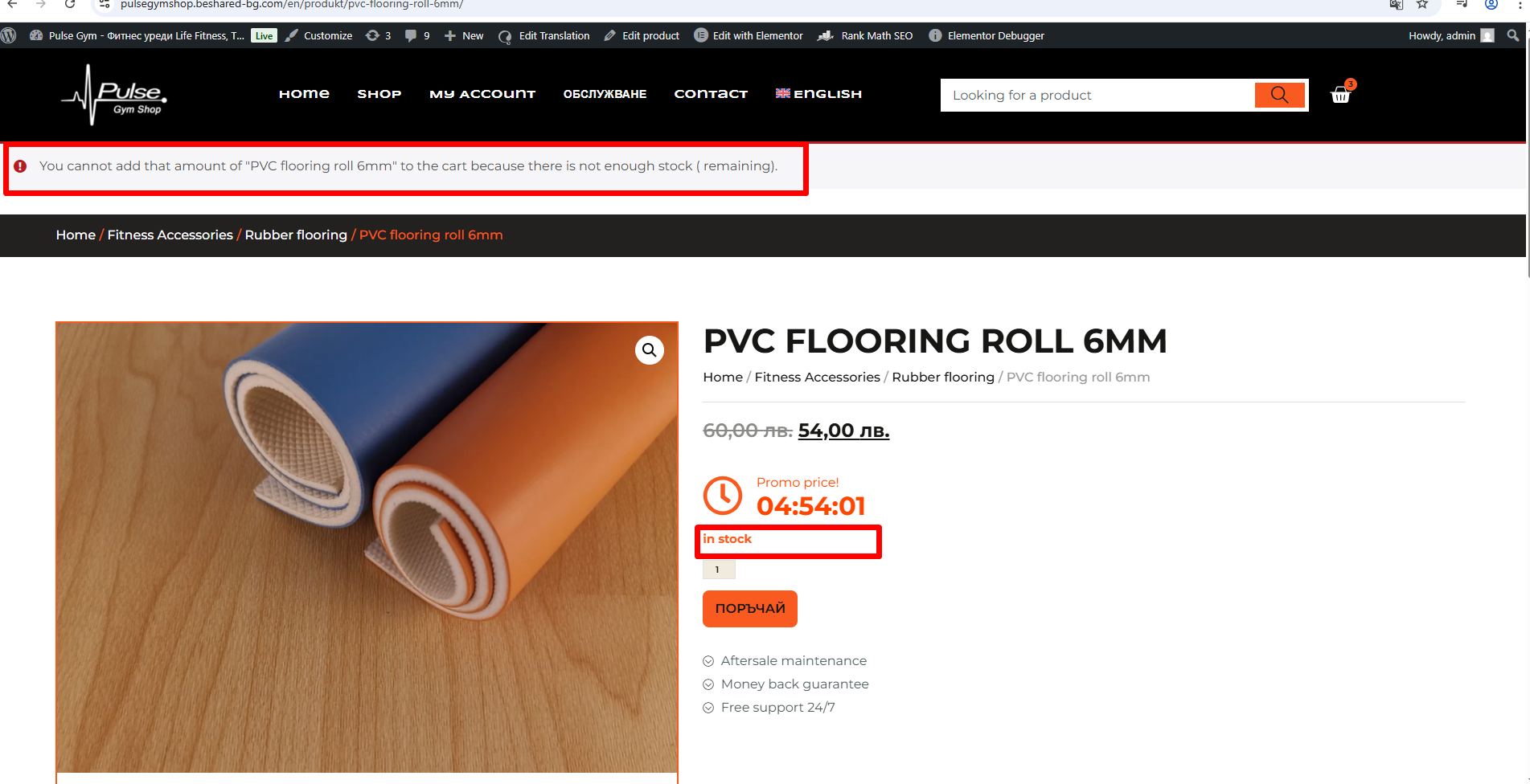

borislavA-2
I have even worse issue now. My second language items don't have any quantity. I can't sync the quantity between the main language and second language because can't activate the WooCommerce Multilingual

ok I understand, but what about the other problem, if I deactivate TBI Plugin, then WooCommerce Multilingual (WCML) works. However I can't synchronize the quantity between the main language and second langauage, as a result of which customers cannot purchase anything from the English version
Even if I go to WooCommerce Multilingual , troubleshooting and synchronize the products, then it gets worse, quantities disappear everywhere. Please help me fix this.

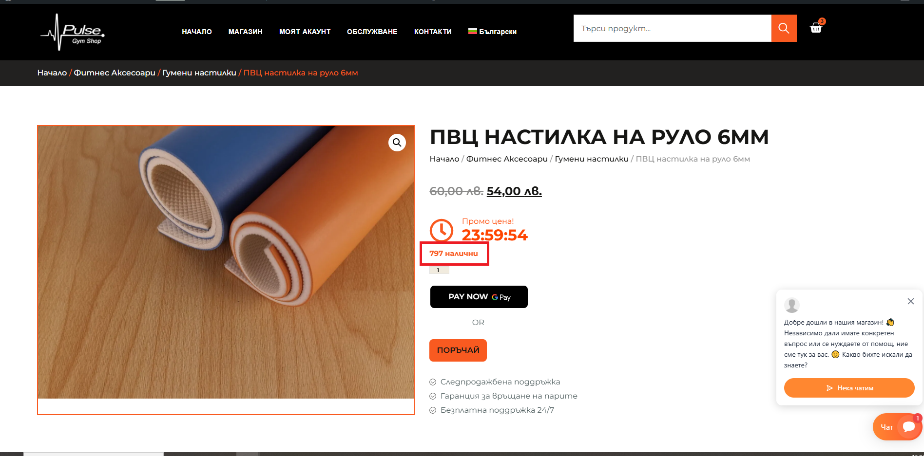

June 3, 2025 at 1:30 pm #17102573
borislavA-2
Can you check the video please?
The english version currently is not possible to be used. It gives error with the quantity!
If I sync through WooCommerce Multilangual it gets even worse, the quantity disappears from both versions, the customer can't buy anything.
I need a solution urgant, because I doing this for client who is dissappointed.
Here is the english version - it cannot be ordered because the error with the quantity
In the bulgarian version it's okay for now
but if I use the function synchronize both version will show no quantity!
Another example BG (main) Version:
hidden link - 111 items (quantity)
In the english version
hidden link - just show in stock but no quantity can't be purchased.
