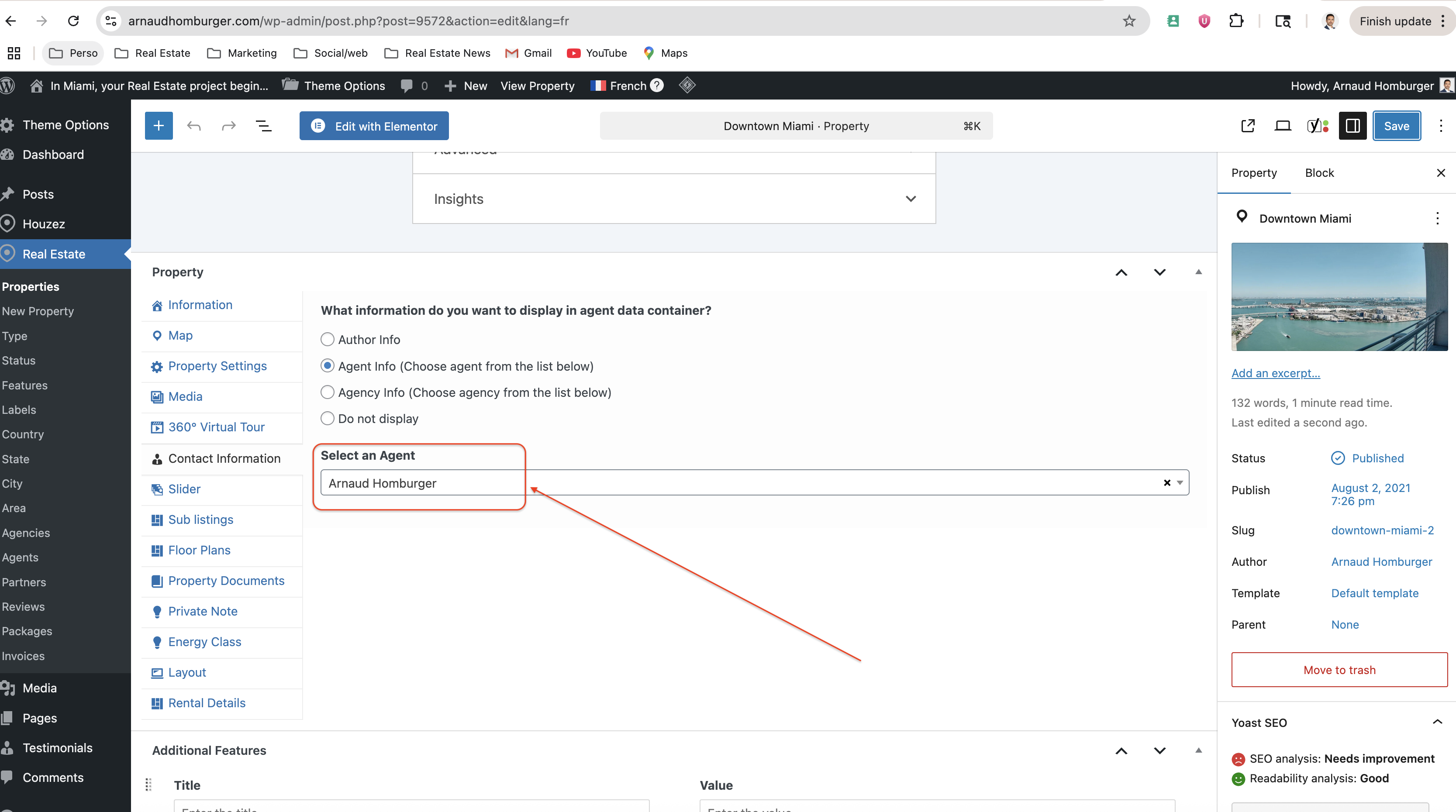

***Please assign this ticket to Ilyes directly, I only work with him for the resolution of all my tickets. Thank you***. The selected agent on the French version does not hold when I update the French translation.
I’ve encountered an issue with the agent assignment on the French version of my properties when updating translations via the ATE (please refer to the attached screenshot).
Yesterday, I noticed that for nearly all of my 78 properties, the French translation icon (the pencil) was visible on the English version, indicating the need to update the French translation. I went ahead and updated each one accordingly.
However, today I realized that the selected agent — “Arnaud Homburger” — is no longer assigned to the French versions of these properties. I had to manually edit each French property one by one to reassign the correct agent. This is not the first time I have to do this, which is time consuming and it sometimes take me time to realize that the agent is no longer assigned on my french properties.
Please note: assigning “Arnaud Homburger” as the agent is necessary for the properties to appear on the agent’s profile page under the “About Us” section of my website:
🔗 hidden link
Could you please investigate this issue and let me know if there’s a way to preserve the agent assignment when updating translations, so I don’t have to manually reselect the agent every time?
Thank you in advance for your help.
Arnaud Homburger
Why does the selected agent not hold on the French version after updating the translation?
