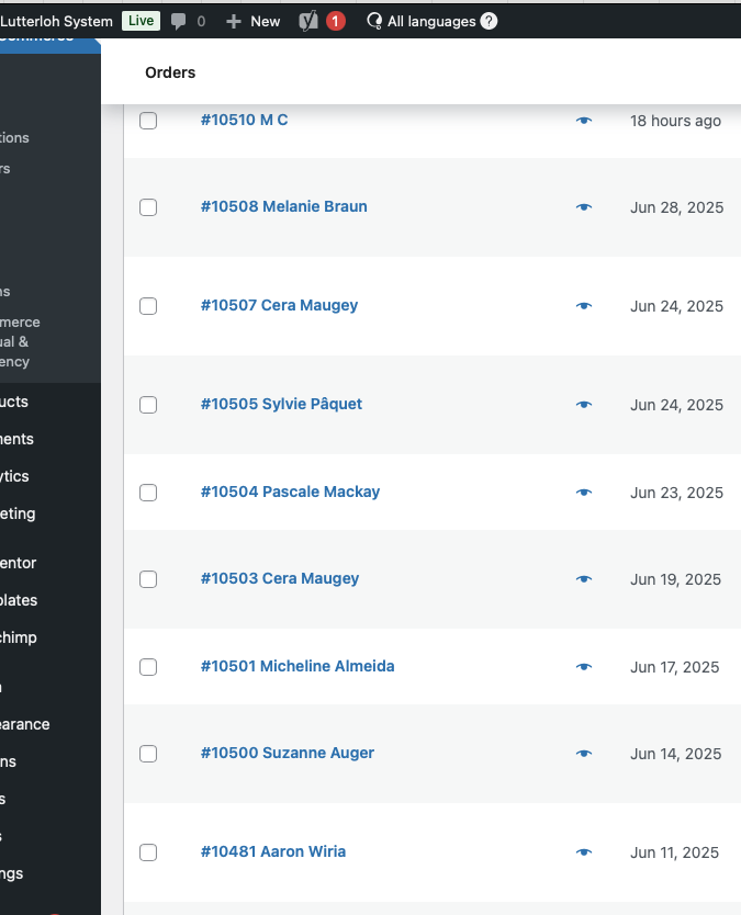

the English main site: Lutterloh.ca
the French site: Lacoupedor.ca
I have been using WPML since some years now, I change the hosting and import the complete site.

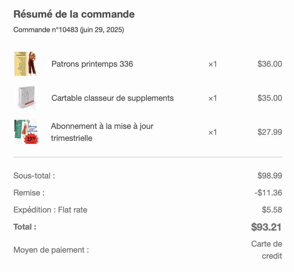

I received an email from a client with an order # from the French site, that is not registered in the woocommerce orders. I can see her payment inside the stripe/credit card transactions, but I don't find her order anywhere on the site orders.
