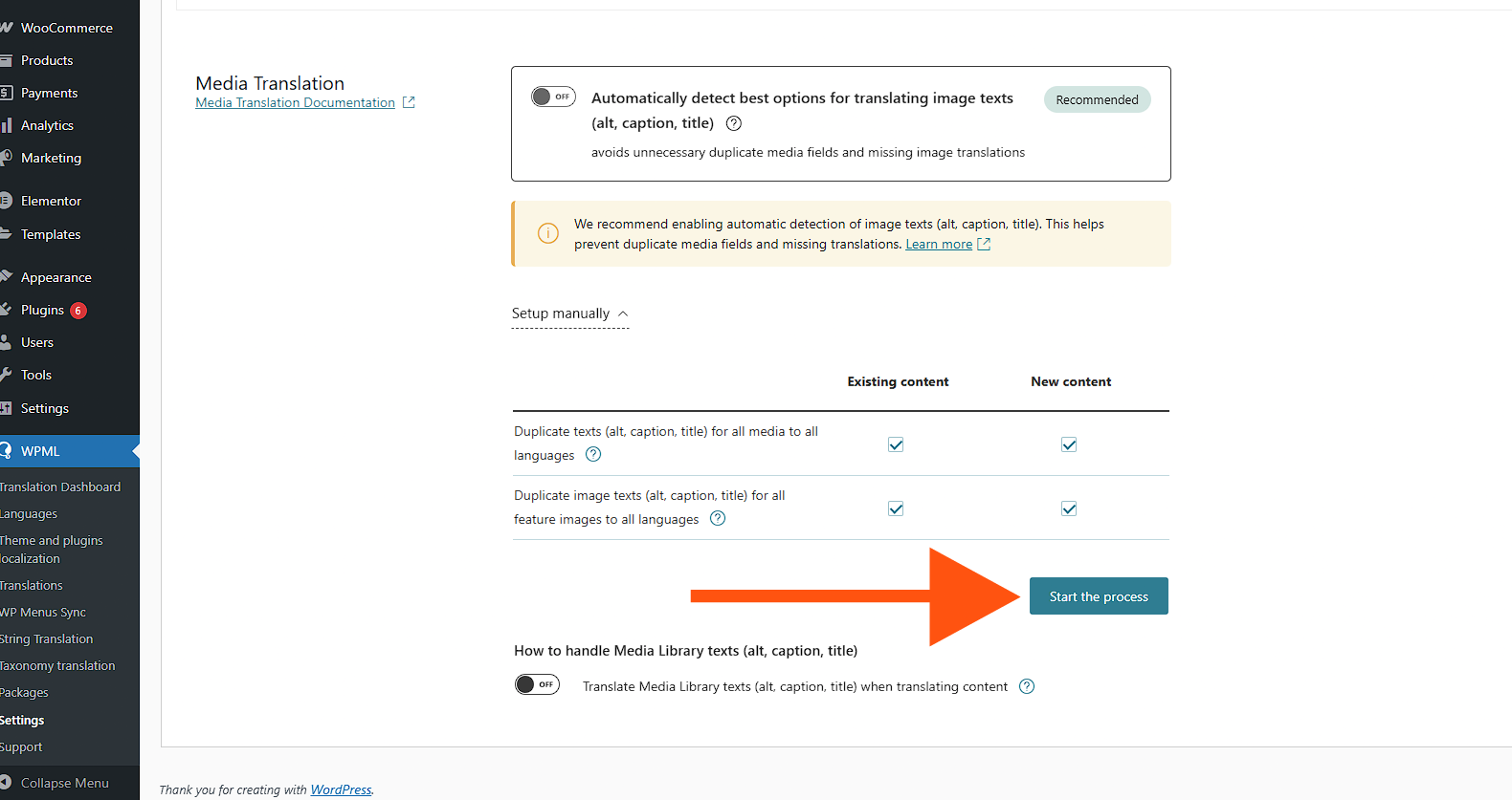

1. Navigate to WPML > Settings > Media Translation.
2. Disable the option to automatically detect media for translation.
3. Access the manual setup from the dropdown.
4. Check all boxes for existing and new content.
5. Click "Start the process" to create necessary entries in the database.
This process will take time based on the number of images but will ensure that media is available in all languages without filling up the database unnecessarily.

The fallback will not work for media.
You will need to make sure that there is one entry for each language inside the media library.
WPML will usually handle this automatically when translating your posts and pages.
If not, revise the section WPML > Settings > Media Translation.
In the latest version of WPML, you will find a dialog that auto-detect media for translation, which is recommended. If you disable this option, you will find a dropdown to access the manual setup.
Mark all the checkboxes (existing and new content) and then click "Start the process".
This dialog will create all the necessary entries in the database. Based on the number of images, this dialog will take its time to complete the task.
If you do not sync the media, it will not show up in the second language.

Let's say you already had media inside the library and then installed WPML, then WPML will sync media each time you translate a post or page that has media attached.
To generally sync the existing media, you need to follow these steps:
- Go to WPML > Settings > Media Translation and disable the option to automatically detect media for translation.
- If you disable this option, you will find a dropdown to access the manual setup.
- Mark all the checkboxes (existing and new content) and then click "Start the process".
See screenshot.
