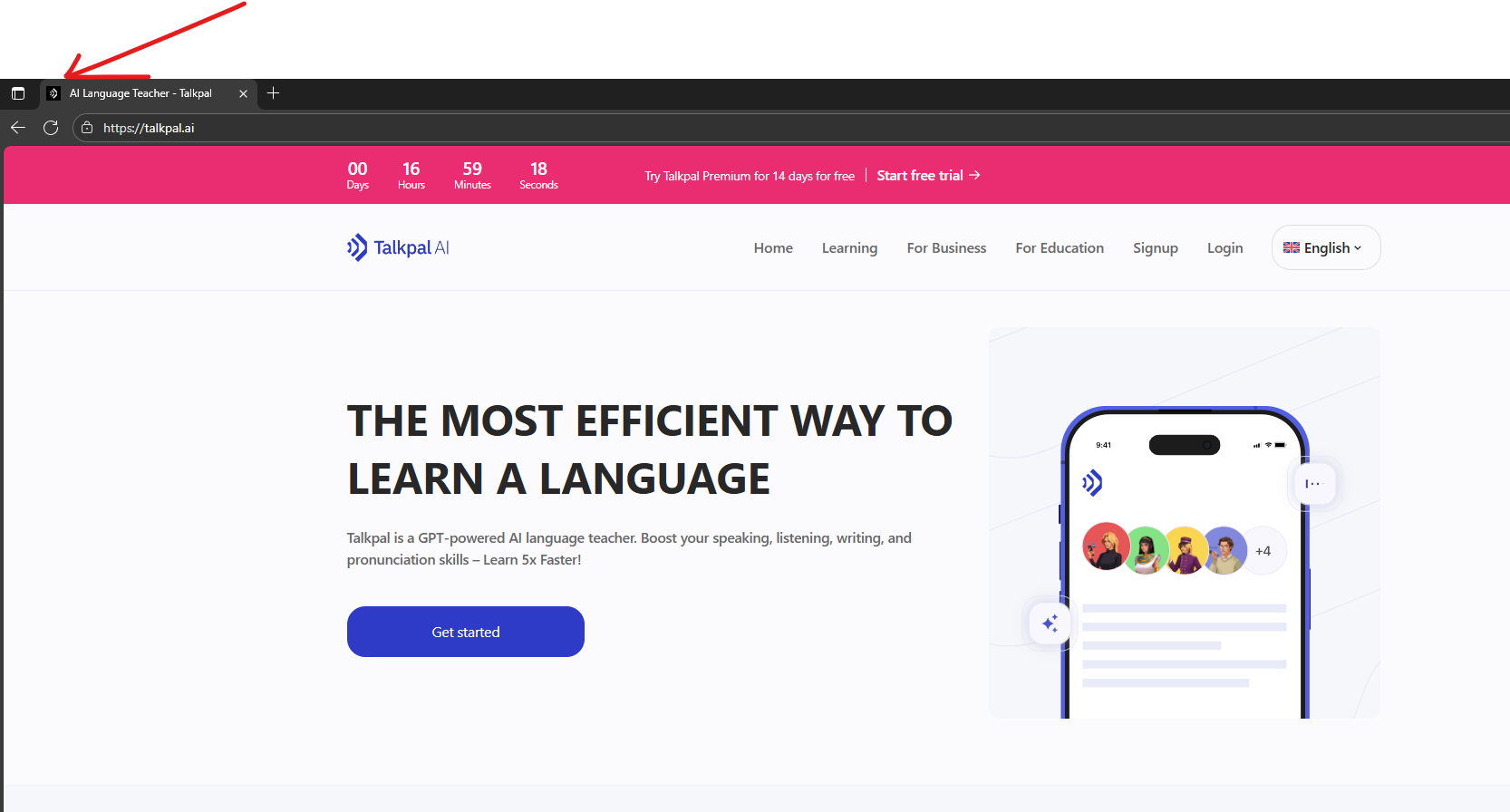

1) I have accessed the website as instructed, but can you add some difference to staging site Title / page so I am sure I am accession staging, not production? Since they share same URL. I do not wish to cause any changes to your production website.

September 15, 2025 at 7:51 am #17400854
akakiT
Hello Drazen,
1. You can identify the staging environment by the “Talkpal Staging” label with a black icon (see attached screenshot for reference). This should help you distinguish it from production.

September 15, 2025 at 8:30 am #17401009
Dražen
Hello Mikheil,
thanks for getting back.
1) Yes, I can see that kind of icon, so we are good.

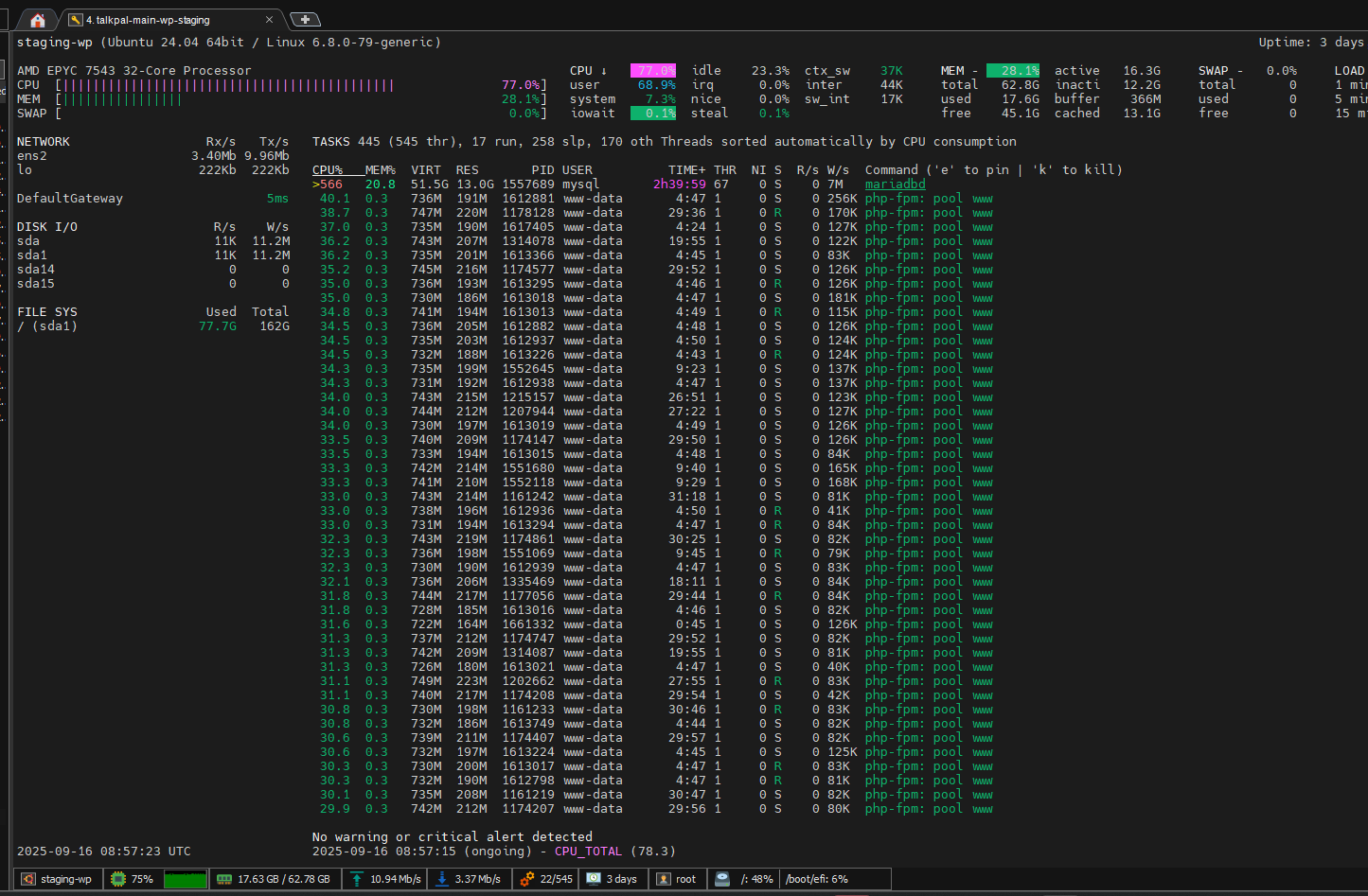

September 15, 2025 at 2:00 pm #17402774
akakiT
Hello Drazen,
Here is what we found during today’s test:
We started a stress test with CPU load at around 70–75%.
After deactivating three plugins — WPML Multilingual CMS, WPML SEO, and WPML String Translation — the CPU load immediately dropped from 75% to 50%, and we also observed a significant decrease in disk read/write activity (see attached screenshot).
Another important observation: during testing, disk usage on the server (160 GB total) increased from 45% to 92% and continued rising. Once the WPML plugins were deactivated, disk usage dropped back down to 44%.
On production, we are still experiencing the issue. For now, we have increased CPU resources from 32 cores to 48 cores and are monitoring performance while we wait for further analysis.
Mikheil

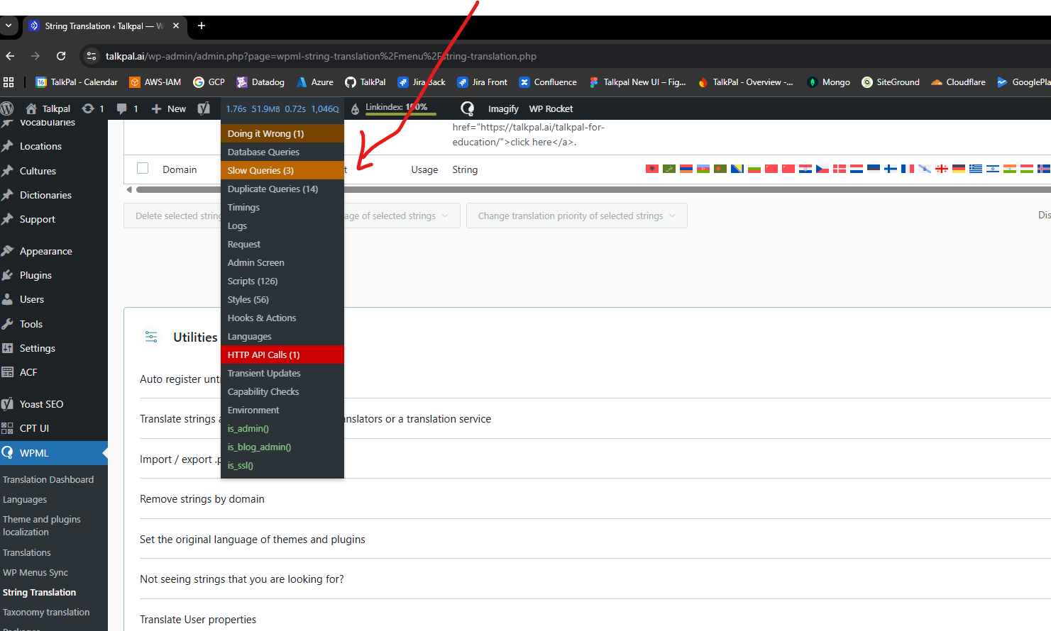

September 16, 2025 at 6:20 am #17404368
Dražen
Hello Mikheil,
thanks for getting back, that is very helpful.

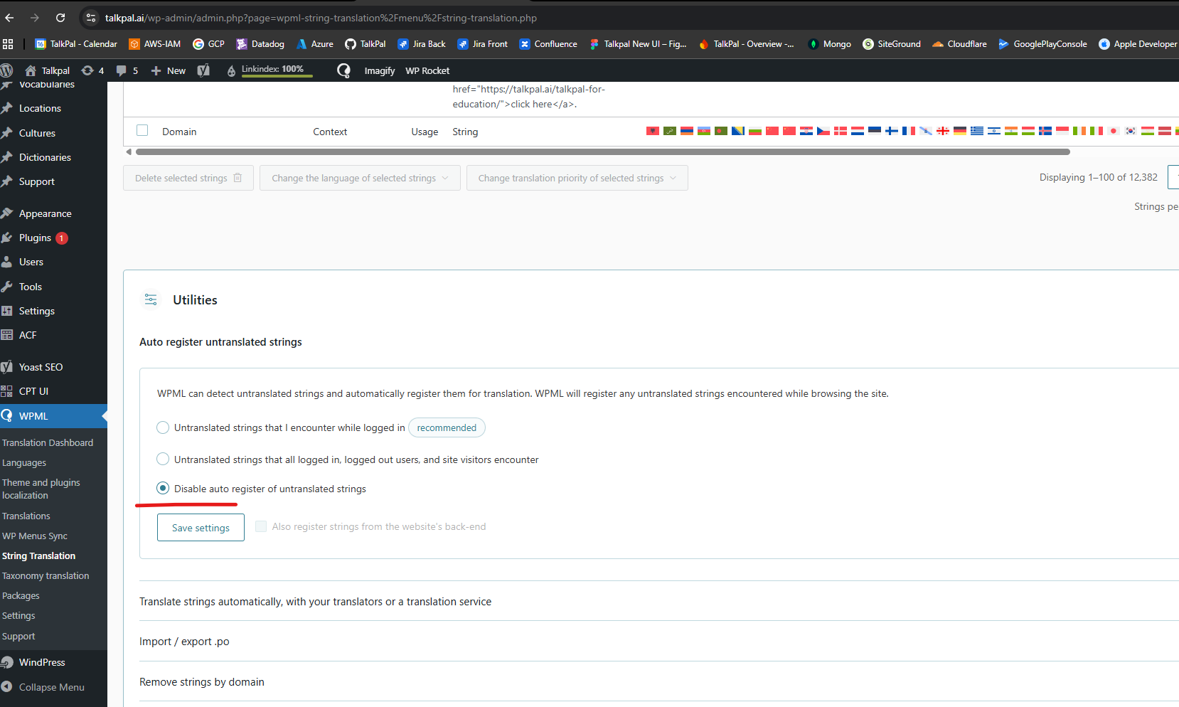

I have checked your staging website, installer Query monitor, and have seen large number of queries causing performance issue coming from WPML.
I see they are related to registering strings, so I have went to WPML > String translation > Auto register string > Set to Disable
Seems this has fixed the issue and website loading and working normally with just 160queries in 0.80s.

September 16, 2025 at 9:00 am #17405089
akakiT
Hello Drazen,
You mean this one? (see attached screenshot)
I just run stress test and can't see any difference.

September 16, 2025 at 9:03 am #17405208
Dražen
Hello Mikheil,
yes, that is the one.

September 16, 2025 at 9:07 am #17405240
akakiT
Did you install this plugin? (see screenshot)
I think you did it on Production,
Also, I see "String translation > Auto register string " disabled on Production
September 16, 2025 at 9:10 am #17405272
Dražen
yes seems so, sorry for that, my mistake. I am not sure why, but my hosts file were reset this morning and staging site IP was not there.
I have not done anything else, hope this has not caused any issues.
