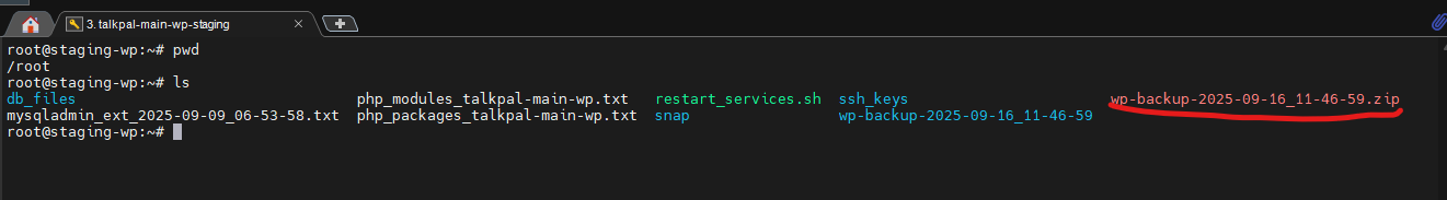

September 16, 2025 at 1:26 pm #17406428
akakiT
Hello Drazen,
here is zip file on Staging server:
root@staging-wp:~# pwd
/root
root@staging-wp:~# ls
db_files php_modules_talkpal-main-wp.txt restart_services.sh ssh_keys wp-backup-2025-09-16_11-46-59.zip
mysqladmin_ext_2025-09-09_06-53-58.txt php_packages_talkpal-main-wp.txt snap wp-backup-2025-09-16_11-46-59
root@staging-wp:~#

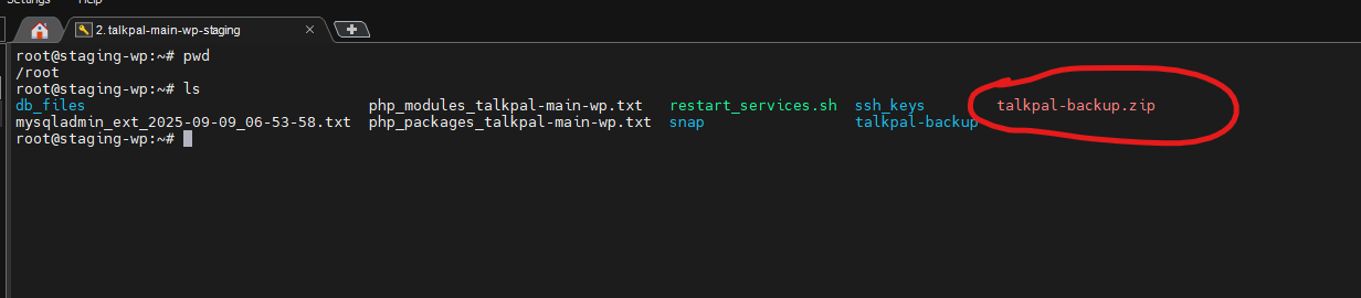

September 16, 2025 at 2:08 pm #17406617
akakiT
Did you already manage to download the ZIP file? I accidentally deleted it. If not, I’ll recreate it for you.
P.S. I’ll also try disabling these plugins and run some tests.
September 16, 2025 at 3:15 pm #17406740
akakiT
New backup zip file

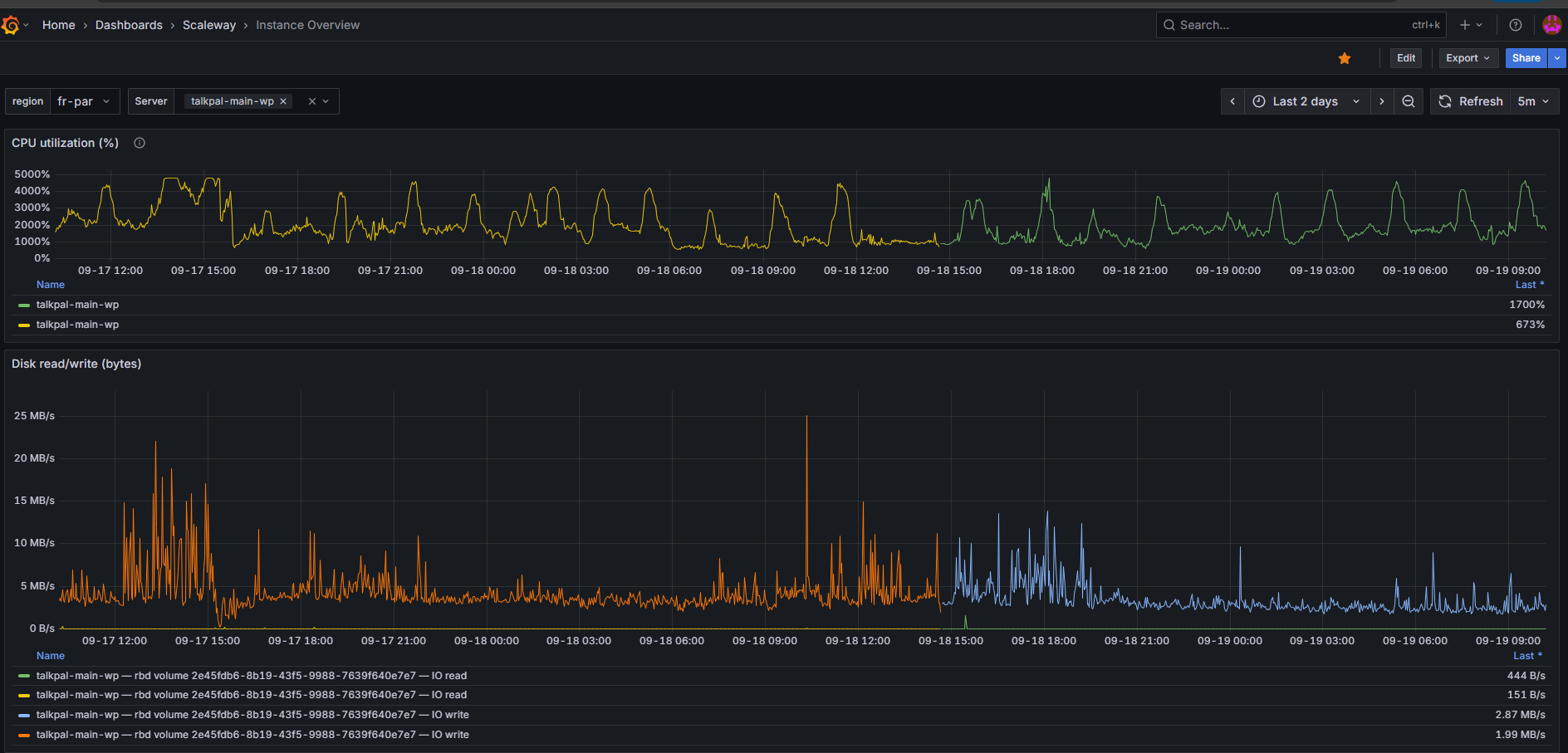

September 19, 2025 at 6:19 am #17415361
akakiT
Hello Drazen,
Thank you for the update.
I’m sharing our production WordPress Grafana monitoring chart from the last two days.
It looks like some job(s) may be running continuously and causing CPU spikes.
Just for your information — this might be helpful in your investigation.
Mikheil
