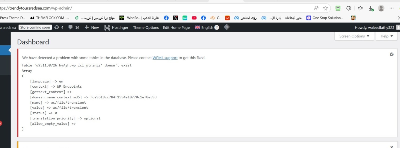

I’m facing a serious issue after activating the WPML Multilingual CMS plugin on my WordPress website, hosted on Hostinger. After activating the plugin, the front-end of the site completely breaks and shows a 404 – Page Not Found error. The WordPress admin dashboard (/wp-admin) remains accessible, and I can manually deactivate the plugin from there. Several warning and error messages have appeared related to WPML and the database. Error Messages Received: 1. From the WPML dashboard: "There is a problem with the String Translation table in your site. This problem is not causing a problem running the site right now, but can become a critical issue in the future. WPML support team knows how to fix it." 2. Technical error message: "We have detected a problem with some tables in the database. Please contact WPML support to get this fixed." Details: Table 'u951138726_hyAjh.wp_icl_strings' doesn't exist Array ( [language] => en [context] => WP Endpoints [gettext_context] => [domain_name_context_md5] => fca9619cc784f1554a10770c1ef8e59d [name] => wc/file/transient [value] => wc/file/transient [status] => 0 [translation_priority] => optional [allow_empty_value] => ) Website: hidden link
The front-end of the site breaks and shows a 404 – Page Not Found error after activating WPML. Error messages indicate a missing wp_icl_strings table.
How can I fix the missing wp_icl_strings table issue?
Is there a way to prevent the front-end from breaking after activating WPML?

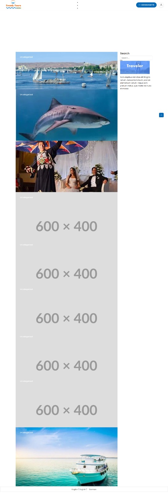

However, after the reset, the website’s design and theme layout have been completely destroyed. The homepage looks broken, the footer is missing, and the overall structure is no longer the same. It’s clear that the theme styling has been heavily affected.
This issue did not exist before the WPML reset — the site’s layout was intact, even when WPML was throwing database-related errors. Now, after following the suggested fix, the front-end is visually broken and unusable.
Please see the attached screenshot of the homepage for reference.
This is a live website, and restoring the visual integrity is urgent.
Kindly review and advise on how to resolve this as soon as possible.

I deactivated WPML completely and the layout issue that you have mentioned is still there. So even when WPML is not active, the issue is there.
Also please consider that WPML does not have anything to do with the layout of the website, specifically on the default language.
I am not sure what might be the problem cause but resetting WPML does not have anything to do with the layout of the website.

However, one issue still remains. In the WordPress dashboard, I still see the following error messag
What I have tried so far:
From WPML → Support → Troubleshooting, I used the option to recreate String Translation tables.
I deactivated and reinstalled the WPML String Translation plugin.
Unfortunately, the message is still showing.
Could you please advise on the next step to completely fix this issue?

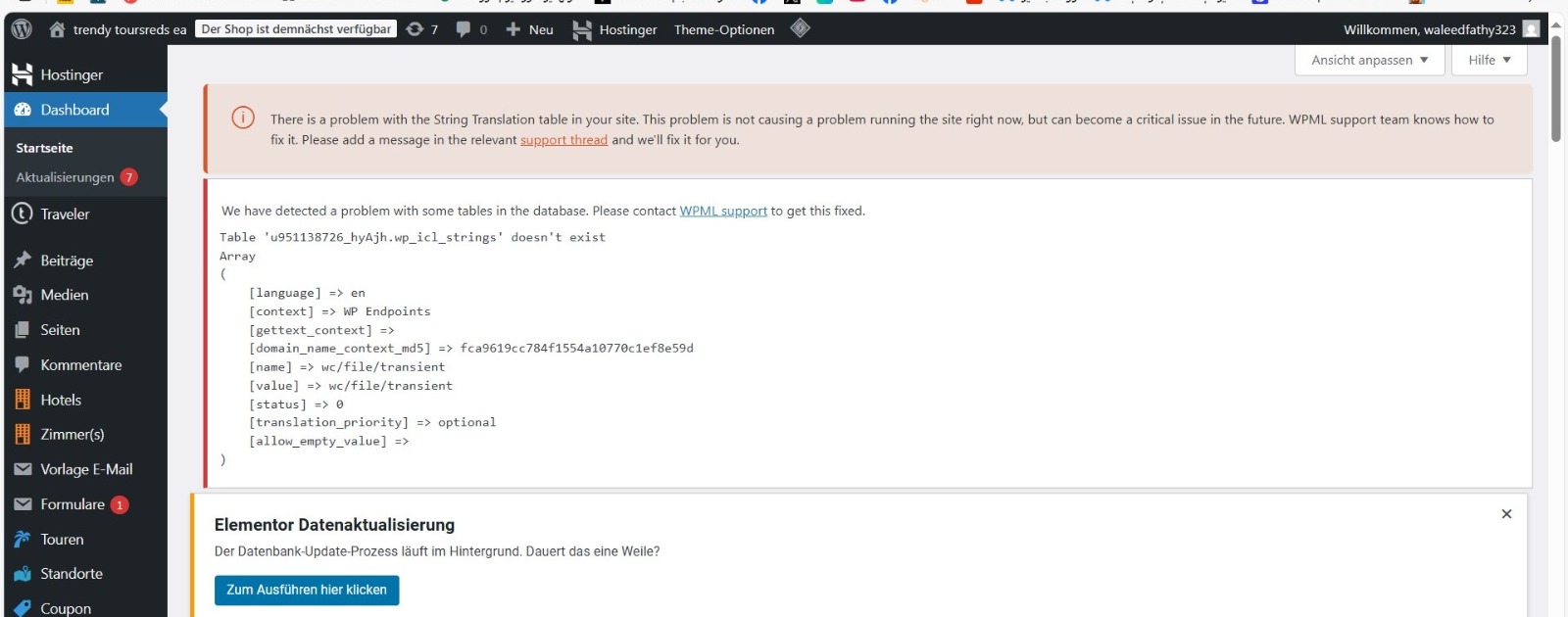

August 18, 2025 at 1:12 pm #17328015
mohabM-4
see this image
