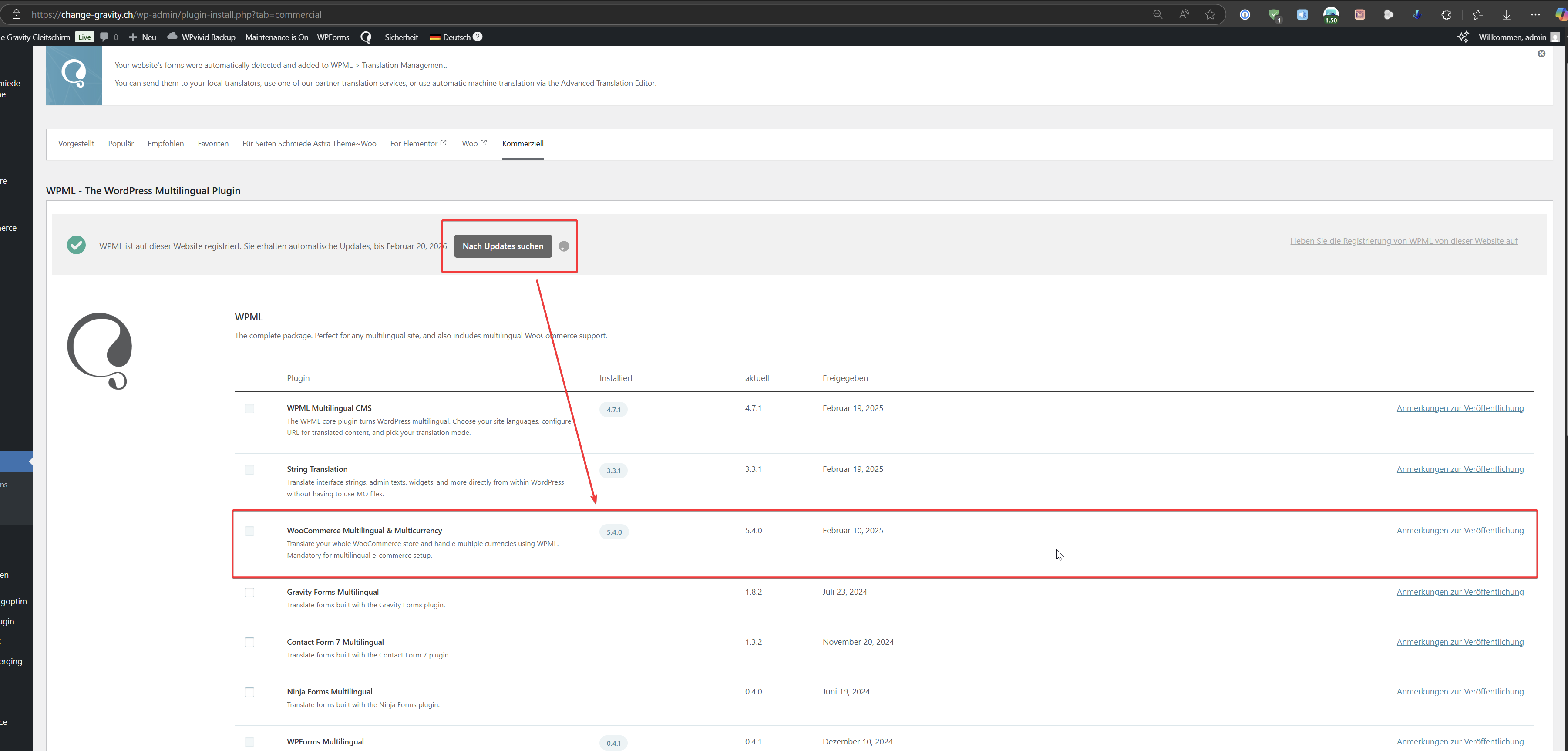

During the creation of this ticket it suggested to update "WooCommerce Multilingual & Multicurrency" from 5.4.0 to 5.4.1 but as you can see in the screenshot this is not possible.
Additionally the missing sites are not WooCommerce sites therefore I suspect that this will not solve the issue.

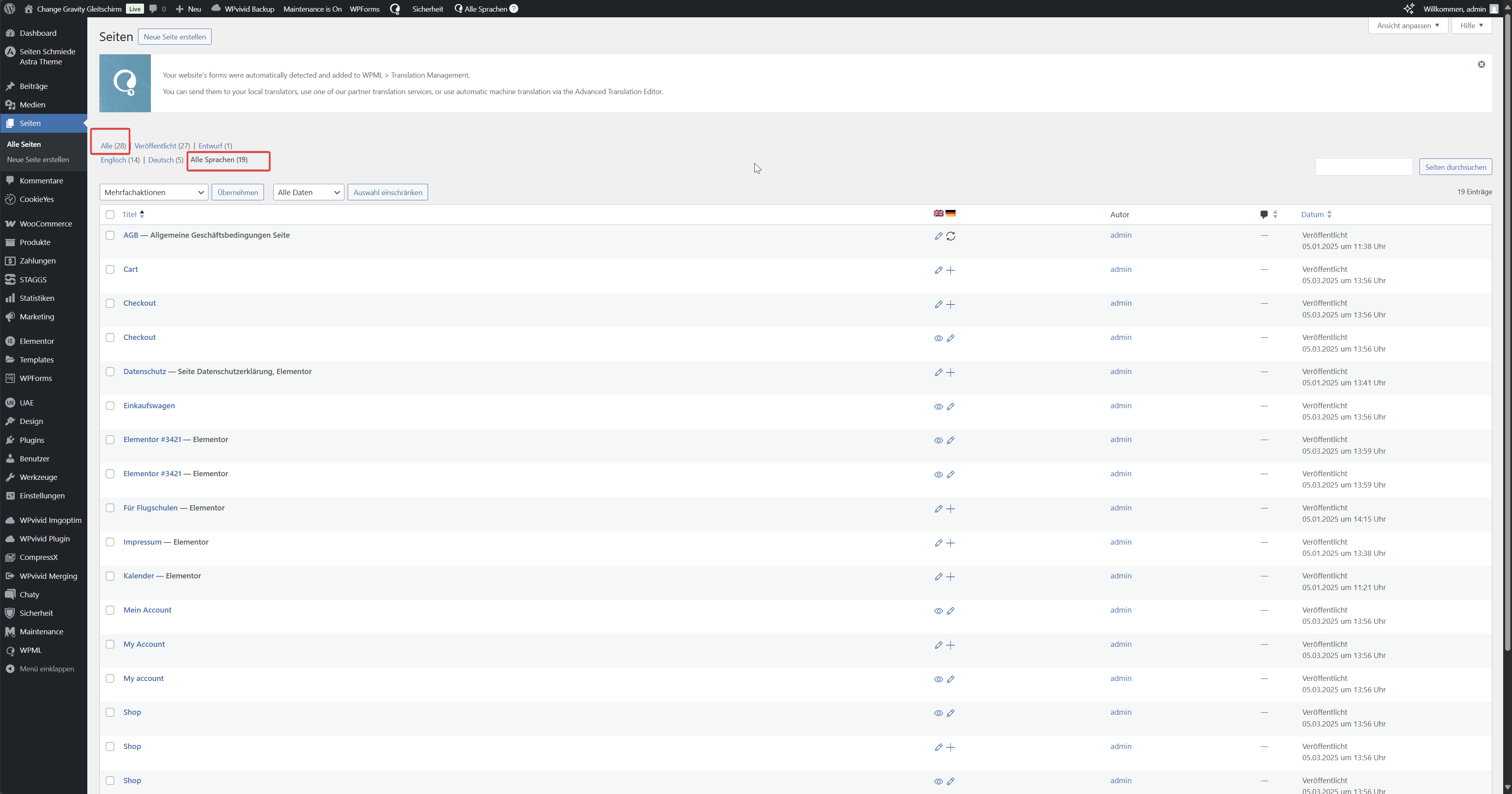

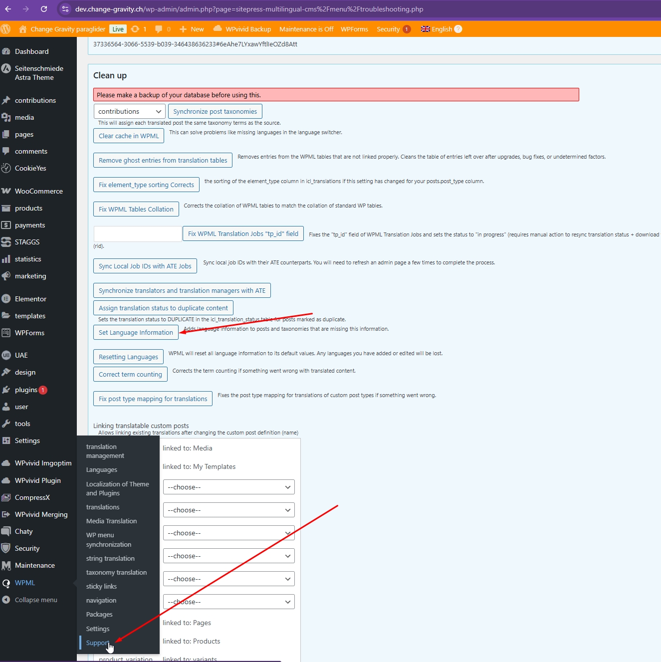

I ran the troubleshooting option in WPML > Support > Troubleshooting > "Set Language Information" and it seems to fix it now. Could you check? Also, I've included a screenshot for our reference.

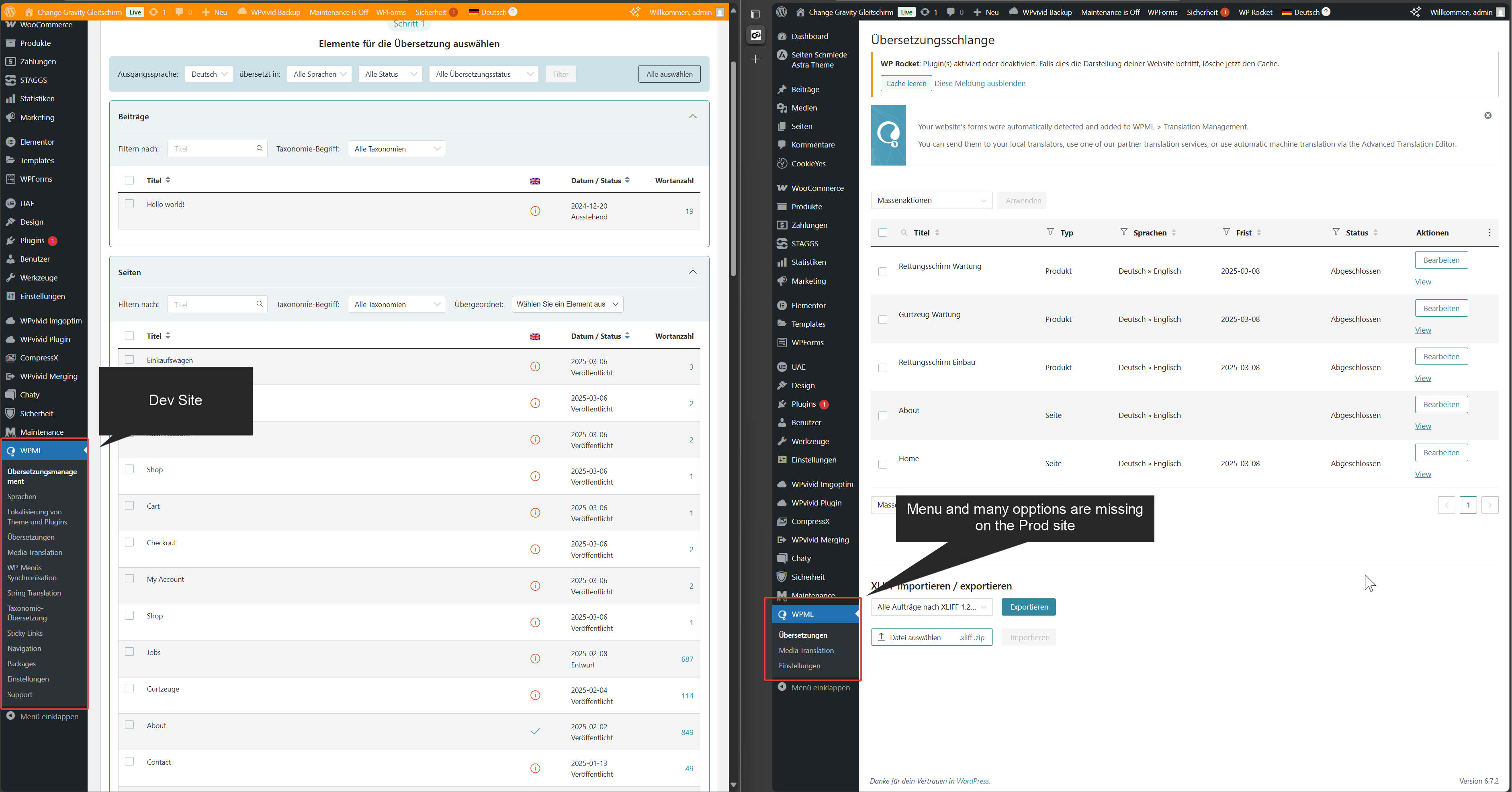

I pushed the changes from Dev to Prod and somehow I am missing the full functionality on Prod Site see screenshot.
March 7, 2025 at 12:58 am #16785818
WPML Supporter since 08/2022
Thanks for your reply.
Could you please backup and run the reset options by placing the code below into your theme's functions.php file?
// THIS performs a reset on icl capabilities (run once in  functions.php ):
// TO BE USED WHEN SOME WPML MENU IS NOT PRESENT OR AUTHORIZATION IS REQUIRED
function wpmlsupp_1706_reset_wpml_capabilities() {
    if ( function_exists( 'icl_enable_capabilities' ) ) {
        icl_enable_capabilities();
add_action( 'shutdown', 'wpmlsupp_1706_reset_wpml_capabilities' );
Then, let me know if the issue is fixed.

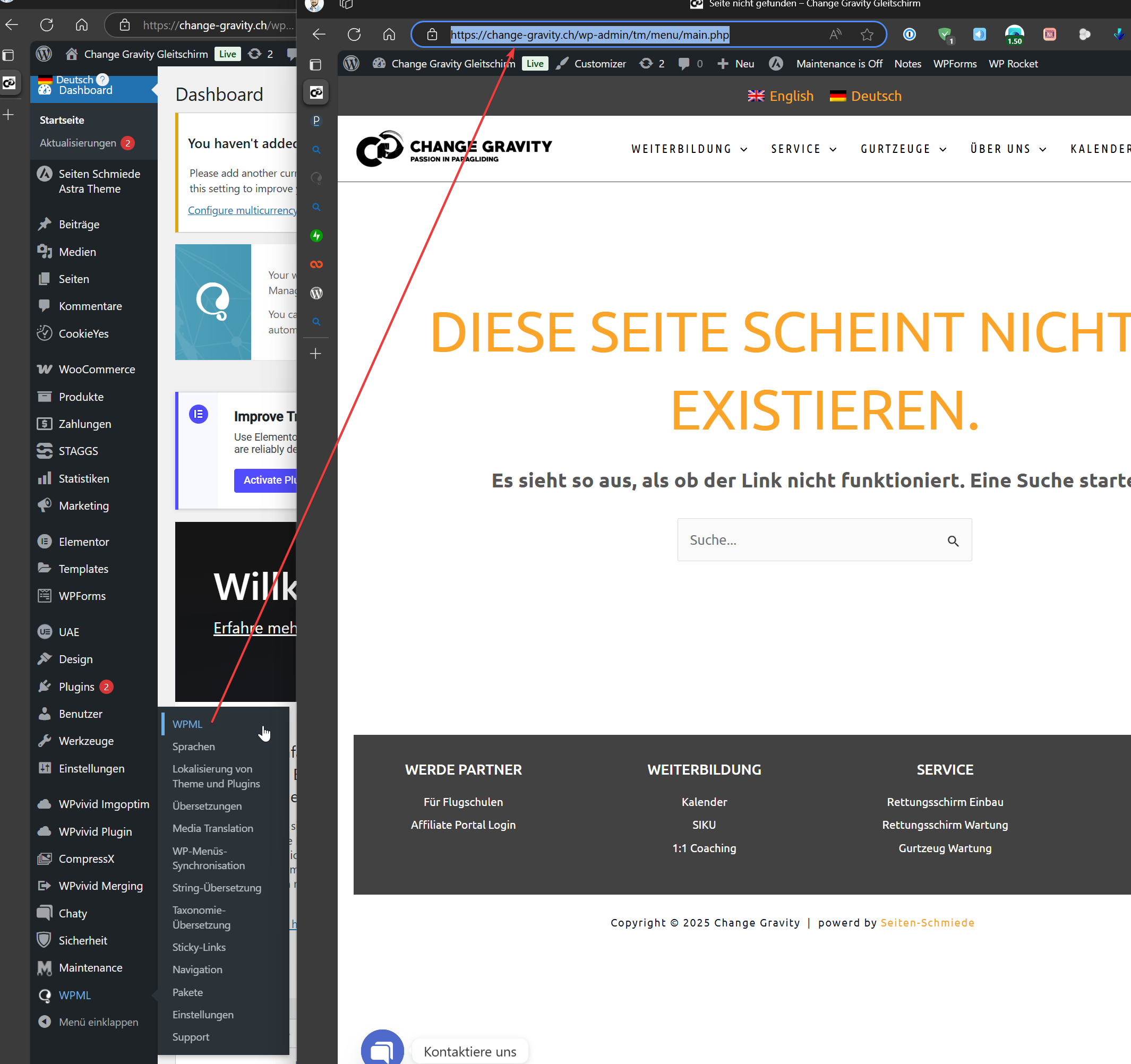

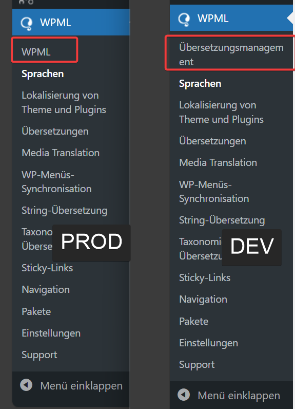

March 7, 2025 at 8:07 am #16786415
stephanR-21
Hello Kor
This partially fixed the problem.
Now the “translation management” on prod is missing, it shows the label wpml, and when I click on it or the blue colored WPML main button, it links to a non-existent page.
What can I do to fix this?

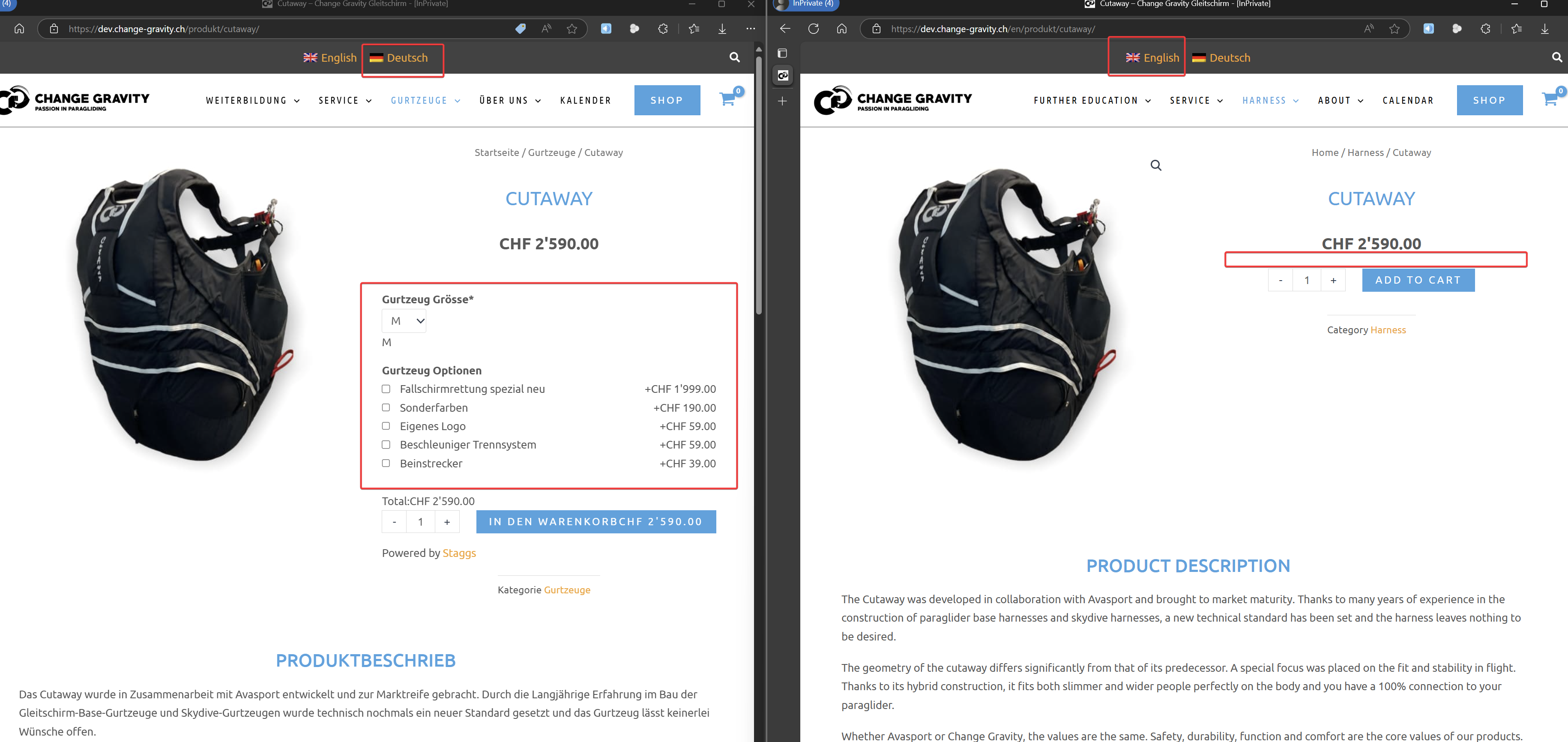

Once you have access and are logged in, could you please check an issue with Translated Product Options? I am using STAGGS options on the products in the shop, but they are not being displayed in English. I reviewed the STAGGS documentation (hidden link), which states that it works with WPML. However, despite trying all the settings in WPML I could find, I couldn't resolve the issue.
Could you kindly investigate this as well?

As for the issue with the Translated Product Options not showing on the translated page, I've split the ticket here https://wpml.org/forums/topic/translated-product-options-using-staggs-options-not-being-displayed-in-english/ so that we could follow up.

Thanks for your patience. This is fixed by applying the code below into your theme's functions.php file. Then, I visited the frontend to trigger the code. I've removed the code afterwards. You can now access to the translation management dashboard here hidden link
function add_wpml_manage_translations_cap() {
    $role = get_role('administrator');
    if ($role) {
        $role->add_cap('manage_translations');
add_action('init', 'add_wpml_manage_translations_cap');
