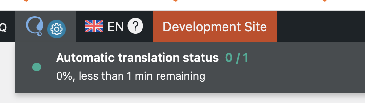

1. I experience problems with speed across the staging, but mainly the homepage and property pages
You can use the current live site (witt.es) as the base to test against. However when WPML is enabled it goes from 1-3 seconds to load --> 30-50 secs.
My thinking is that it might be stuck in translation or maybe it's this:
- On the WPML String Translation plugin there are two files that take time to old and then get cancelled (refer to the attachment). Although i can see it's Cloudflare turnstile which i have installed as plugin, so properly not this.

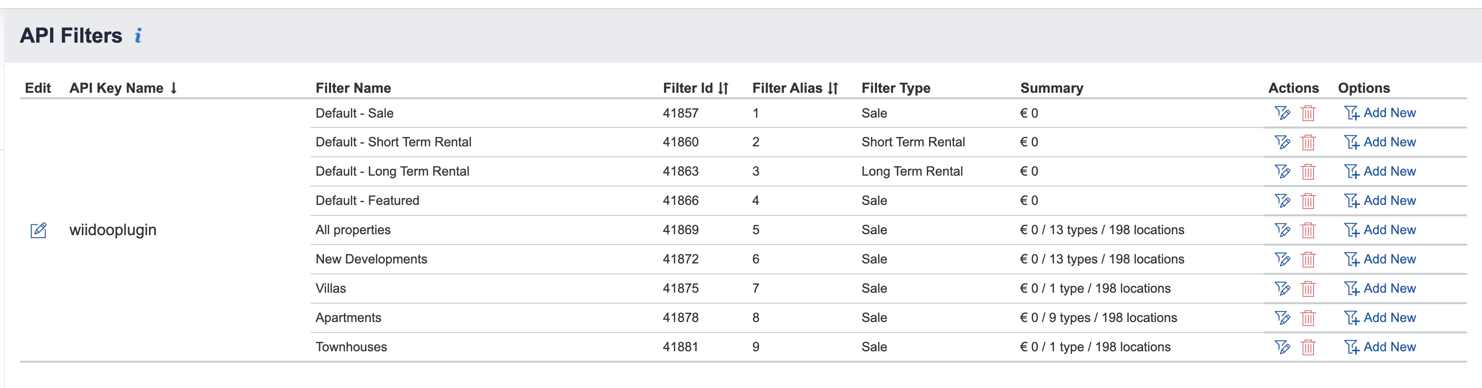

2. WPML is not translating property pages and individual property pages
- The site also uses an API from Resales Online, which is done by this WP plugin (that has been used 100s of times and with WPML with no issues by other freelancers and agencies)
This can be seen on the "All properties" page and the similar pages which differ in the selected filters (New Developments, Villas, Apartments, and Townhouses). The design all comes from the same Template on WP.
Then all properties have a property details page (you can replicate this by pressing on any properties)
hidden link (however you can't see anything on this site)
*Note homepage also have a searchbar from same plugin, which would also needed to be translated. It's slightly different from the templated version of the others.

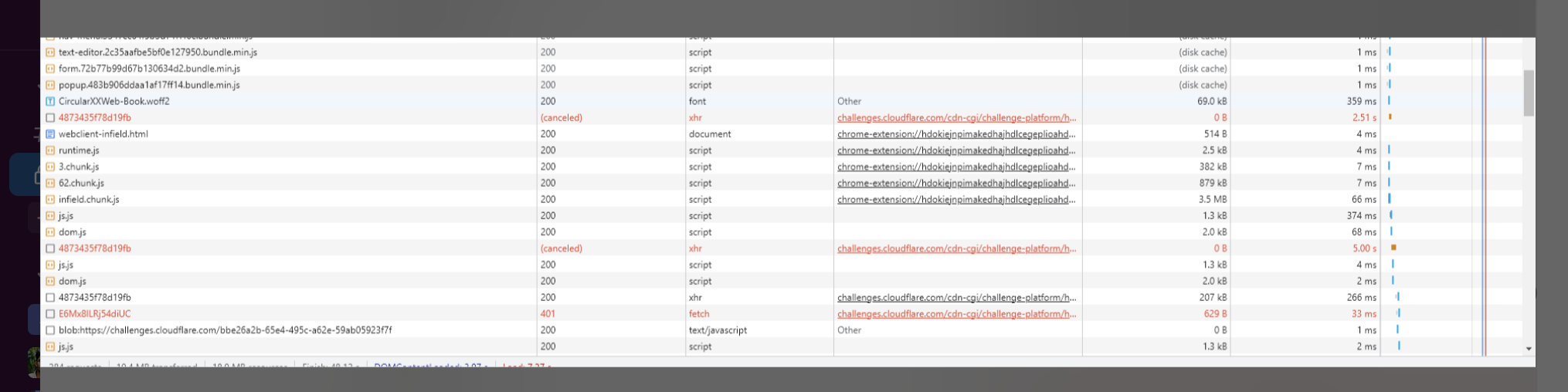

"The loading time increases only when logged in, the website is perfectly fine when logged out
the issue only happens on the frontend, not backend
it's not Redis Object Cache or the String Locator plugin (they were the main suspects)
I have also checked your WPML settings and version, all looks standard, so the next best thing is to turn each plugin off one by one and see which one will make a difference.
I'd also want to have a look at the database size, WPML table sizes and the number of entries to see if there's anything suspicious.
One more thing I tried was deactivating WPML to see how many MB will the Query monitor show, but as you have some custom PHP code, it doesn't work without the main WPML plugin.
But - I realised that the problem is caused by the WPML String Translation plugin. Once you deactivate that, the website is fast enough.
Without the String Translation plugin, the language switcher in the header didn't appear (which is strange) - is it customised?
Perhaps the custom PHP is not optimised and causes the load time increase? (although the Query monitor doesn't show any queries that take too long, but maybe there's just too many).
Also - the homepage shows around 40MB of data loaded, but the actual size is around 10MB - something is duplicating the size of everything.
Let me know if you want me to dig further"

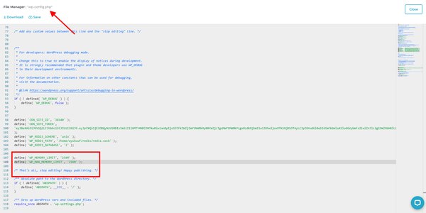

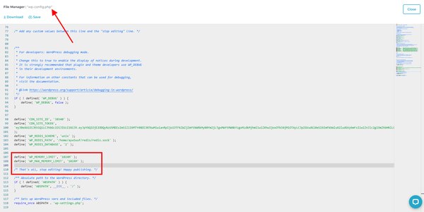

The debug info you have attached shows that your server WP Memory Limit is set to 40M. Our recommendations are to have the following as minimal requirements:
- PHP 5.6 and above (this is OK with your installation) with a WP Memory Limit of at least 128MB while 256MB is recommended.
MySQL 5.6 and above (this is OK with your installation).
Please follow this link for detailed documentation:
Is it possible for you to change those to the minimum requirement?
You may need to contact your hosting provider for that. Meeting those baseline requirements is most critical before debugging and sometimes solves issues you experience - performance issues. The most important thing is to raise the WP Memory Limit. Please try to raise it before you contact your hosting company. You can do it from the wp-config.php file in your WordPress installation. Insert this code in that file:
/** Memory Limit */
define( 'WP_MAX_MEMORY_LIMIT', '256M' );
Add it before this line:
Could you please perform that procedure and see if it helps?
June 28, 2023 at 6:33 pm #13913105
tobberW
I got my hosting provider Rocket.net to raise the WP Memory Limit to 256MB as requested. However, it didn't help. We also tried with 1024MB, which didn't help either. So I switched it back to 256. Hosting, recommended 1024MB, do you aswell?
I have attached the screenshots of the inserted code.

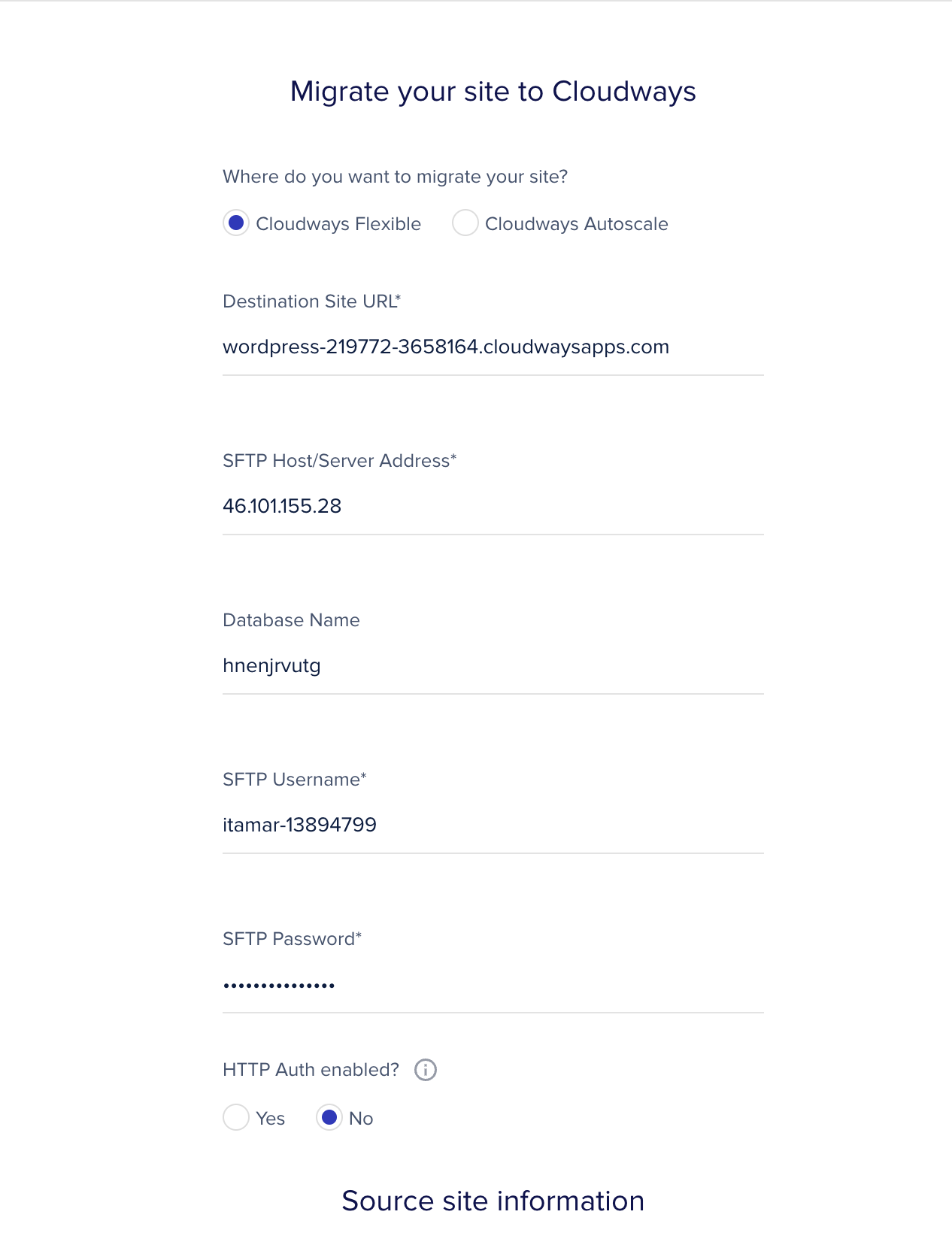

Sure, please migrate your site to our Cloudways server. The process is quite easy. Please see all the details in the next private reply.
June 29, 2023 at 3:17 pm #13919215
tobberW
Thanks.

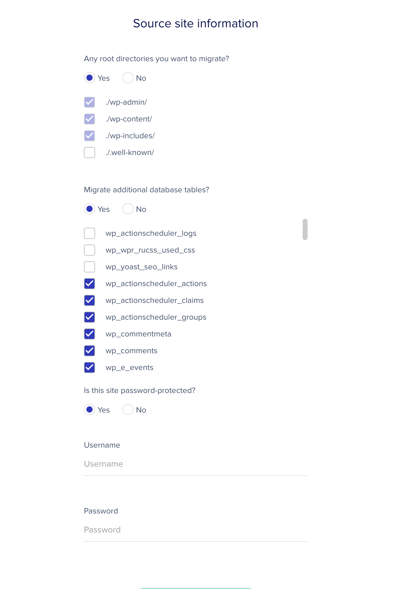

Have tried doing the migration, but it seems there are more fields than what you provided.
In order for me to do the migration correctly.
- You mentioned both database name and user (which are the same), should I use both and where do I use database user, if so?
- You also mention a database password, although i don't see any place to include this - unless it's one of the boxes asking for password?
- Could you tell me how I should select the dots below. I have opened all of them for you too see.
I have attached a screenshot below.

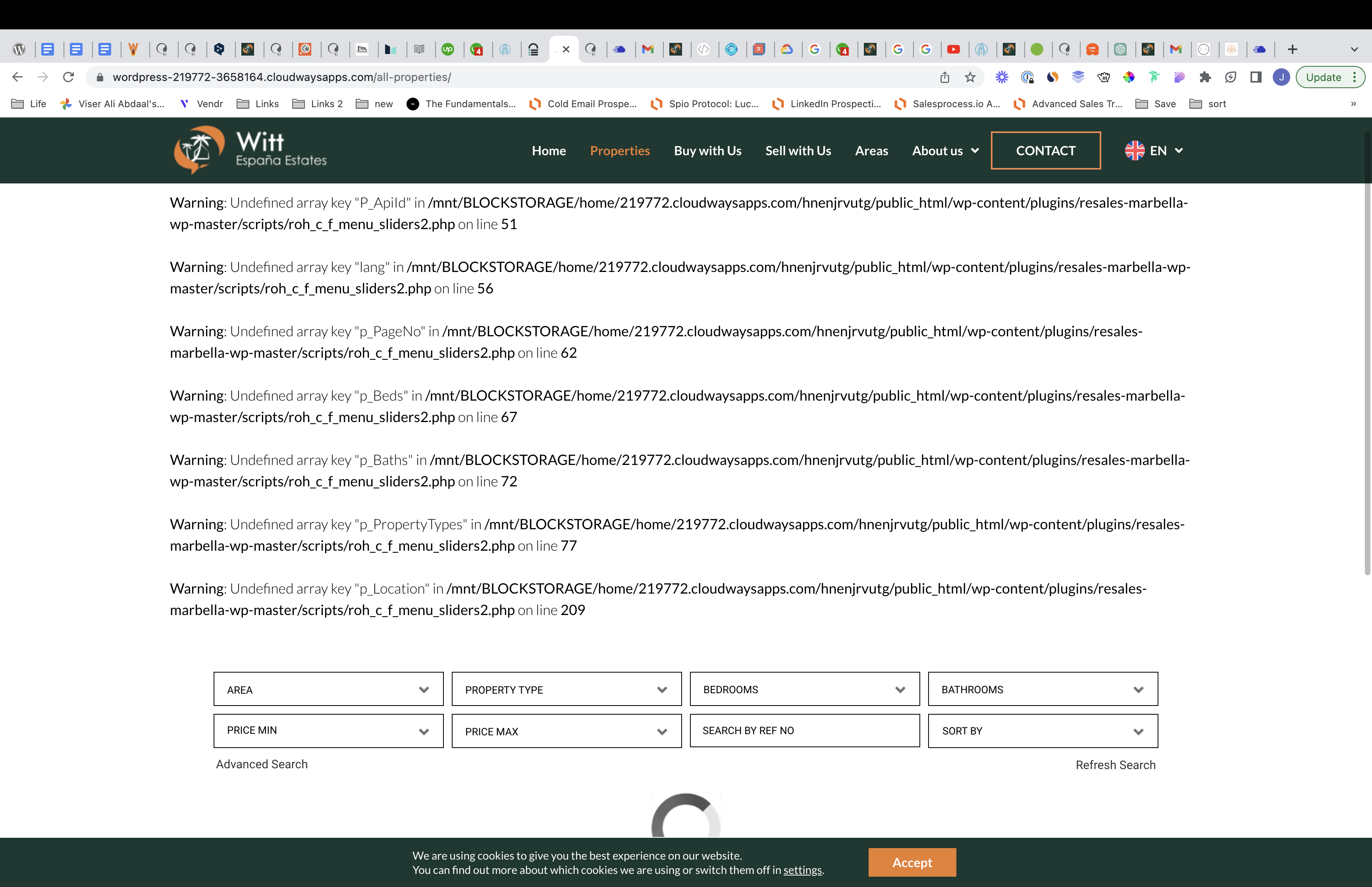

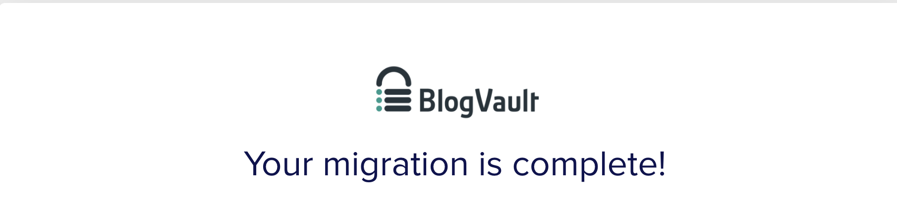

June 29, 2023 at 4:31 pm #13919743
tobberW
#Update
I selected the root directories and additional database tables it had selected as standard and have migrated it now - it's done.
Figured that the database user and password, are just extra information that is listed in your dashboard, as per the guide aswell.
However, after having a look at the migrated site, the property API wp plugin (Resales Online), doesn't work ofcourse, since it has to be pointed to the correct IP address.
And from what i got from a dev friend also looking into it and myself that tried to isolate it, is that the slowness only happens on the pages with property shortcodes (homepage searchbar and properties page). So it's the Widoo plugin.
Since from what I can tell by disabling the others is that the other plugins work fine, it's just that one that is causing conflicts with WPML.
Let me know what you find and if this is the case, what we should do to fix it.

June 29, 2023 at 6:04 pm #13920087
Itamar
WPML Supporter since 02/2016
Hi, and thanks for sharing your findings with us.
The Wiidoo Resales WP Plugin Premium is unknown to us.
It is not officially compatible with WPML and missing from the list here.
https://wpml.org/plugin/?wpv_view_count=120064&wpv-plugin-functionality=0&wpv_post_search=Wiidoo&wpv-wpcf-recommendation-flag=&wpv_filter_submit=Search
I've also searched our internal records and found no report about this plugin. So it may very well be that we are facing a compatibility issue that is causing the performance issue on your site.

Regarding the matter of installing the plugin, I am not sure if I am able to do this, since Widoo themselves installed and configured the API settings - due to many having copied the plugin.
Unless it's possible to take the plugin which is in the WPIDE plugin now (where it was customized from) from the staging and somehow migrate it?
So maybe it's easier if I just give you access to staging, and then you can debug it from there?
Let me know your thoughts.

- The searchbar on homepage doesn't work - then it worked and now it doesn't work agian, and when you try and click on any properties nothing happens. However, when I add (?-no-cache), it seems to work. But then the arrows on the single property view are bugging.
The last time this happened when making design chances, i think clearing the cache helped.
But if I remember correctly it might have been due to a complication with WProcket plugin (although not sure)
You can try and replicate the issue yourself here:
- This is probably related to another ticket, but without String Translation, on the examples i showed you above, could it still be translated? and can you see of those sites use it.
