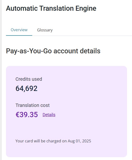

I've refunded 8,248 credits consumed so far (72,940 - 64,692). Now credits show 64,692 (as you told earlier before starting translation).

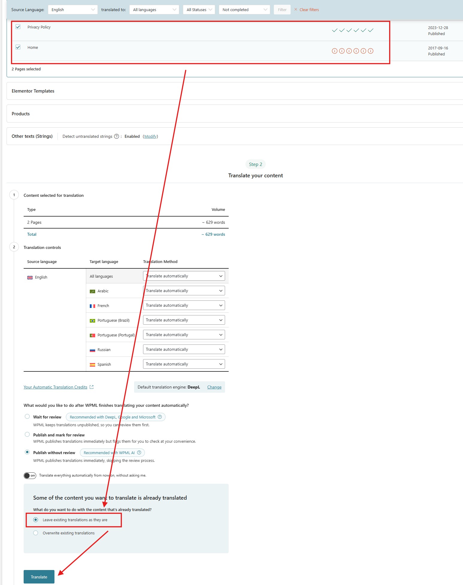

Next please follow the exact steps, so your credits are not consumed and you get that "Leave existing translations as they are" option:
- Go to WPML -> Translation Management Dashboard.
- Select one of the pages which show translated already (like there's a green tick mark under flags, as shown in the attached screenshot).
- And then select the pages which need translation and showing small red i in circle (as shown in the same screenshot).
- Then select to translate automatically.
- Then select "Leave existing translations as they are".
- Then click "Translate" button.
This way no additional credits should be consumed.
I've also recorded my screen to show about how to select the content, please watch hidden link.
