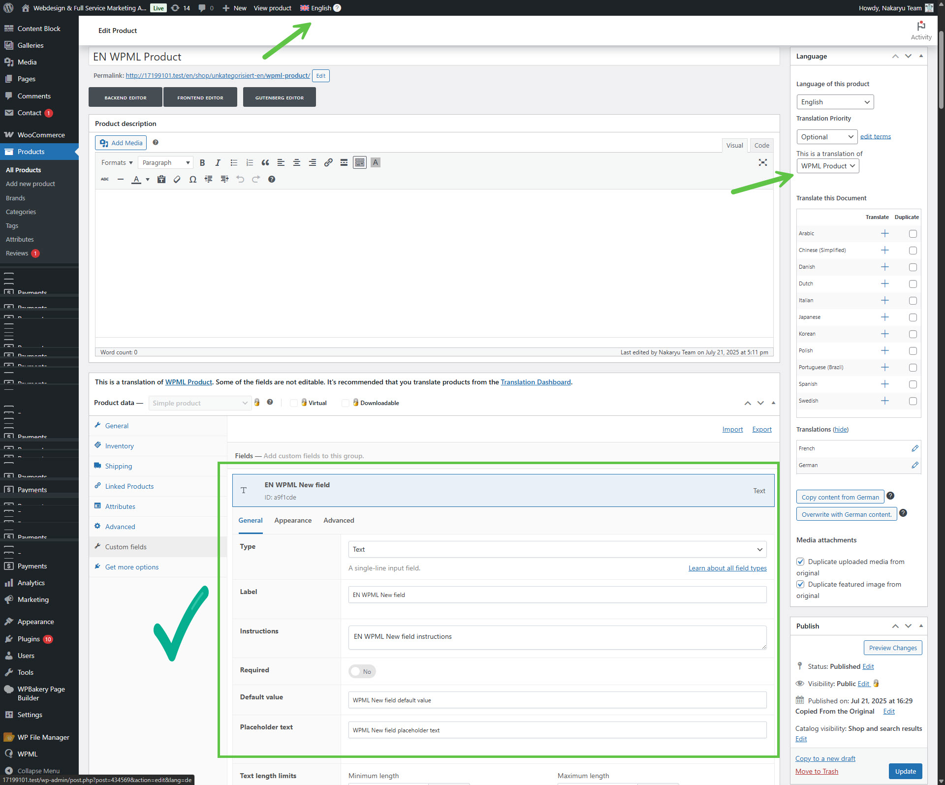

Thanks for your instructions. I tested this issue on a copy of your site on my local server.
By following the manual translation method described in the following link, I was able to translate the fields.
Please see the attached screenshot.
This method requires first duplicating the product into the secondary language and then translating it independently.
However, the fields are not showing on the translated product on the front end.
Does this problem also occur on your site?
Itamar.

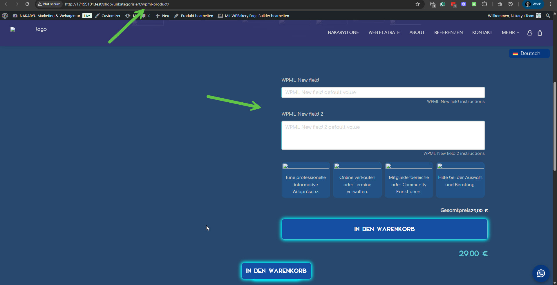

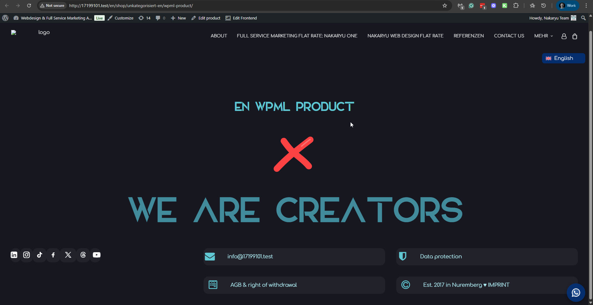

I didn't translate the product automatically. I manually translated it.
The point I was trying to stress is that the fields I created on the test product were showing in German. Please see the attached screenshot german-ok.jpg. But not in English. Please see the attached screenshot en-no-fields.jpg. So I'm asking you if that is what also happens on your site?
