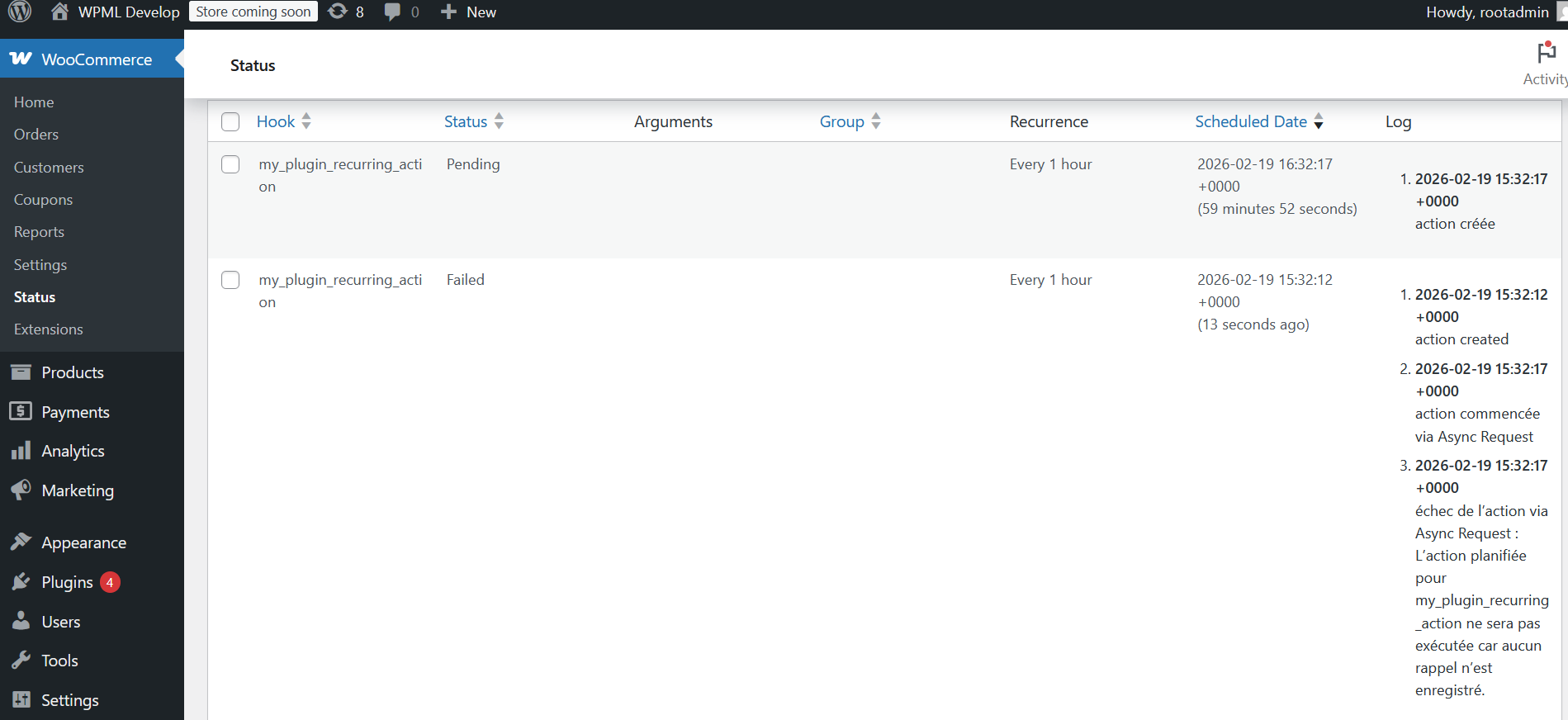

I noticed that some admin text (e.g. “action created”) has been translated, and that the translations appears to be randomly displayed. See attached screen shot made from the English language. Are you sure this is not causing an issue?
There is no reason to translate all this admin texts. How can we have this fixed?

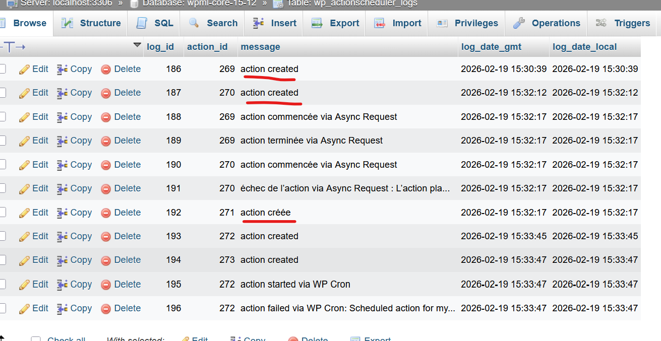

About the “action created” string being translated<br>
This happens because Action Scheduler localizes this string and then stores it directly in the database. On subsequent loads, the value is fetched from the database and displayed as-is.
I can even reproduce this behavior without WPML:
1. I disabled WPML.
2. I created a new admin user with the profile language set to French.
3. I registered an action using Action Scheduler, and the “action created” string was saved in French.
4. Then I logged in as another admin with the profile language set to English, but the “action created” string was still shown in French.
5. Please see the attached screenshots 17838030-Screenshot_2026_02_20.png showing the same behavior with WPML disabled.
This is exactly what is happening on your site. Multiple users or front-end calls in different languages cause the “action created” string to be saved in the current language. Once stored in the database, it is reused and displayed, regardless of the user language.
At this point, I’m not sure what we can do from the WPML side to prevent this. If WooCommerce stops localizing this string before saving it, the text would always remain in English. This appears to be mainly an Action Scheduler logic issue.
